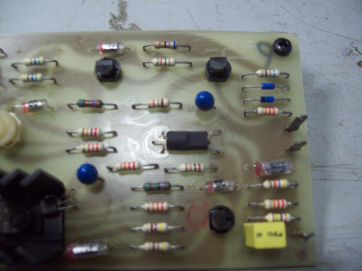

according to this schematic that looks exactly like my amplifier http://www.acoustica.org.uk/t/naim/poweramp_pix/NAP250 schematic.jpg
i found the input capacitor to be of 470pf which seems to me quiet high for 22K
then again in the VI limiter area the two base resistors that will be R9-8 should be 47R and both the same .. actually the P side resistor is 100 R and the N side resistor is 47 ... That will result that in a limit condition P side will be limited more than N side any reason for that ???
now that is odd and any way the VI limmiter is completely removed but any comments on that could be usable to listen .
Keep in mind that eventhough amplifier looks repaired before the specific resistors looked mammy since we all know very well that in blown amps normally VI limmiters survive .
Kind regards sakis

Hi Sakis.
In the schematic the input capacitor is 330pF (?)
Are you going to retain the the value of the TR1 collector resistor (=1000 Ohm)? This leg passes more than twice the current of the TR2 leg.
Also, most DIYers have not included the VI limiter.
Regards

correct in the schematic the capacitor is 330pf and looks quiet reasonable but in my amplifier is 470 pf and also looks mammy made
i am working as we speak
i allready used closelly matched BC 546 and thermally coupled as seen in the pictures ... just a few minutes ago measured ofset and that will be 9mv for left amplifier and 5 mv for right amplifier
( of course that happend after i tuned rails regulators to 40.1+40.1 volts since they had a diference of almost 1.5 volts )
i will look at the resistor issue and let you know
more to come in a while
kind regards sakis

amp is up for about 30 minutes and ofset remains stable
though after half an hour amplifier is not warm at all ( temp in the shop is 22 due to heavy airconditioning ) so i suspect underbias i will see that also and proceed with the rest ....
