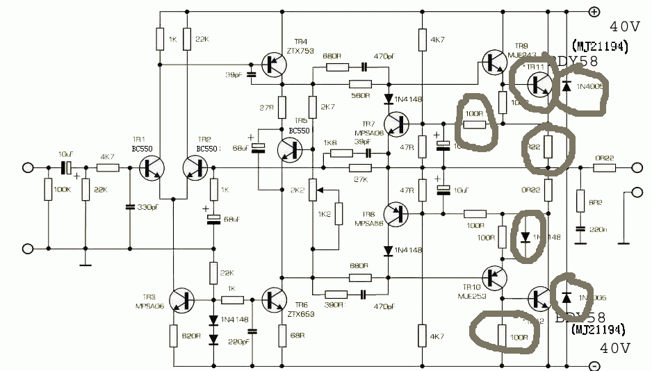

Finally I've replaced some parts: power transistors (cheap ones for the moment), driver transistors, burned resistors, some diodes (these parts have a yellow dot in the pic).
Switched on and no smoke, all seems fine.
But I still have 30v from speakers sockets.
Bias is 3,9mv across both emitter resistors.
The others transistors seems fine.
Help.
Help.
You haven't identified what these resistors are but guessing from the fuzzy PCB traces showing in your pic, the burned resistors were ...
These were the failed parts. Hope this does make sense for you.
Other than these I've also replaced TR9, TR10 and TR12.
Hi. 'Good to know you are still working on the amplifier.
30V on the output says you may have had a further problem, as suggested by sgrossklass in #5. The 200 mV you measured originally was probably only due to leakage current through the burnt transistors. When you replaced them, the original fault reappeared, I suspect.
What polarity is the 30V offset and are the power supply rails about the same +/- 30V with respect to ground?
Are the IN4005 (BFY406) diodes correctly polarized, because if they have blown again,
someone must have done something very wrong, like putting mains power on the speaker leads to melt the terminals and blow the amplifier in the first instance - or so it seems? The diodes are not actually part of the circuit - just there to remove transient voltage spikes.
Let's also check the voltage amplifier to see if it's OK. Measure the collector voltages of TR4,6 and then the base voltages of TR9,10 in both channels for comparison. Note all measurements with no connections other than mains power.
Hi Ian,
offset polarity is negative. PS rails are +33 and -33.
Collector voltages of TR4-6 are -32,7 in the failed channel and +1,2/-1,2 in the working channel.
Base voltages of TR9-10 are -32,5 in the failed channel and +1,2/-1,2 in the working channell.
Thanks for the measurements. It seems that TR4 is not functional but TR6 may still be OK. You will not find these parts (ZTX653/753 or similar) so easy to find though they are still manufactured by Diodes Inc. I had assumed Vbe measurements had been taken and were OK at the input end of the amplifier but seeing your meter does not give reliable results you should recheck all measurements now, and whenever there is time to repeat the test. Don't forget to include TR7,8.
All the measurement confirmed.
TR7-8 have voltage collector: -6,90 and -30 in the failed channell; 1 and 0,4 in the working channell; VBE 0,45 and 0,96 in the failed channell; 0,22 and 0,82 in the working channell.
Others VBE are fine but TR4 has 0v?
ps. TR4-6 are ZTX752-652 even harder to find, may I replace them with ZTX653/753?

Sure, no problem substituting ZTX653/753 - the difference is only max. voltage ratings.
Continue with Vbe measurements of the rest of the small transistors if not all checked yet. Check particularly TR6, the current source for TR4, for an E-C short which may also result in a large offset.
However, TR4 and maybe TR5 usually fail when the output stage fails, so this is not surprising. As transistors are DC coupled, they can fail in a complete chain back to the input transistor, falling like dominos. Consequently, it may seem easier to simply replace all semiconductors but you learn nothing and still may not solve the problem that way. Are you using a lightbulb limiter to protect against further damage?
