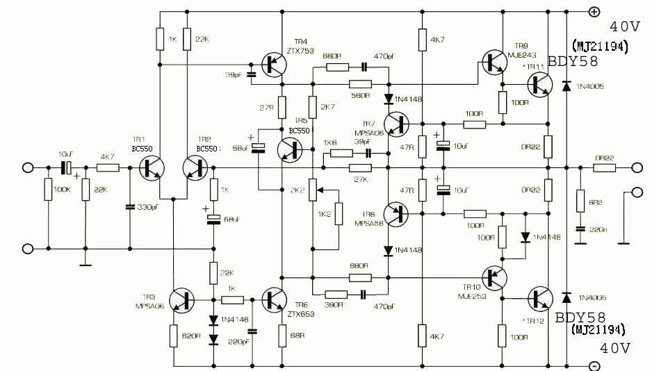

Reportedly the basic circuitry for the NAP 110, 140 and 250 is essentially the same, so a schematic for any of these should do. Pretty standard circuit AFAICS, except for a quasicomp output stage.

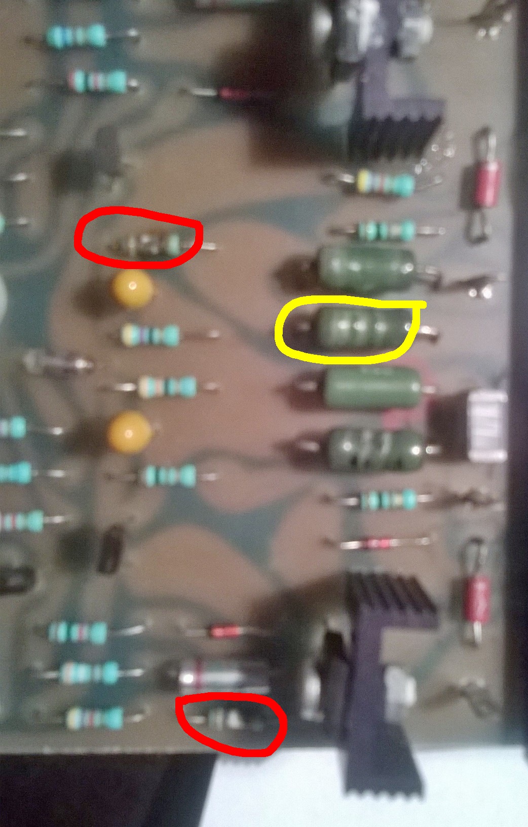

Three dead resistors (two burnt, one shorted).
Transistors seem ok. Would you someone suggest me a proper replacement for the power resistors please? I think I should replace all of them and in both boards.

In the basic standard NAP schematic they are 0R22 but I've measured them with a DMM and I've read 0R5 (?)

2 possibilities:
Is your meter accurate at low resistance values, have good batteries and does it read zero R when probes are shorted?
Do all the 8 WW resistors read the same value? There are actually 4 WW resistors in each channel when the standard
circuit shows just 3 resistors. That's one resistor from each output transistor (emitter on the positive rail side,
collector on the negative rail side) to the output common rail and 2 in parallel from that point to the speaker terminal.
However, NAP 110 is an early model (1979-87)and may have some minor differences. I would not expect the output
resistor to be larger than 0R22 though. Look at the PCB tracks beneath or use some backlight to see what the actual
circuit is.
BTW, There is only one schematic for all early NAP models so you won't find one specifically drawn up for any model,
apart from wiring diagrams for the bridged models - unless another DIY or service technician drew them up.

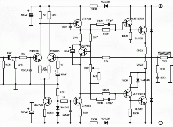

By the added artwork to the standard Naim circuit, I guess that was one of Les Wolstenholme's (Avondale Audio) Naim mod circuits and is close to his NCC200 design. (see below). The original is said to follow the early NAP250 (1975) design but any variations across many models up to the late 1980s were minor. The differences to the NCC200 (still offered for sale) are removing the VI limiter circuit, adding "anti-rail sticking" diode/resistors, output coil and damping resitor, substituted transistors and I imagine, his own degree of parts matching.This circuit may be of help. I found it on the web some time back, therefore I don't know how accurate it is.

When you have replaced the small, burned MF resistors, you could try it like that, as the small WW resistors may be hard to obtain.
Replaced the two burned resistors but one of them burned again when I've switched on 🙁
You haven't identified what these resistors are but guessing from the fuzzy PCB traces showing in your pic, the burned resistors were 100R from each OR22 resistor (not the output resistor) to the bases of TR7,8. i.e. the current sense voltage for the VI limiter circuits. If these are the burnt resistors (please check) it would be unusual if TR7,8 were not also shorted or the 47R resistors or capacitors also damaged. Test Vbe on TR7,8 and also test quiescent current by measuring voltage across either OR22 resistor. You should measure around 6mV or, if the reading is not clear, 12mV across the 2 in series. The output offset voltage (from the output to speaker ground) should be less than 40 mV.
Otherwise, the other 100R resistors from the same point are the driver emitter resistors and that points to problems with the MJE243/253 drivers (on small heatsinks). Test them for shorted C-E and Vbe. ) Voltage between base and emitter is always approx. +/- 0.65V for all bipolar transitors. Always compare voltages with the good channel so others understand what is likely wrong and you gain some clues for troubleshooting.
Note: The part numbers refer to Naim's schematic, similar to the last schematic posted above.

Well, it seems you have trouble everywhere. I guess these faults in the amplifier were there all the time and that's why it was for sale (hopefully very cheap in that condition).
OK, I think from your description that just one side, TR9, TR11(MJE243) are blown. That would make sense and of course, the output offset voltage would have told you that if it was so high. Perhaps you misunderstood what was meant in post #4 or your meter has an intermittent fault/ flat battery.
I think all those parts TR9,10,11,12 should be replaced but this channel will then not match the other. MJE243/253 are not difficult to obtain and you only need 1 each.
The output transistors, TR11,12 may be marked BDY58 as the schematic shows or they could have been replaced earlier with Naim "house code" parts NA001 - neither will be easily or cheaply available. The best substitutes for quality sound will be MJ15003 but BUV20 is now also rated highly. Modifying Naim Audio power amplifiers
You already know what to do about burnt resistors - the smaller types are 500 or 600 mW MF resistors and the diodes are not critical- any 1A rated general purpose rectifier diode with a voltage rating of 200V or greater will be fine, so IN4004 is fine too. Before repairing the damaged channel, you should test the VAS transistors, ZTX653,753. these will cause the output stage to blow if they are damaged too, so take care to measure all transistors, noting that in some places it is not simple to test with certainty unless you remove them. I have found the cheap and basic Ebay transistor testers to work well for checking out small transitors and drivers. They actually identify, show connections and test almost any component you can find - this is just the cheapest example I saw @ ~14 Euros. There are many other versions with better features, connectors etc: LED Backlight Transistor Tester Capacitor ESR Inductance Resistor NPN PNP Mosfet | eBay
I suggest you repair the damaged channel first, listen and think about the sound quality and then consider changing the output transistors in the other channel.
