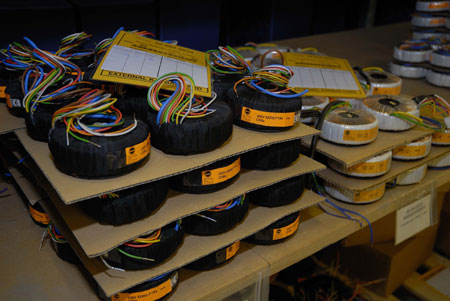

I cannot see how an 800VA transformer can help on a pre-amp
But dressing up a Nuvotem Talema toroidal to look like a Holden & Fisher is rather amusing, No ?

Bonsai said:
However, I cannot se e how an 800VA trasformer can help on a pre-amp,
My own anecdotal tests show that there is a significant audible difference between different transformers and generally bigger is better. However, i believe that in a preamp isolation from mains noise is extremely important and an EI transformer with split bobins is a lot better than a huge toroid. But it doesn't fit in a slim case.
The powersupply case of my preamp holds four 200VA R-cores for the amp stages, and those have 0.2" lower height than an 800VA.
