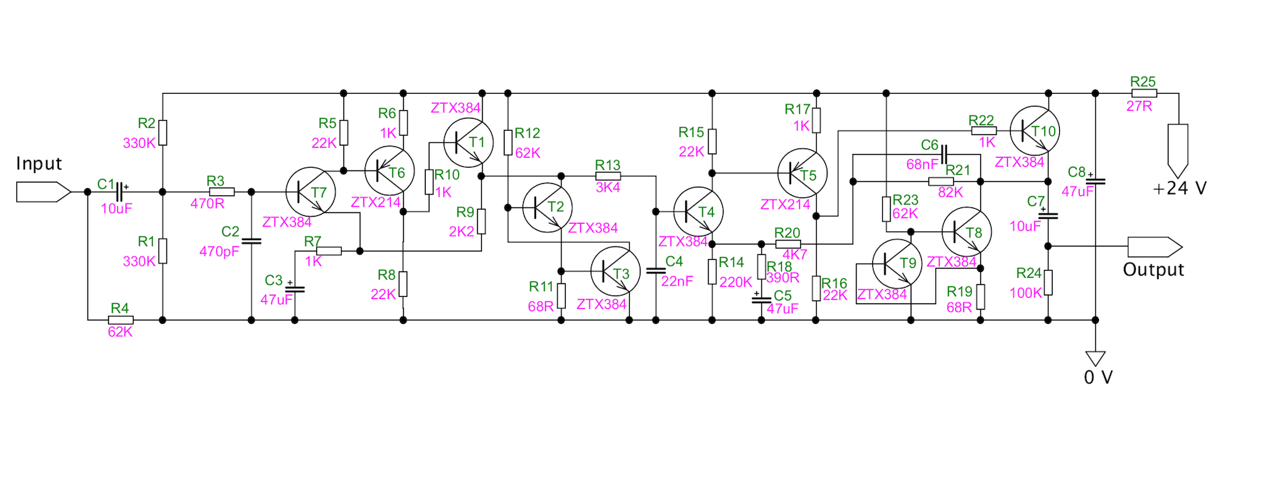

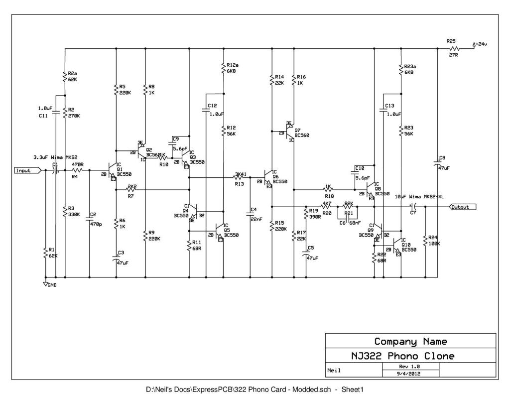

Hi! I have traced the Naim NA322/4 MM phono board PCB layout from some photos that I found online. I didn’t find any schematic, but there were enough pictures and some descriptions so that I could identify the parts.
Anyway I have some questions left:
1. Can anybody tell me if I have identified the transistors correctly? I am not absolutely sure which of the 10 transistors are ZTX384 and which are ZTX214.
It was hard to tell this from the pictures. Unfortunately I don’t understand the circuit enough and don’t have enough background knowledge to really be able to figure this out logically.
2. Is the polarity of the tantalum caps correct?
3. I can use BC560 instead of ZTX214 and BC550 instead of ZTX384, right?
4. Do the transistors have to be matched? And which have to be matched?
Thanks so much in advance!

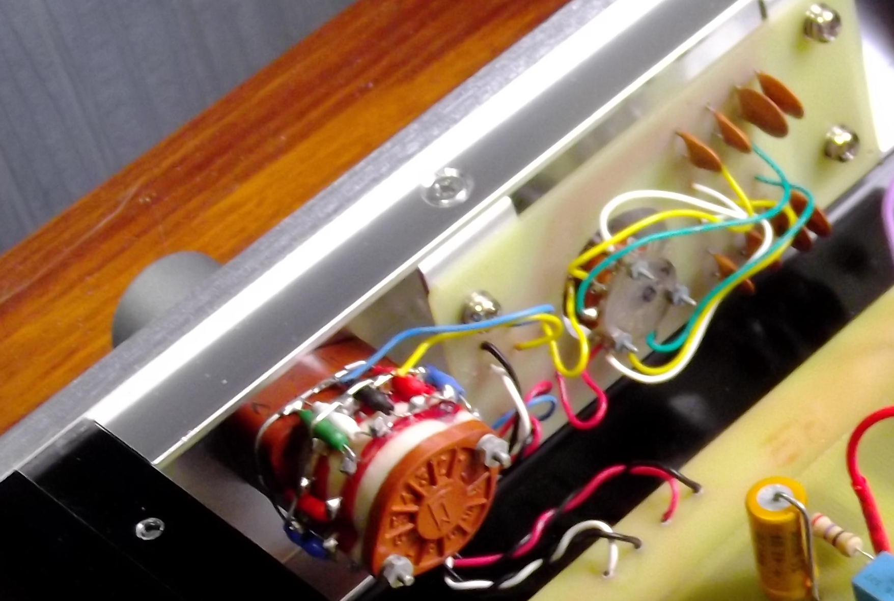

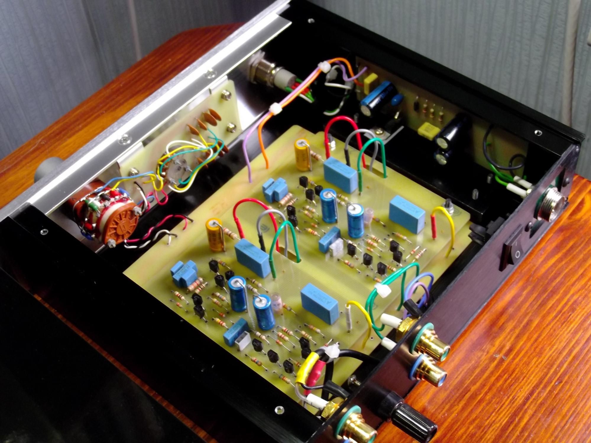

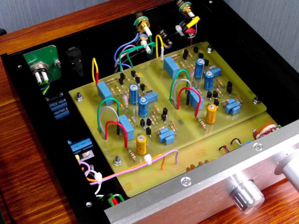

Hello everybody! Almost a year has passed . I changed the design of the preamp . I made a motherboard with star grounding . Made the input capacity switch ( 100, 150, 200, 250 pf ). Made the input resistance switch ( 22k, 33k, 47k , 62k, 75k, 100k). Installed gold-plated pins on the preamp Board . Now the Board is easily removed-if necessary . I still like the sound of that .

is it sufficient enough to just replace the 470pF polystyrene cap? There are any side effectsto be expected by replacing this cap with f.e. 100pF cap?
Hello! I changed the 470 pf capacity on the board to a 100 pf rating . Additional capacity ratings are connected via a switch on the front panel . No negative consequences were identified .Signal paths to the capacitance and resistance setting switches pass through the motherboard .
