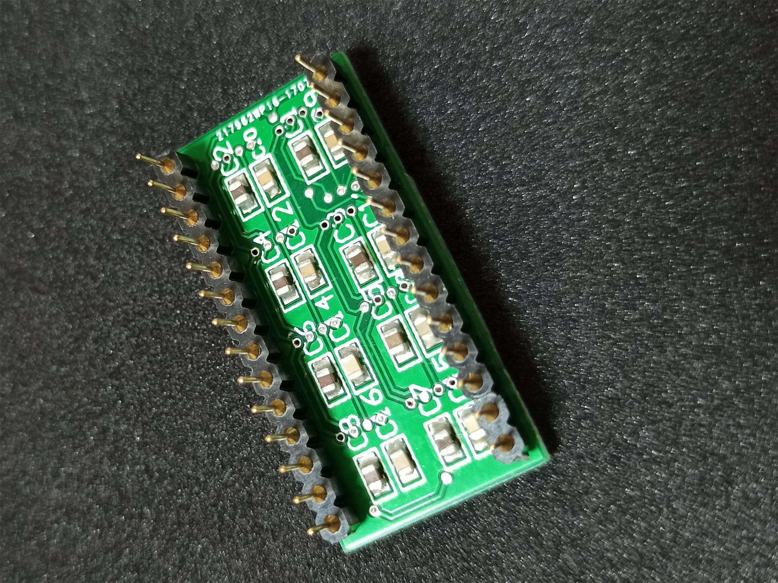

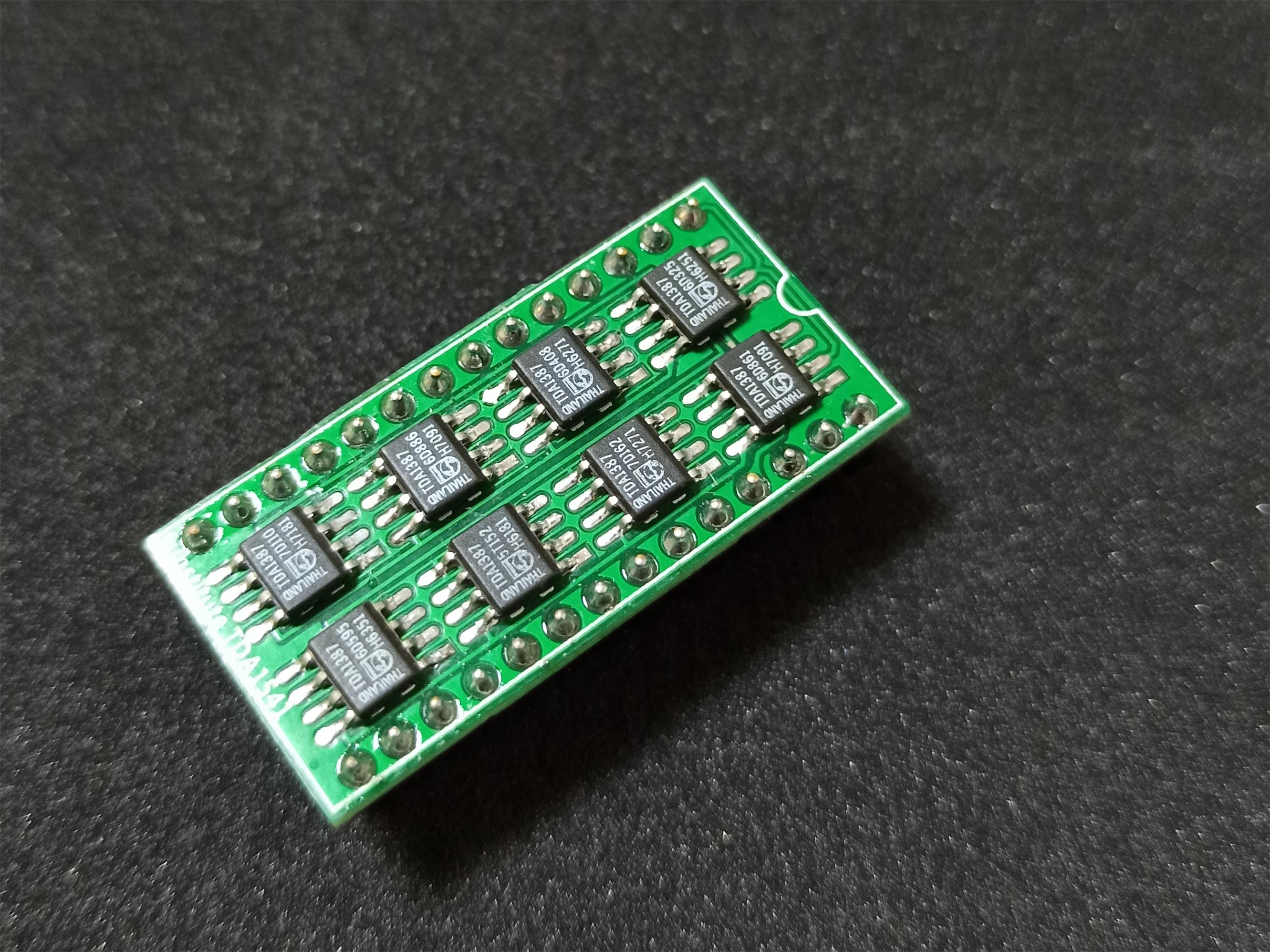

At this stage I'm leaning strongly toward to the possibility of a defected TDA1541A-S1 but just to confirm the hypothesis can be costly. However I've recently discovered that eBay has a "replacement" at just shy of $13 AUD, 8 TDA1387 in parallel as sub for the TDA1541A.
It's on its way as we speak, I will come back with the result ASAP.
(PS: photos are from Ebay)

Yes the replacement indeed looks very interesting. The seller claims it sounds just like the 1541 :tilt: and if it does work then I'll start looking for the S1 crown. They are, however, fairly expensive and eBay is full of fakes.

Sorry for the late update. The substitutes got delayed due to the current pandemic and I got myself involved into some other tasks. Anyway I swapped them over and...nothing changed. Still no sound. The CD spins and time advances but the decoding part is dead as a rock.
