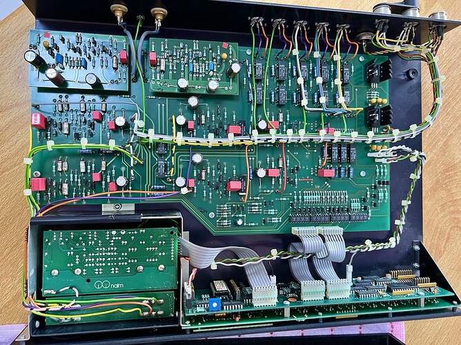

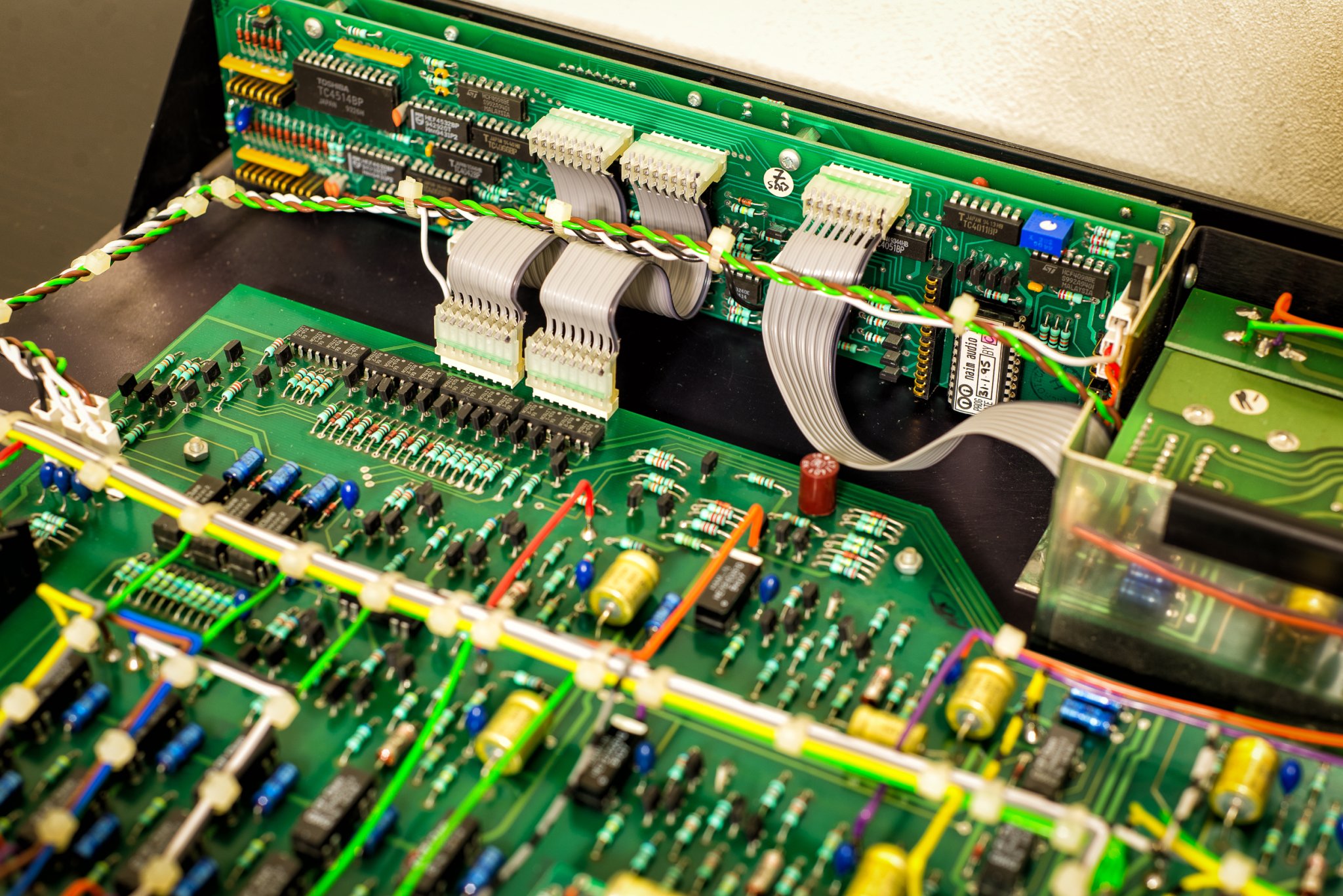

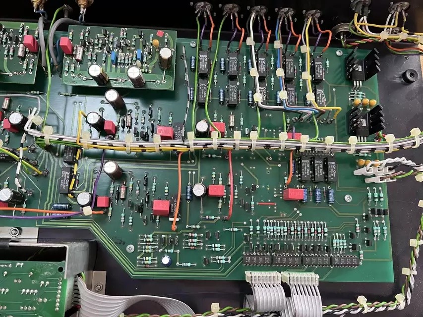

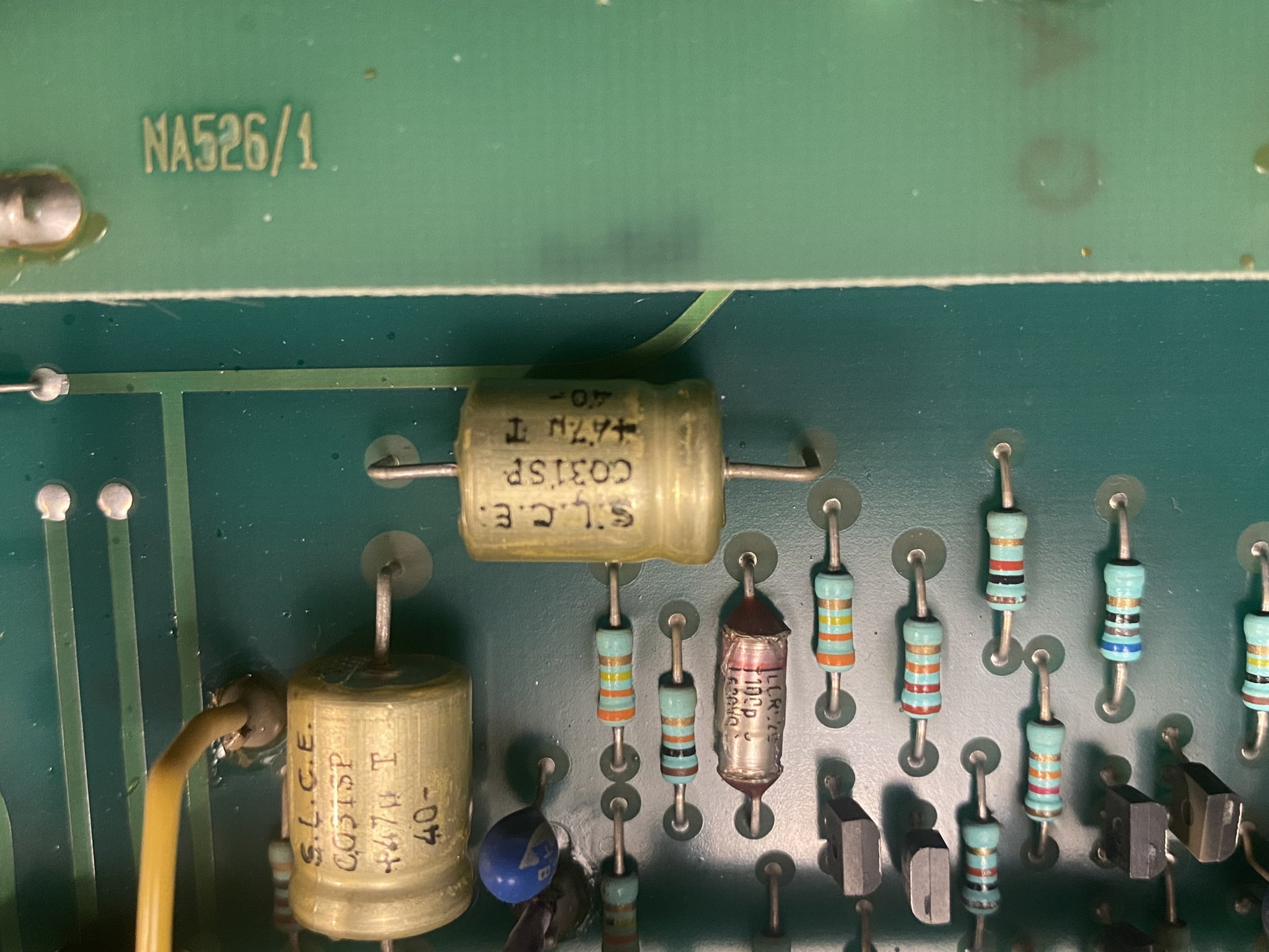

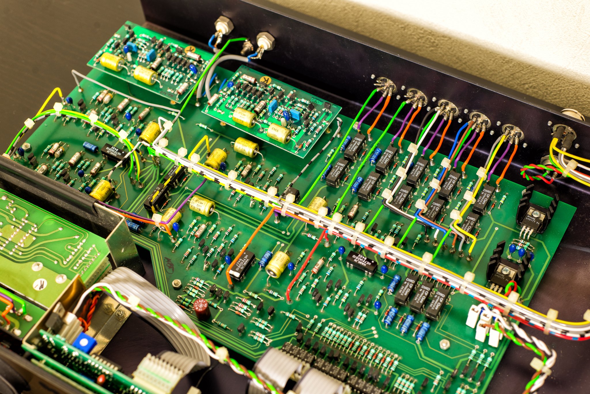

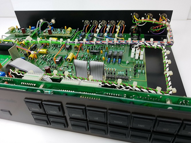

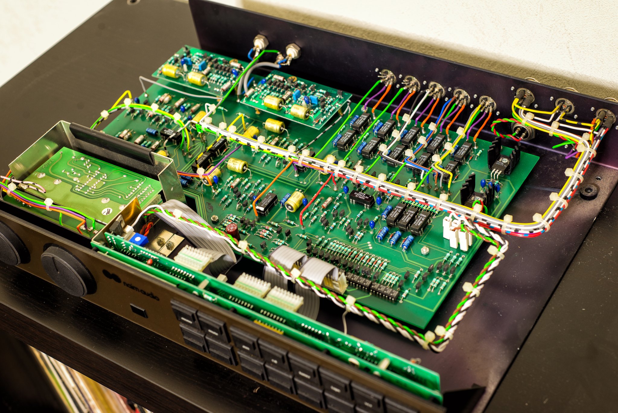

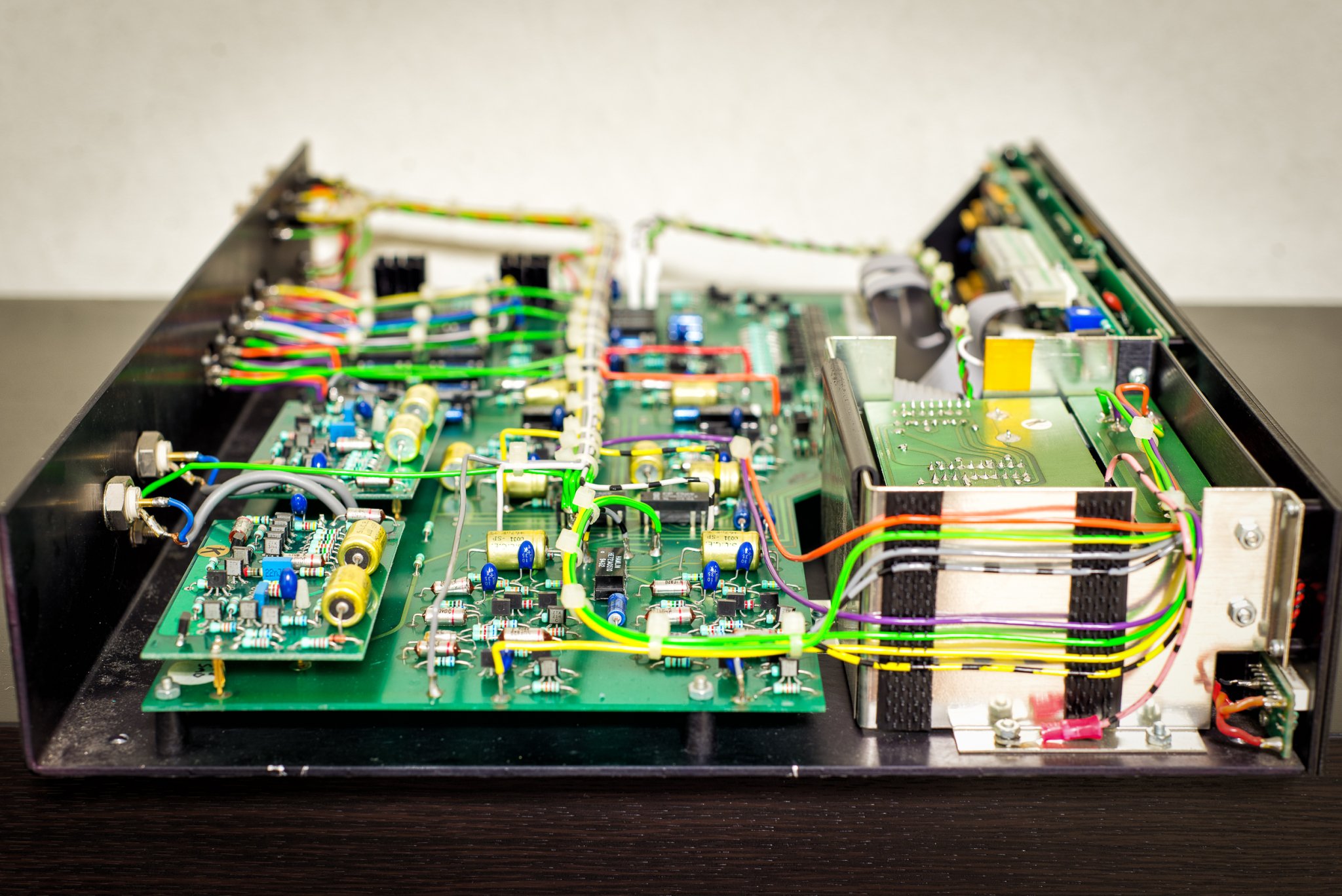

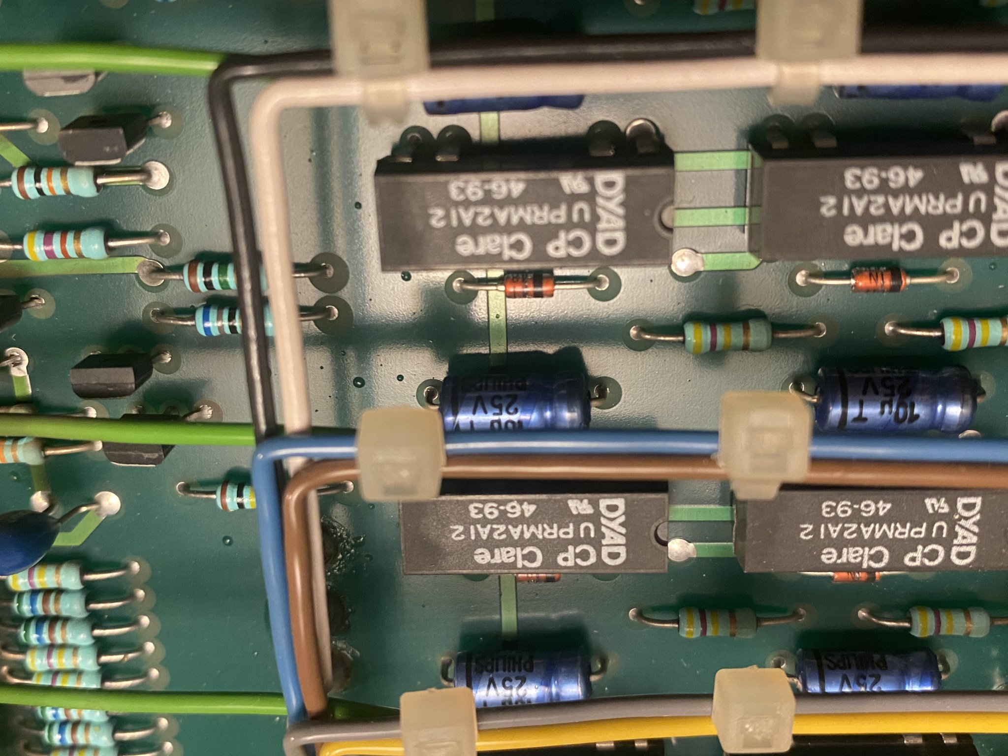

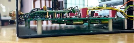

A friend of me want to replace the electrolytic capacitors.
there are three variants (go to the attached images) :
1) Tantal (blue radial version) according post #12 (14) good replacement is KEMET's axial type T110 - go to
https://content.kemet.com/datasheets/KEM_T2031_T110_AXIAL_T212.pdf
2) usual electrolytics, axial, blue version (maybe BC components or Philips, probably for the mute control unit)
3) yellow axial version from S.L.C.E. - go to
https://aeservice.fr/en/product/slce/
The question rises up, which of the capacitors are critical regarding reliability and sonic performance.
If there was a circuit diagram it would of course be easy to find out.
Maybe one of the member can upload this - thank you very much in advance.

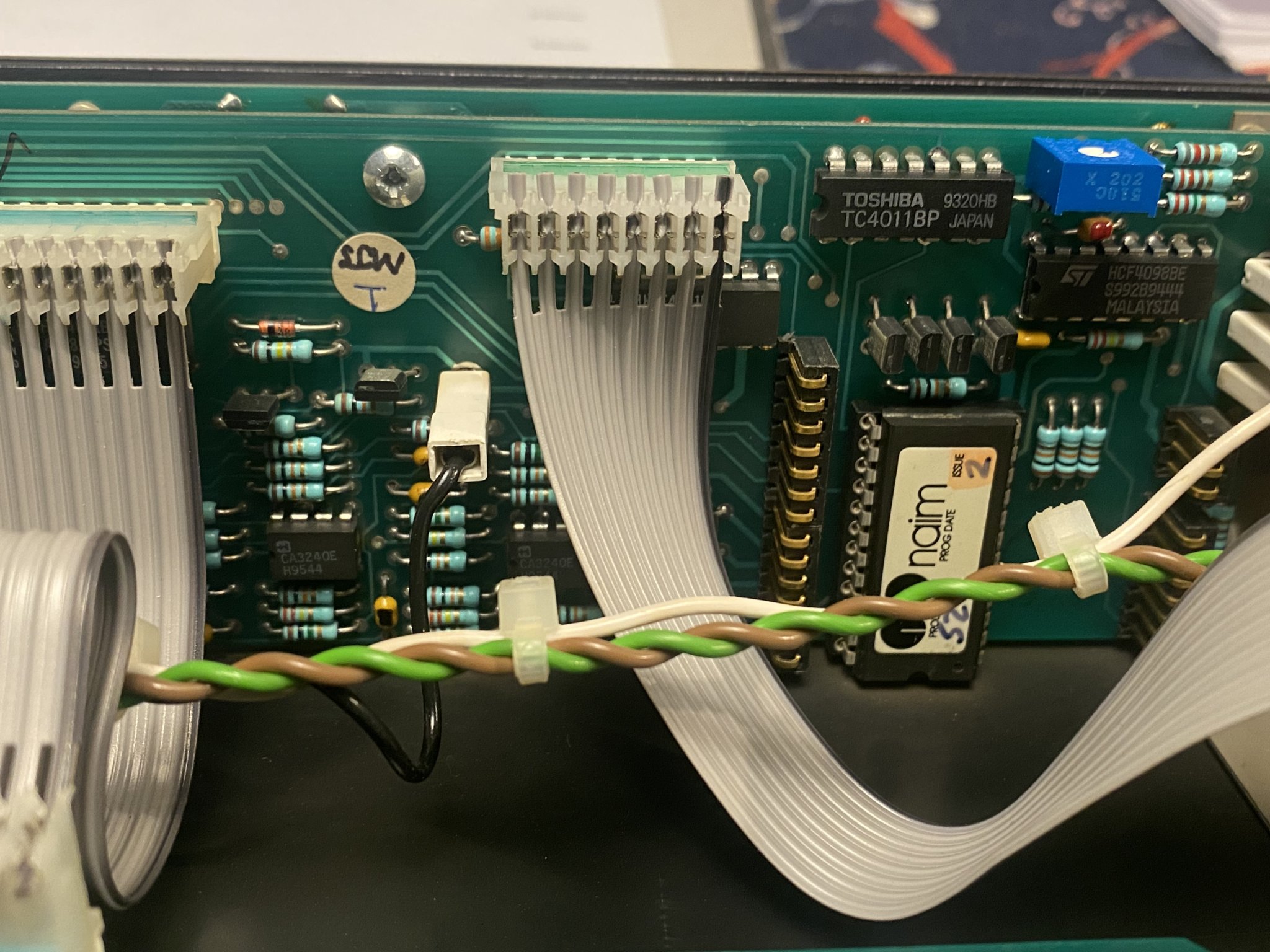

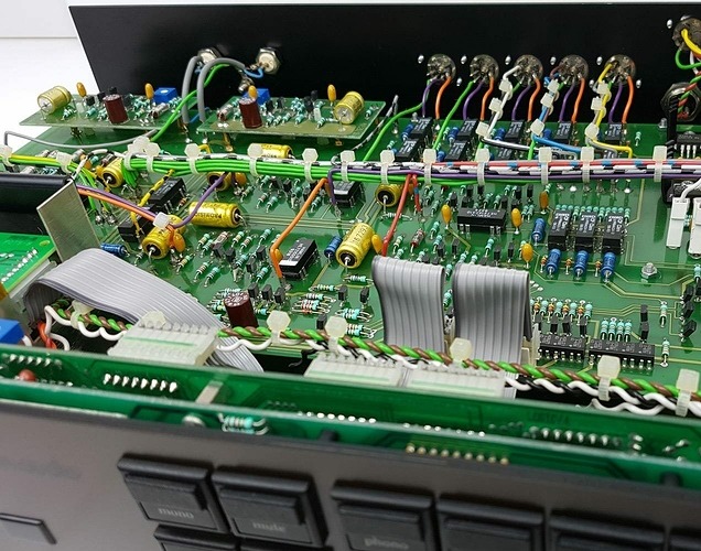

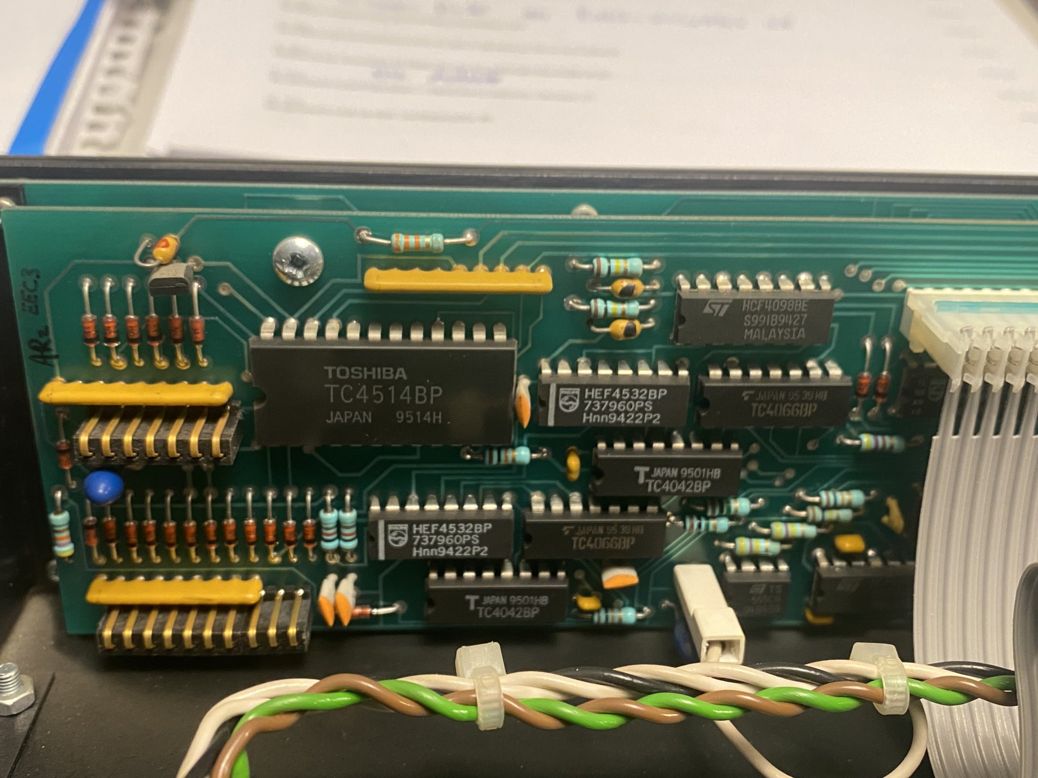

P.S.: special parts from front PCB of control unit (go to sixth attached image and the last both images in post #13):
1) TC4514BP
https://pdf1.alldatasheet.com/datasheet-pdf/view/114285/ETC1/TC4514BP.html
Short form data in service manual of SANSUI's A-1500R (integrated amplifier)
https://audiocircuit.dk/downloads/sansui/Sansui-A1500R-int-sm.pdf
2) MCU: unknown due to being covered with a sticker with the Naim Audio logo. Program Date: 31-1-95

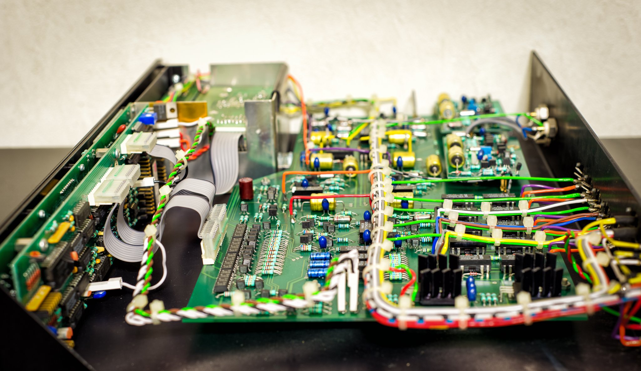

What a beauty! Replace all lytics and tants if this was never done. Nichicon UKZ, UKW, UFG etc. are fine (low ESR caps are not recommended). Kemet T356 or TAP series by AVX are good replacements for the tants. No schematic is needed for recap, just keep track of polarity and replace like for like. You can find tons of info on pinkfishmedia.net about recapping a NAC82.
Generally there are supply rail caps, caps around regulators and caps in the buffer and gain stages. In and out caps are usually tants, the golden ones are often decoupling and feedback, but the exact information you can look up by googling schematics for NA729 and NA321. These are the circuit used in most Naim preamps. Phono cards are NA522 or NA523. Some people keep the brown ROE caps if they are still fine, but I would replace them all.

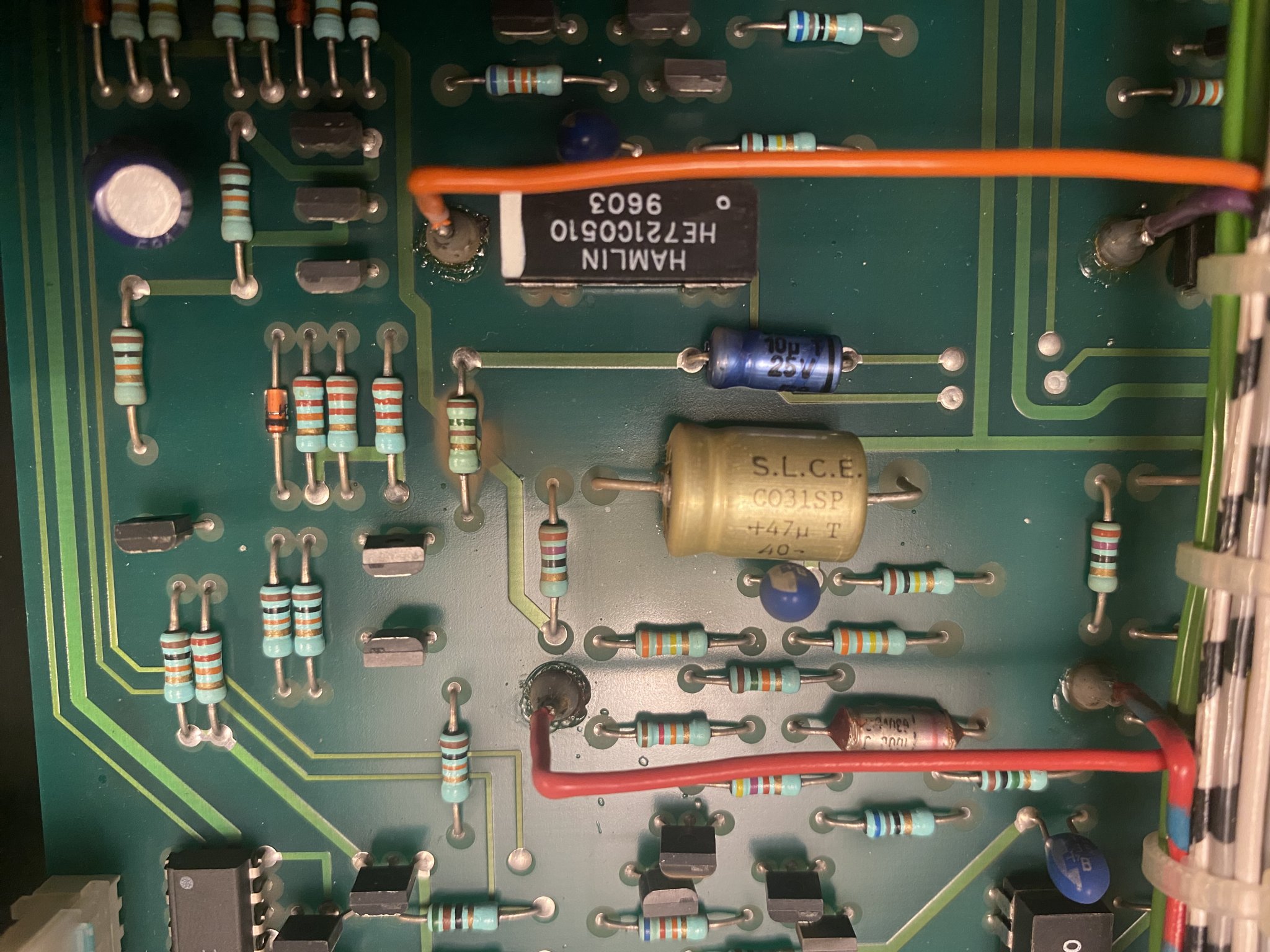

A closer look to the attached images (from the above mentioned URL) shows that the blue tantalum balls have been replaced by the smallest available WIMA MKS versions for 10uF (the capacitors that are in the signal path - I did that 30 years ago in my NAC 42 pre-amplifier, but with 2.2uF Siemens MKH versions, since that was the best compromise between smallest available size at those days and a still acceptable higher f3; nevertheless the sonic performance was better in all respects, especially in the upper frequency range, i.e. less aggressiveness and sharpness).
Additional I note, that the yellow axial Sic-Safco elcaps were not removed, but were moved to the underside (solder side) of the main PCB - go to image No 4.
What is also noticeable is that the blue axial types from Philips or BC components were not removed and replaced.

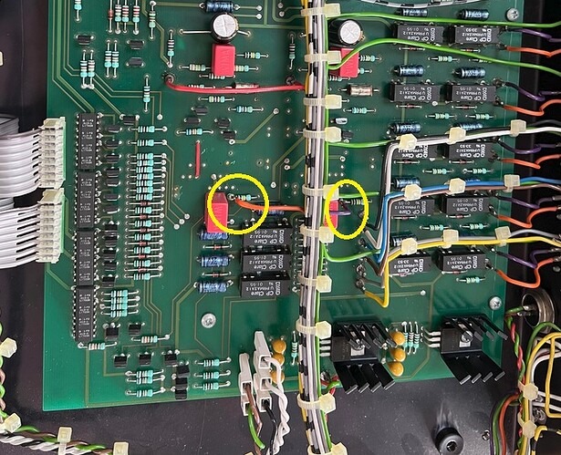

Maybe it is possible that these capacitors (on each reed relais "LITTELFUSE/HAMLIN HE721A0510") are those that have the task of ensuring that no pop noise occur during switching when selecting the input source (parts of a mute control unit), so that it is not necessary to turn down the volume control knob before switching on source select.

What about the availability of the programmed EPROM from image No 6 from post #1 ?

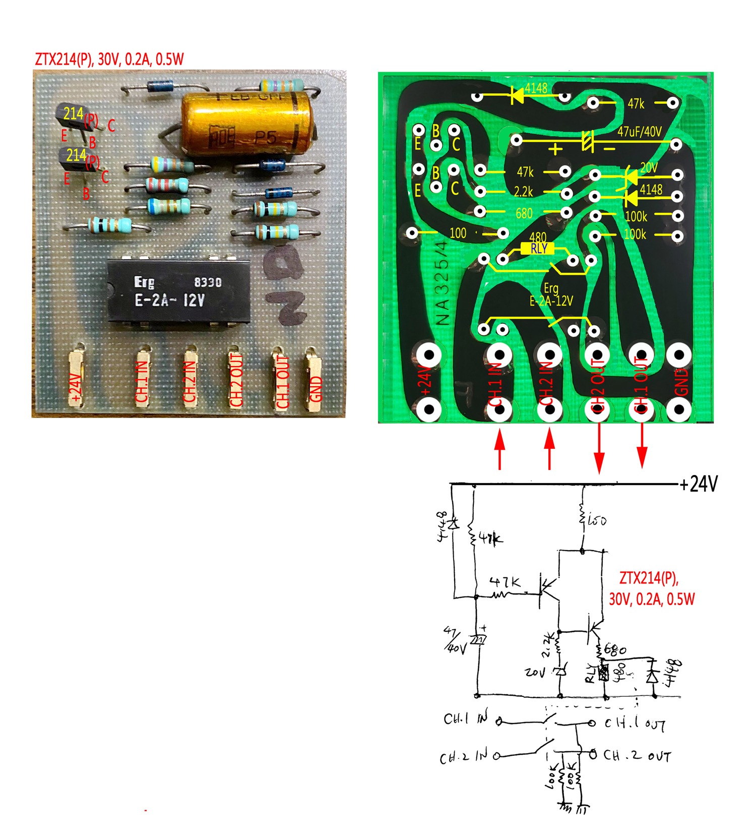

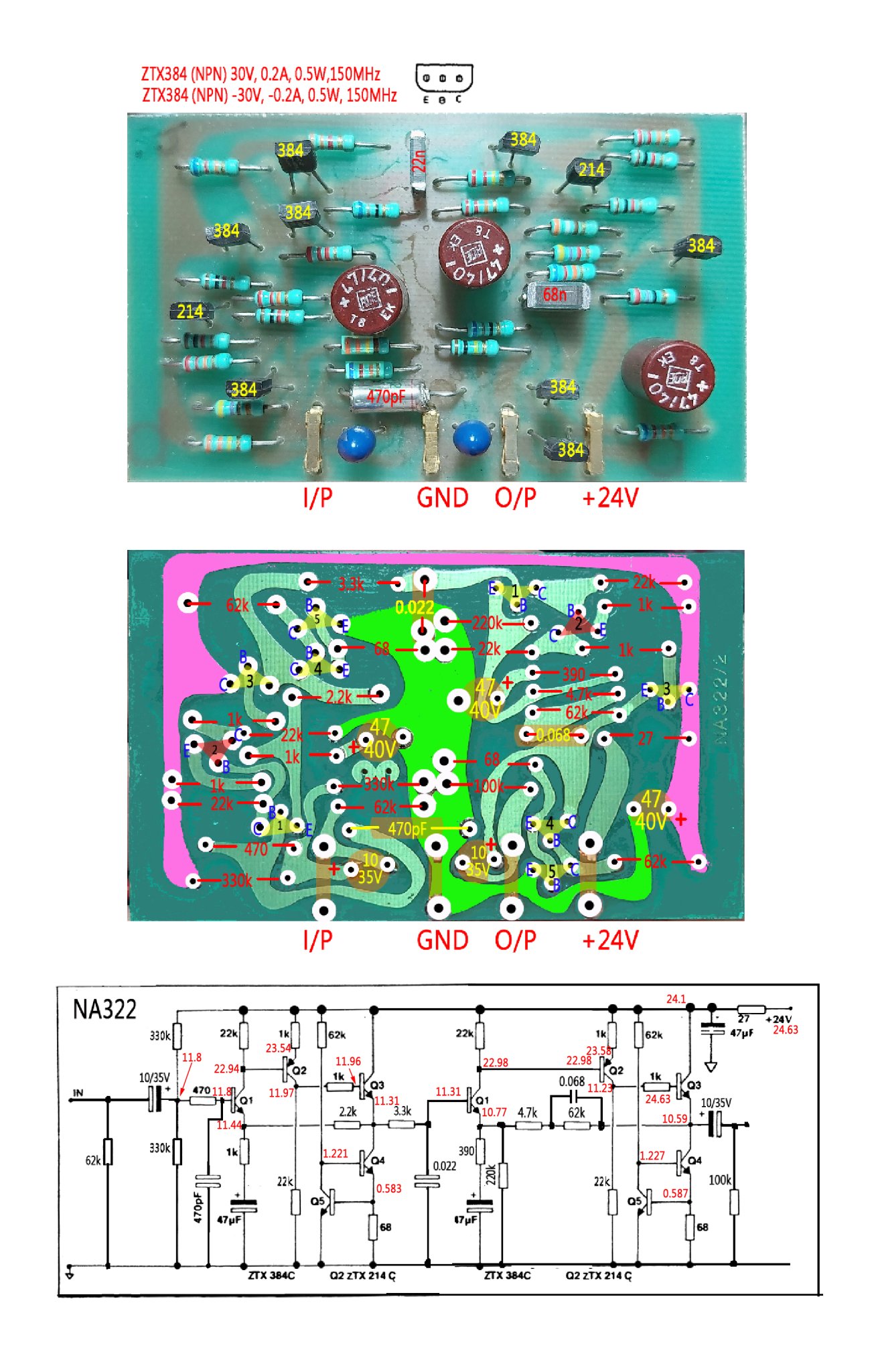

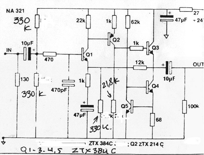

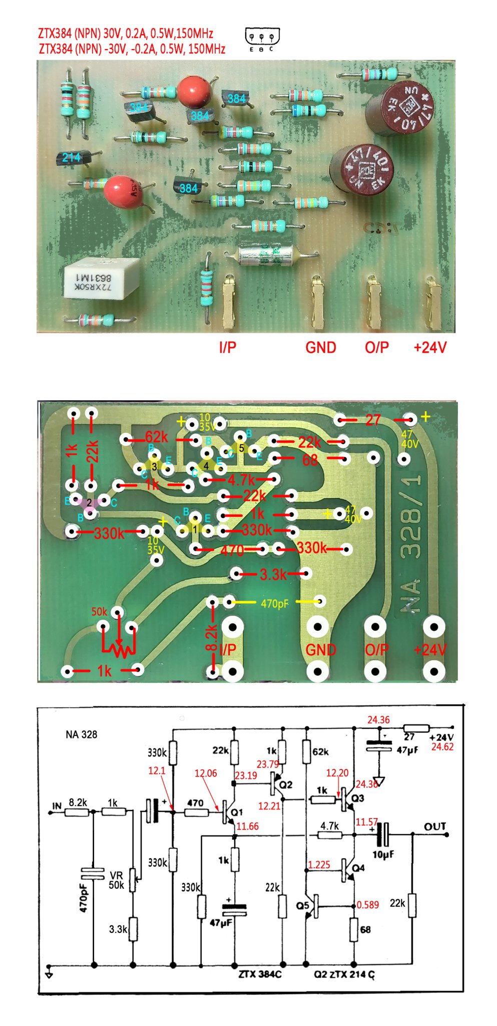

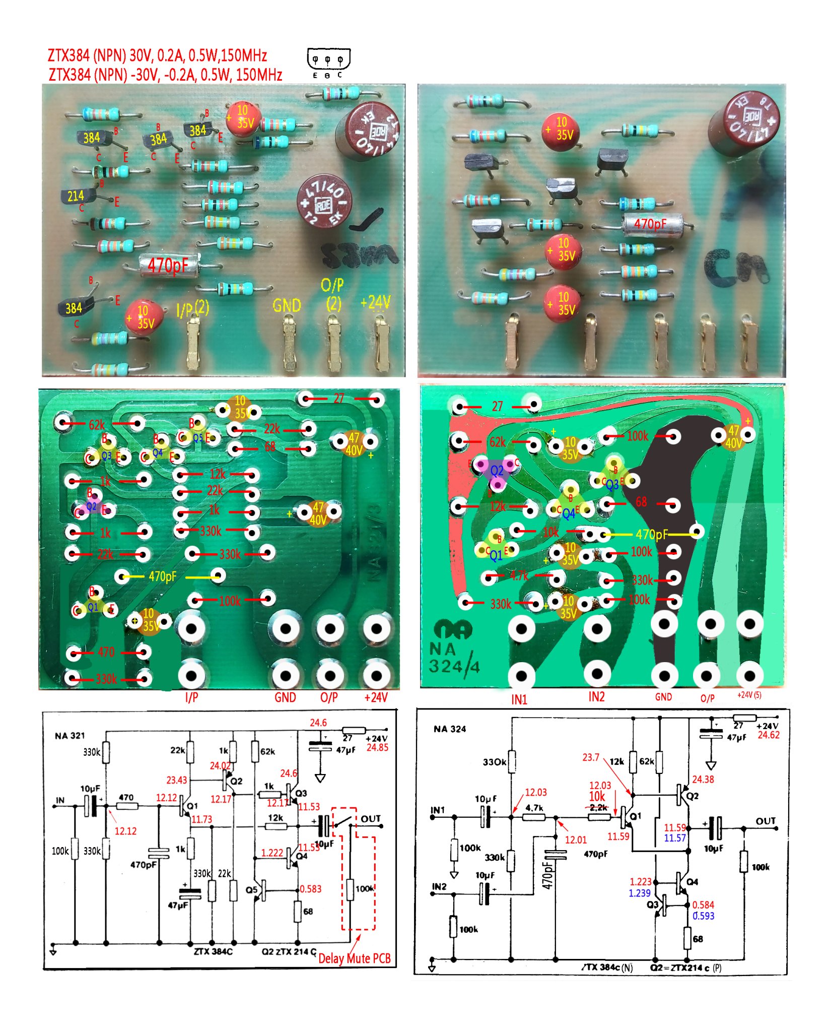

Yes - according the attached circuit diagrams there are - except the tantalum caps in the signal pad - only one cap in the NFB pad, one cap behind the resistor in the positive rail (actually part of power supply) and one cap on the module for the mute control unit.What a beauty! Replace all lytics and tants if this was never done. Nichicon UKZ, UKW, UFG etc. are fine (low ESR caps are not recommended). Kemet T356 or TAP series by AVX are good replacements for the tants. No schematic is needed for recap, just keep track of polarity and replace like for like. You can find tons of info on pinkfishmedia.net about recapping a NAC82.
But still, a circuit diagram or, better yet, a proper service manual (and possibly service bulletins published later) for exactly this model would be helpful, as one can see numerous differences in detail between the circuit diagrams shown in the attached files.

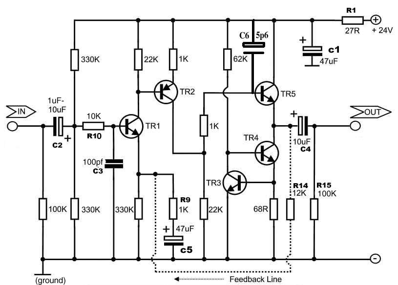

I should have said low ESR electrolytics are not recommended in the signal path of a typical Naim circuit. The schematics you can find easily with the numbers I mentioned. Wimas in place of the tants will change the typical Naim sound not necessarily for the better - read up on this in the green forum. I would keep it as original as possible.
EDIT: you already found most of the schematics, great. The NA729 would be helpful too. Naim service manuals are normally not available on the net with very few exceptions.

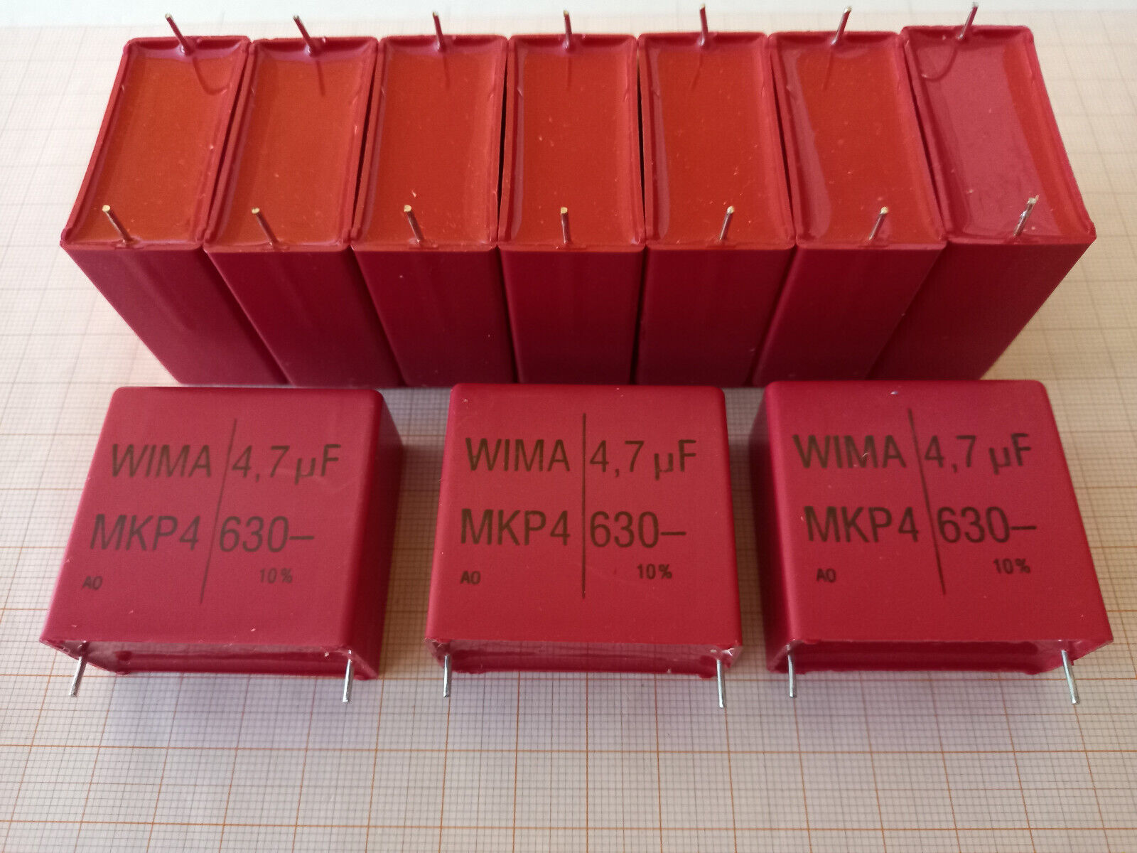

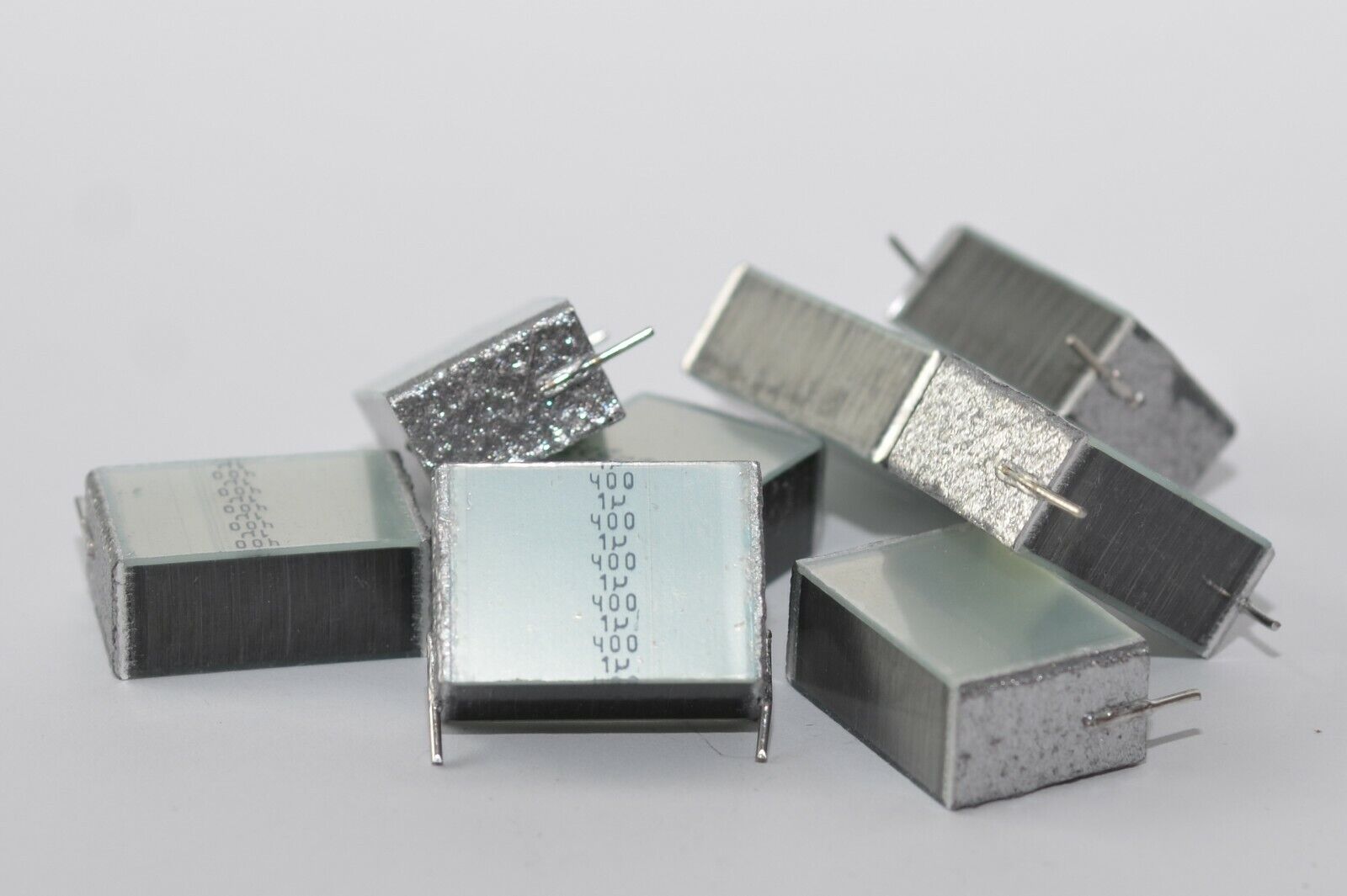

In what way the sound deteriorates in order to come to this decision ?I also did once replace the tantalum capacitors in a NAC42 with Wima MKH caps. I hated the sound immediately and changed it back again. BTW: most Naim schematics from those days are basically the same, at least for the signal path.
Siemens MKH wasn't best choice, unfortunately for WIMA MKP space is an issue, but sonic performance is even better than at MKH (actually MKT).

On the one hand, it is the case that the capacitor is biased due to the asymmetrical (single) supply voltage of the gain stages (in contrast to most other devices with a symmetrical (±) supply voltage), which makes the use of elcaps less problematic - but OTOH I have nevertheless noticed, that this is in contrast to both normal ones of aluminum Elcaps as well as foil versions tend to sound harsh.

Of course it was not the best choice, but - as you said - the MKPs were too big for the pcb. I did not like the sound, which was hard, somehow distorted and not musical at all. The smoothest sound I could get with the old Naim circuits (actually a NAC42, converted to a NAC42-5) was using wet tantalums (KEMET T110) for the signal caps.In what way the sound deteriorates in order to come to this decision ?
The first attachment show the versions, what I have choice for replace at those days on my own NAC42 device and second the version, which I prefer in terms of sound.
In my experience polarized electrolytic caps will sound at least ok or sometimes even extraordinary good if properly biased with DC. This seems to be in contrary to the usual belief.

interesting advice despite the costs for it - this version I had never tested:Of course it was not the best choice, but - as you said - the MKPs were too big for the pcb. I did not like the sound, which was hard, somehow distorted and not musical at all. The smoothest sound I could get with the old Naim circuits (actually a NAC42, converted to a NAC42-5) was using wet tantalums (KEMET T110) for the signal caps.

It's definitely worth giving this one a try for sound check in this (and other) amp models from Naim Audio.
The usual assumption that film capacitors are better in the signal path is certainly due to the fact that all comparisons that I know of have taken place under unbiased conditions, because there are only very few brands and amp components like those from Naim Audio, Nytech, etc. that are operated with a single supply voltage - check out also
