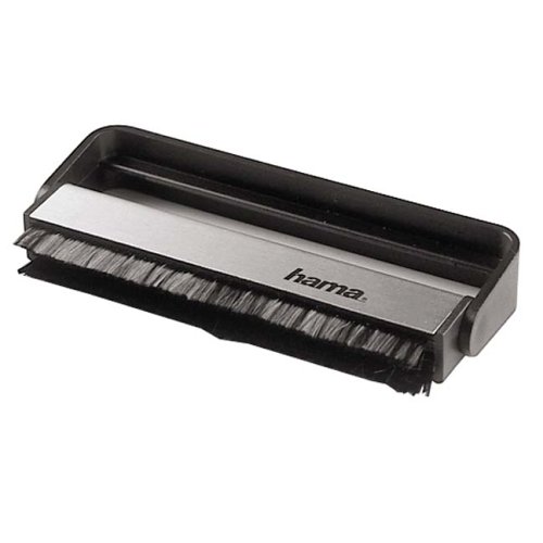

The only bit you need is the carbon fibre bit, the Hunt is a pain
to use (as are all the carbon fibre brushes with "velvet" pads)
and the Decca tends to fall apart.
something like this is perfect and not expensive :
(you swivel the brush to wipe off the dust on the raised section)
They are easy to use on a running record without stretching the
belt (unlike the pad types), just hold it tangentially, the right
pressure is obvious, (you can feel the friction of the fibres pushing
into the grooves), then slide off with a slight sweep as you go.
http://www.amazon.co.uk/exec/obidos/ASIN/B00006IVT9/onthewebcom-21/202-2283078-0073464
🙂 sreten.

Yes the brush does form the dust into a line but in forming
this line most of the dust is lifted clear of the groove, and
a lot of the fine dust gets stuck between the fibres.
just hold it tangentially, the right pressure is obvious, (you can feel the friction of the
fibres pushing into the grooves), then slide off with a slight sweep as you go.
I've just checked the way I do it and it not like the above
may appear to mean.
If the brush is held 8'oclock with the left hand after a few turns
I basically make a sweeping motion natural to my arm length.
You wiggle the brushes holder over the fibres to clean them
and then if necessary repeat the above until satisfied.
I usually do it twice, 🙂 sreten.
