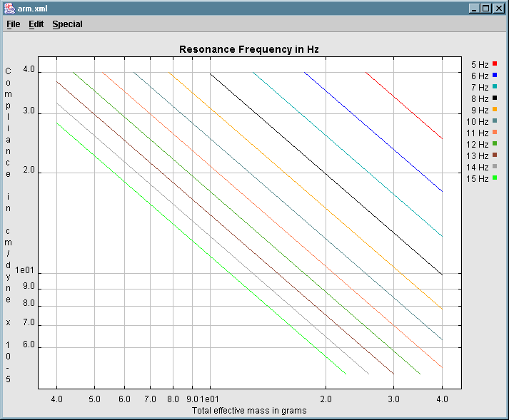

Sreten : after reading your latest posts with my stomach full of ravioli and beer, I found it resonable to go for 'as light as possible'. It seems that the Resonance Frequency will end up under the audioable area:
Your attached Resonance Frequency-tabel probably proves that, but I don´t know how to read it. 🙂
So I´ll try with the Ortofon OM 30 Super, it´s a cheap p.u & I must start somewhere. Better to test it all out first and upgrade later if it´s nessesary. And it´s certainly better than my old 'K9', but I wounder about this:
How do I remove the weight, is there a big risk to damage the p.u when doing it?
Best regards
25 cu = ~ 13Hz vertical and ~ 5Hz lateral
From what you've said and the application I think the Ortofon OM 30 Super with the weight removed is a great choice
Best regards
the axis are a little confusing,
left is from 6Cu up to 40cu,
the bottom is from 4g to 40 g.

Regarding the graph
And assume a cartridge mass of 5g.
some Cu's - 10, 20, 30
some arm effective masses 5, 15, 25
which give total effective mass 10, 20, 30
You look where they intersect and at the nearest lines.
10 cu - 10g = ~ 16 Hz
10 cu - 20g = ~ 11 Hz
10 cu - 30g = ~ 9 Hz
20 cu - 10g = ~ 11 Hz
20 cu - 20g = ~ 8 Hz
20 cu - 30g = ~ 6.5 Hz
30 cu - 10g = ~ 9 Hz
30 cu - 20g = ~ 6.5 Hz
30 cu - 30g = ~ 5.3 Hz
On a turntable like your Thorens target is 10Hz.
🙂 sreten.

Thanks for filling the blaks about the graph, but why should 10Hz be good for my Thorens?
How do I know what will be right for my new table? That will be a non-suspention-table, if that makes any differances (it probably does, everything seems to matter).
Are there any place on the net where I can learn more about stuff like this, could be fun to know the theory behind the result.
Basically for your solid turntable and type of arm its a compromise.
All records are eccentric to some degree. At 33.3 rpm this means
the arm has to move side to side at ~ 2Hz, a lateral resonance
of 2Hz is not good , 3hz is not good for 45rpm records.
Whether the arm would actually work would depend on the
amount of damping in the system, but its obvious a higher
lateral resonant requency is a much better idea.
Record warps fortunately are in the vertical direction but again
nearly all records are not perfectly flat, so 2 Hz and 3Hz again.
Bad warps or ripples - you tell me - but obviously quite a bit
higher frequencies are generated, generally presumed to be
up to 6Hz.
Good turntable suspension design will also try to keep all
frequency modes below 6 Hz and its genarally accepted
3Hz to 4Hz is a good suspension frequency.
This means the lowest arm frequency generally useable is
~ 8 Hz. But 10Hz is better.
However the higher the frequency the lower the compliance
and the poorer the low frequency tracking, so basically you
don't want to raise the frequency too much.
8Hz to 13 Hz is a good range but the nearer 10Hz the better.
Note that DJ's typically use nearer 15Hz, with a coin on the headshell 😉.
For your arm its a compromise between mass i.e. structural
integrity and the frequency of the lateral resonance. If the
vertical resonance is too high you start to get a bass boost
(but only for out of phase bass so not really an issue)
IMO the compromise for a medium compliance low mass MM
and a higher mass low compliance MC would roughly be the
same, with a stronger build for the MC the lateral frequency
would end up very similar.
My target for your arm would be 4.5Hz to 5Hz = 55g to 40g total mass,
if the total mass turns out lower great, up to to say 75g fine also.
🙂 sreten.

sreten said:
I'm not prepared to argue with your first statement other than
to point out it makes them completely unuseable with any form
of suspended subchassis deck, with main modes of 3 to 5Hz
and usually lateral and rotatational modes 2 to 10Hz, the
change of level as the arm moves across also doesn't help.
well, as you corrected yoursellf already, lateral excitation happens at 0.55Hz@33rpm (and 1.32Hz@78rpm 🙂 ... I'd say that a lower lateral resoncance at >3Hz is probably far enough apart from that to prevent oscillation or keep it within bearable limits (i always assume that the cartridge's cantilever supsension has a considably high amount of damping -- the suspension consists of rubber after all with a decent movement-2-friction-heat conversion .... and all possible hysteresis and relaxation effects take place too
Passive linear trackers and lightweight supension TTs don't cooperrate, agreed. But give your air-suspended TT plinth some weight, maybe 100kg?, and make the air springs reasonably low-damped and level the sucker and you may find you like the sonics very much .... 🙂
Your second point I will take issue with. Low frequency trackability
is directly proportional to compliance and the frequency of the
lateral resonance if below a reasonable value does not affect
trackability in the Audio range.
A reasonable estimate of low frequency tracking
capability is compliance times tracking weight.
Hmm, i em no ´neeetif speeka, do you mean by "take issue with" that you disagree?
My experience with low lateral tonearm resonance and low compliance: the cartridge may mistrack or not, in any case it doesn't loose track i.e.it jumps back into the same groove.
No question that an old, worn, weak-of-age MC cartridge which maybe manaages to track 60µm (or only 50µm?) on the ortofon 0002 will mistrack at the 1812 cannons.
But atleast the music goes on (rhythmically) uninterupted, due to the high lateral inertia of the tonearm. Yeah, i know, a dirty defintion of tracking ability 😀
And a cartridge which is at its tracking limit in a usual pivoted arm marches around the edgy corners with stunning ease in a laterally low resonating linear tracker. I just tried that out.
But, admitted, i did not measure THD.

By "take issue with" I meant prepared to argue the point.
By "tracking capability" I didn't realise you were referring to
nice mistracking characteristics, I took its meaning literally.
In the literal context the OM30 will be rather good.
The offset 45 comment was a little flippant. But an old LP
with a filed hole, say 2mm could be useful for checking the
arm at various points across the record.
🙂 sreten.

dice45 said:
He reported that most passive linear trackers have more than 3 times the lateral force of a pivoted arm with Anitskating adjusted to zero.
Which is exactly what you'd expect isn't it ?
Lateral force on a cartridge being related to lateral effective mass.
I'd expect a similar difference between high and low mass
pivoted arms, its the extra dynamic force needed that reduces
the resonant frequency for high mass pivoted arms.
Its quite easy to show the deflection angle of a stylus for an
eccentric record is inversely related to the lateral resonant
frequency.
And identical for different mass / compliance combinations as
long as the resonant frequency is the same.
(ignoring friction/stiction)
🙂 sreten.
