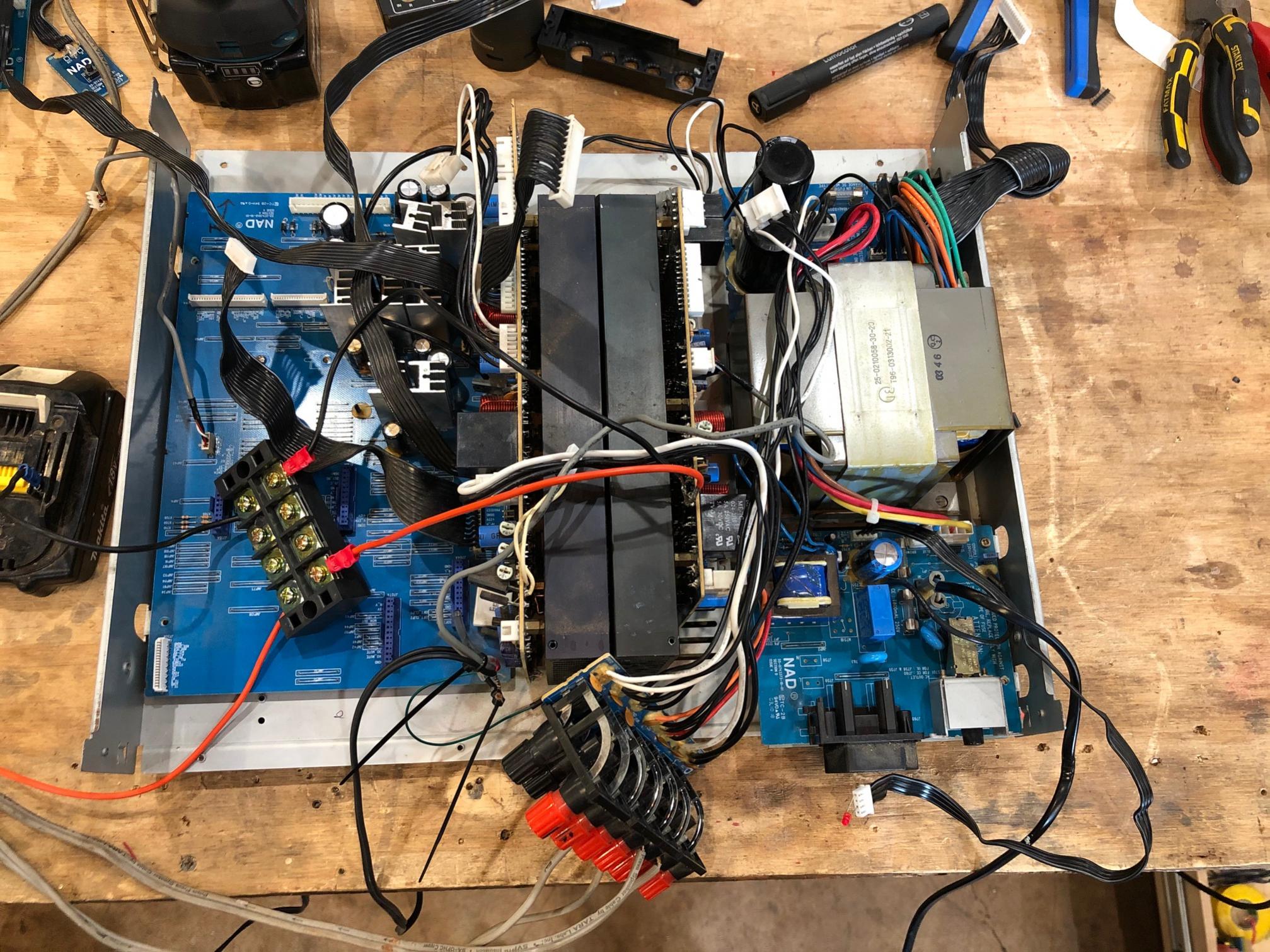

The main difference between his and mine is that I always suspected it was more the 'brains' rather than the actual hardware that was busted on my unit, so I was looking for a way to brute force it and inject a signal directly into the amp circuit.

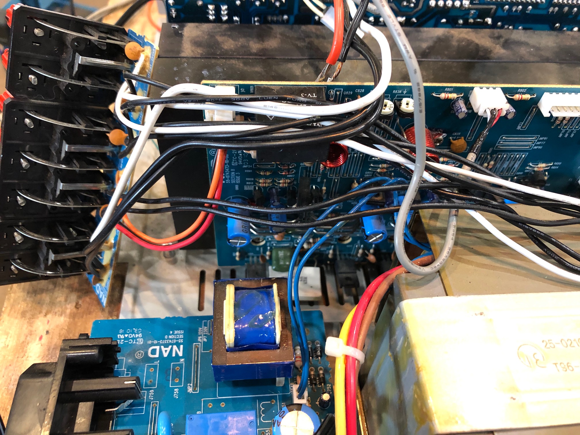

First thing was to test the power supply. After jury rigging the standby switch to bypass the front panel, I found I was getting a reasonably consistent +- 50 volts on the primary, however all the secondary voltages appeared to be reading low. At this stage, I'd already comitted to bypassing the brains, but it could turn out that it was simply low voltages to that side of the unit that was causing me the issues. So Lesson Learned there. Mine isn't undoable, but for what I want I don't think I'll bother as I do have another NAD unit to work on (a T775) in the future.

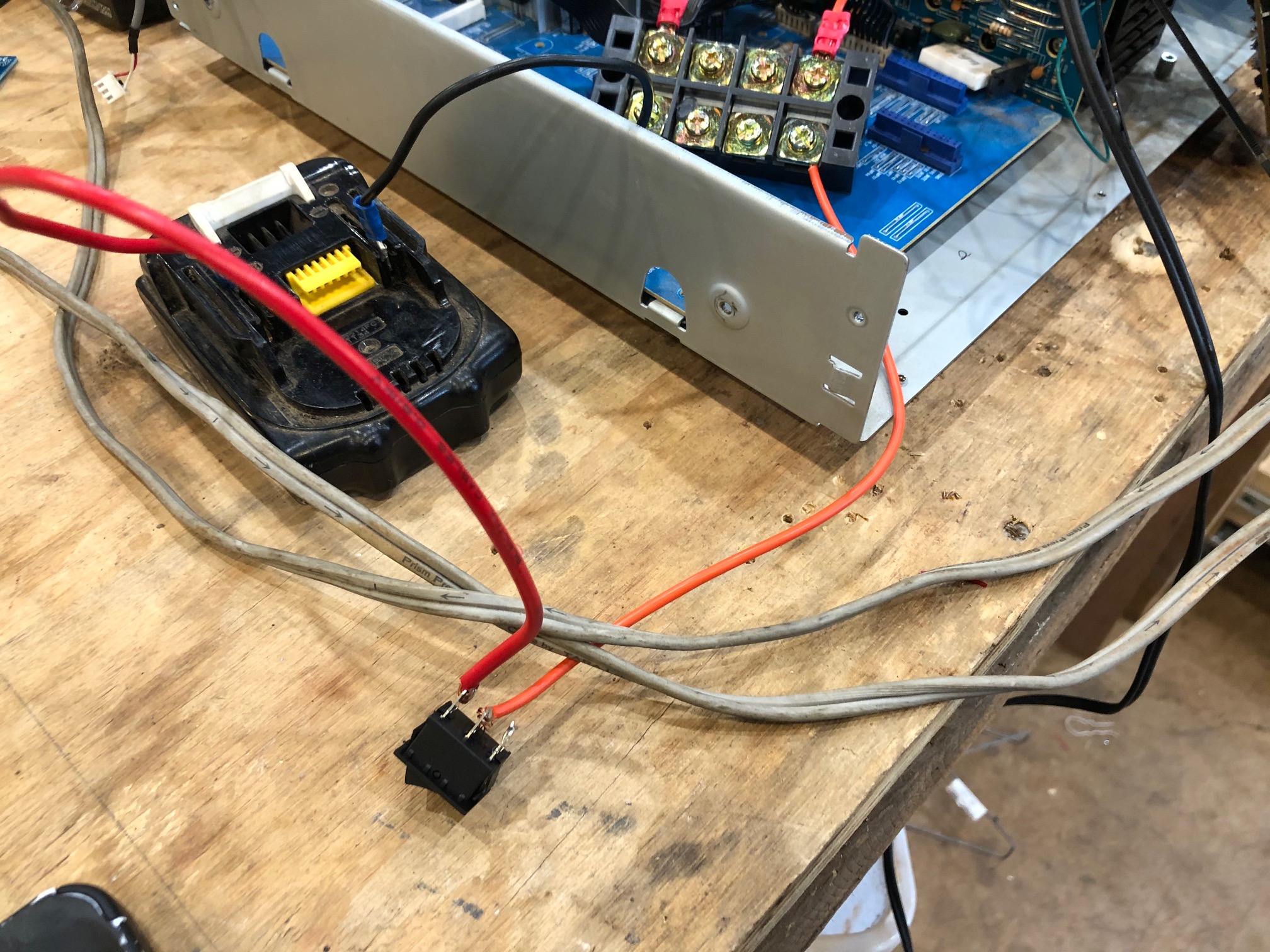

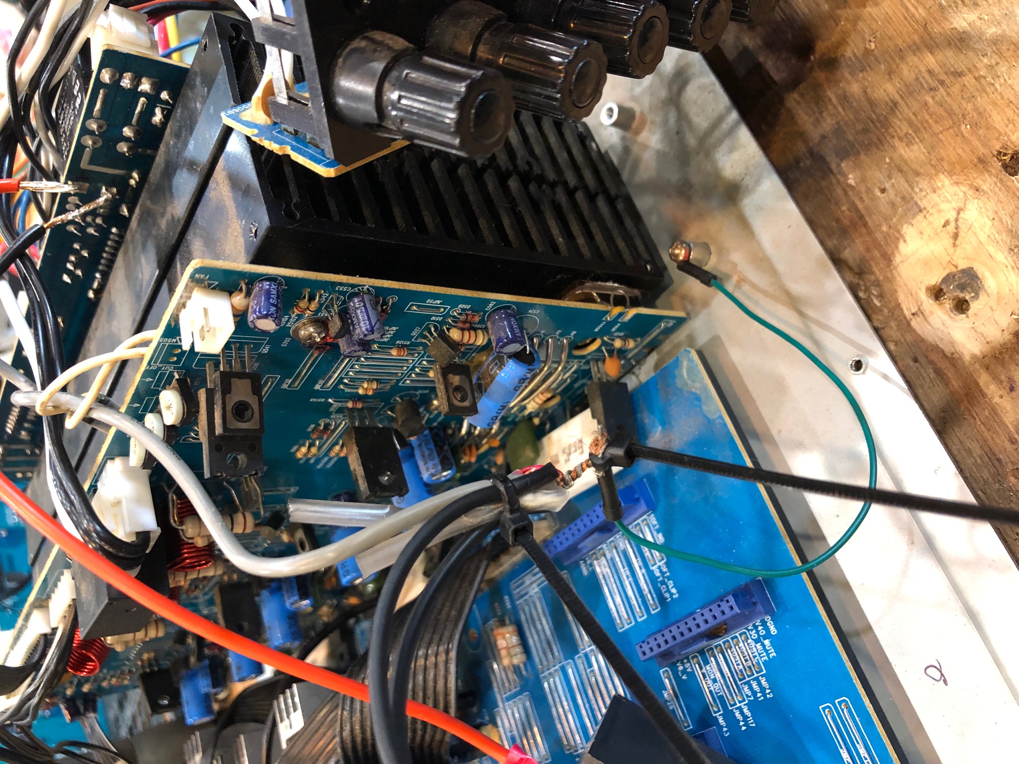

After that, it was a matter of tricking the speaker relays to turn on. In testing these I may have fried the main front L/R relays by putting the reverse voltage on them (oops). I 'think' it's repairable, but I proceeded with the surround speakers anyway as each channel is basically the same circuit. My power source is a LiON battery, with some leads soldered onto where the relay connects to the board. I wired in a little rocker switch so I can turn this on/off as needed.

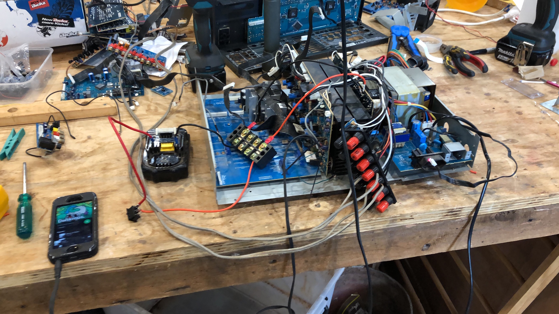

The grey lead coming from the pre-amp board is where the audio signal come in. To get me started, I just snipped this and spliced this onto a headphone to RCA lead that I also snipped, and just wired it in. Audio source is spotify on my phone, and volume is controlled there as well.
Et Voila, IT VERKS!!!!

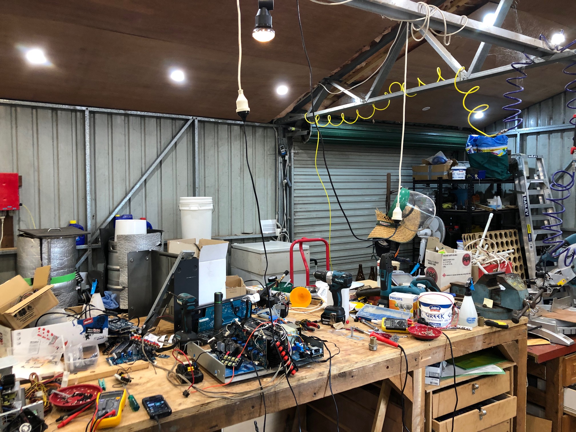

Note these photos are dodgy as hell as this is just a bench test, but I'm ecstatic that the proof of concept is working. One cool thing I've noticed is how my current limiting lamp throbs in time to the music.
