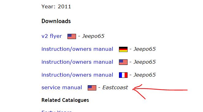

Manual/Schematic
Thanks for the reply. I couldn't get there. I got as far as the owner's manual. When I tried to get further, my anti-virus stopped me.
You should have the link now. You don't install anything with Dropbox, just look for where it says to download the file.
Hi Guys. Could you please send me the link for the schematic as well? I received a Nad T748, briken, as a present and want to attempt to fix it, maybe by converting it to a plain old analogue amp... 😁
The link in post #2 takes you to the site hosting the manuals. You need to register but it is all free.
