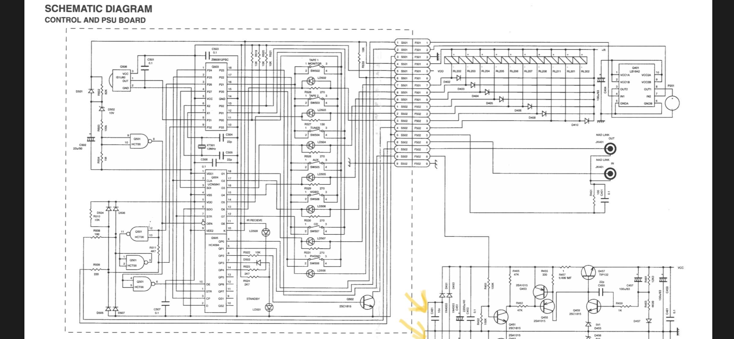

Yes exactly.Do you mean that when he switches input (push buttons) it doesn’t respond at all? Only from remote?
First of all i would check the powersupply, because i know some of the components goes really hot and caps can be dried out. If thats ok i would check frontpanel and it could be q503 ic thats toast (not sure) but then he is out of luck cuz thats Nads own chip and there is no replacements.
I’m not really sure.
The way i see it also is that if the remote can do the switching and everything else works fine then all the tact switches are broken and thats not likely either.
Have this unit ever been touched? Some photos and general check would be good.
I think the problem is the green button on the remote. Apparently when you turn off the preamp through it, the functions on the front panel are blocked. He called me now, he says, after the preamplifier disconnected from the mains with the button on the front panel everything worked correctly.
I just wanted to ask you to try this lock too, but with your remote control it apparently doesn't work out. In the silver series there is another S70 remote.
NAD S70 - Manual - System Remote Control - HiFi Engine
