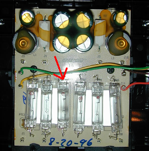

Bose Acoustimass speaker series also have them in the crossover.

I hear that "bulb compression" al the time, since I regularly test amps into a DBT .
It DOES produce some compression, since narrow peaks pass through without much trouble while sustained tones/music get squashed.
In my view, that sounds horrible, unnatural, squashed, don´t know how anybody could call that "a feature", but hey, there´s people who eat raw meat too 😱
Use a 10W amp with a 100W supply and rely on a cheap bulb to avoid its sudden death?
Maaayyyybeeee, in my book that´s bad engineering.
Sincerely, I prefer some random peak clipping here and there that that "driving with the hand brakes applied" thing.
To me, it´s more honest .... maybe we got used to some peak clipping? (if playing LOUD I mean?)
Reactions: Hiten
I have to disagree with you JMFahey, the NAD like the Bose speakers the bulb only start to glow when amp/speaker is pushed to the limit I think of it like a resettable fuse that you don't have to replace.
Or you also going to claim that you cam "ear" a fuse ?
PS: Bose speakers are crap by design
