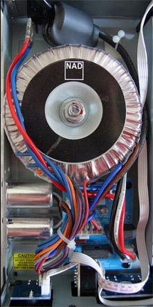

I would like to know how those lamps operates...it seems some new models have two supply voltages and those lamps (one to each channel) ligths when power is high.
I do not have an idea how this is operating and i would like to know.
Can you explain that to me?

The purpose of the lamps is to cause massive sagging on the (too high) supply rails so that the undersized output stage and heatsink don't melt when high average output power is demanded.
Eva is competent... she use to beat everybody.. and daily
And it is good to have her around.
So.... they are trying to have some dinamics... as during some small peak moments, some audio transients, peaks, will be twice or more than twice (4 times more maybe) the average power.
And during continuous tone the supply drops to a lower level good enougth to allow the output transistors (weak ones) to survive.
The lamps are there, in series with the supply to reduce the voltage when needed...interesting Eva.... this use to produce interesting sound...i had in the past one amplifier that had weak supply... so, during peaks was great..but under load, sinus signal entering the power was small.

Now fully understood...the lamp goes in series into the supply
there are two supplies windings, two voltages, one goes througth the lamp.
This way, low power transformer, transistors, small heatsinks, a 40 watts amplifier, will be able to produce higher power into peaks..small time power.

The halogen lamps goes in series with the bigger voltage rails
when the amplifier sucks current from the higher voltage rails, means it is producing more power than it can continuously produce without cook the output transistors..... the current crosses the lamp and the lamp heat up... the starting resistance is 1 ohm...when the lamp goes hot the resistance jumps to 4 to 5 ohms, this will create a voltage drop when the high level signal is constant, protecting the output.
When the peaks are not too much long in time...lamp does nothing... goes in series having 1 ohm, producing small voltage drop.
The lamps, seems to me to be automobile halogen lamps, as they have also 1 to 2 ohms resistance.
The higher voltage supply is 40 percent bigger in voltage compared to the smaller voltage supply..... the smaller may be 32 volts more or less and the bigger may be around 45 volts simetrical.
Interesting...very clever, very interesting...for sure produce the peaks we need, having reduced cost, not needing switching as class H asks for....good.

Carlos,
😀 😀 It's Class G in reverse. You don't want to go there. What it really means is "lets design a 100 watt amp and when it really needs that power lets switch to a low voltage rail"
Now think on this 😉 , if those bulbs had been encapsulated into little light proof boxes with the words " Dynamic interactive PSU" or something, that would really have had us wondering what was in there 🙂

I have seen this type of protection on BOSE speakers but never in 30 year of repairing gear on an amplifier and I challenge you to show me a schematic from NAD or any other brand with it.
OK. I suppose there may be fixed range when bulbs starts to protect the outputs and circuits. For a moment lets forget protection. As music is complex any measurements where it shows how much the high power the NAD circuits has sustained its high voltage/current supply. I mean duration of peaks and not contineous loud output.
The lamps act as variable resistors in the power supply rails, much like full power rated "lightbulb limiters" or "dim-bulb tester" devices, which have quite a few milliseconds delay as the power dissipated by the amplifier and speakers plus power lost in the light and heat dissipation, reaches a safe plateau.
Essentially, the peak duration you mention, would cause some analogous amount of heat and light in the bulb but whatever type of fast or slow current limiting is used, it must either limit/compress the dynamic signal, blow a fuse or open a relay incredibly fast if it is to prevent damage to those expensive power transistors in the extremes of likely abuse. Unfortunately, there is still no magic electronic circuit that somehow prevents damage without altering the audio in some way. NAD 315BEE and similar amps though, are reputed to be more reliable and easier to live with than most budget amplifiers that have limiting protection.
The better plan though, is not to be riding close to the safe maximum power limit and therefore depending on limiters in any event. If you really need more power and not just supposing that you might need it one day, spend the money and get a much bigger amp. as a priority.
