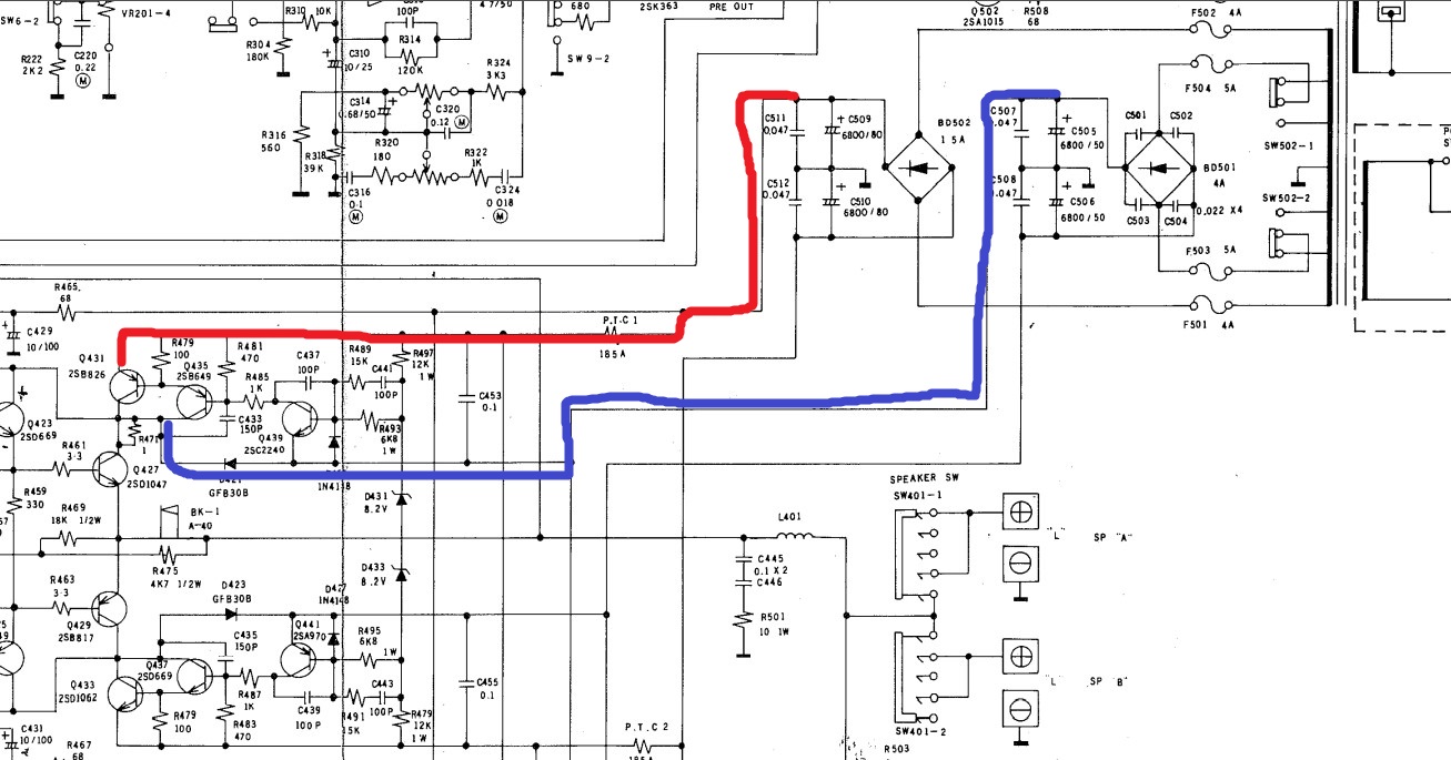

NAD made 2 amplifiers that looked identical, the 3130 and the 3240PE
from the outside they look identical but inside a very different story.
which part of the circuit would be the 'PE' bit, or is it just the entire make up of the circuit?
the 3240PE has alot of transistors in comparison to the 3130.
It would just be good to know as i will be working on a few amps going forward with the 'PE', and they look quite complicated.:yes:

AFAIK The PE versions are NAD's take on class G , (i.e. switching higher supply rails in on demand.)
You might follow that better by seeing the route from bridges BD501 and BD502 (over to the right of the output stage)
The amp runs a 'low' voltage rail as normal. That is the one in Blue. Notice the series diode (which I've obliterated in blue) as that is key to how it works.
So low voltage rail and all is normal, the output stage is fed via the diode.
The rail in red is higher voltage. When the audio output reaches a certain level those upper three transistors (which just form a high current 'switch' turn on and feed a higher rail voltage to the amp.
The series diode now stops that higher voltage from 'back feeding' into the low voltage supply.
The negative rail is similar.

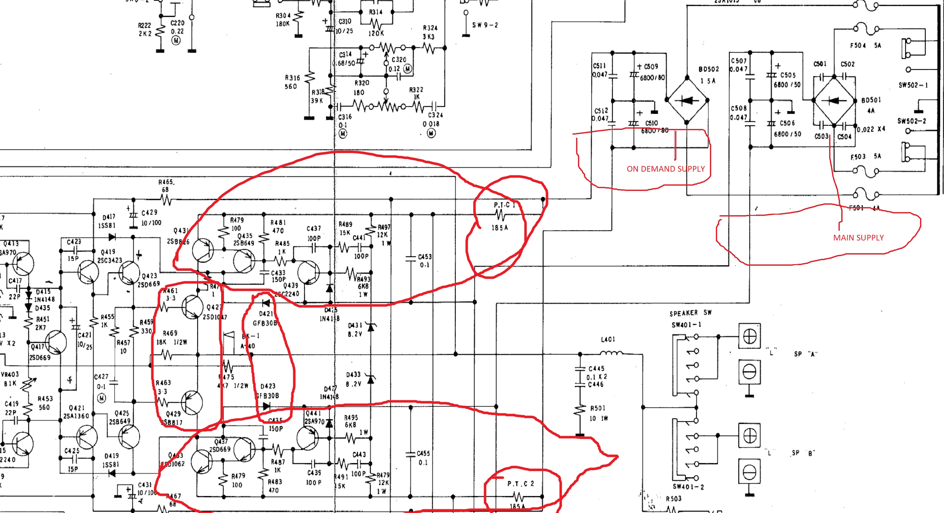

mike thanks
i presume this makes it a lot more complicated, it certainly looks it to me, although i am not as experienced as you and guys like mooly, so it may just look like it to me 🙂
See if this helps: (see attached annotated pic)
You can see the normal output drivers on the left (circled) fed from the normal supply via D421 and D423)
As you move across to pic from left to right, the next circled is the Class G (or PE elements - I should have circled D431 and D433 in that circuit element) , and I've ID'd the two supplies finally
