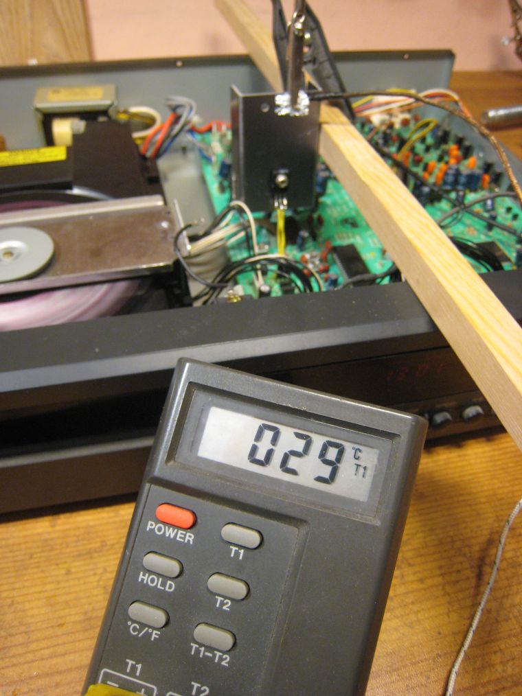

I`m having a literally burning problem with my NAD Monitor Series 5K player: one of the two transistors controlling focus coil gets very hot - 75-80C with heatsink (!), without heatsink it went as hot as 150C before I turned the player off.
I know there`s a known problem with this player regarding transistors driving focus coil overheating to the point of damaging solder joints, there`s even a service note describing the problem and suggesting replacing said transistors with physically bigger ones for better heat dissipation. I did so when the player started skipping (after ruling out pickup wear or damage) along with replacing bad capacitors (the real cause of skipping). The player works great now, but that one transistor still gets scorching hot and I don`t like that.
My question: is this normal for this player? I Can`t tell without other unit to compare. I got the service manual, run adjustment procedures, all seem to be OK... anyone with NAD 5000 willing to open his/her player and measure (or feel with a fingertip 🙂 - but careful!) the temperature of Q102 and Q103? Or maybe someone already knows what`s going on? Please help!

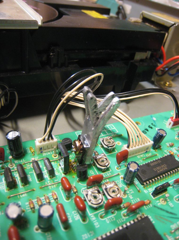

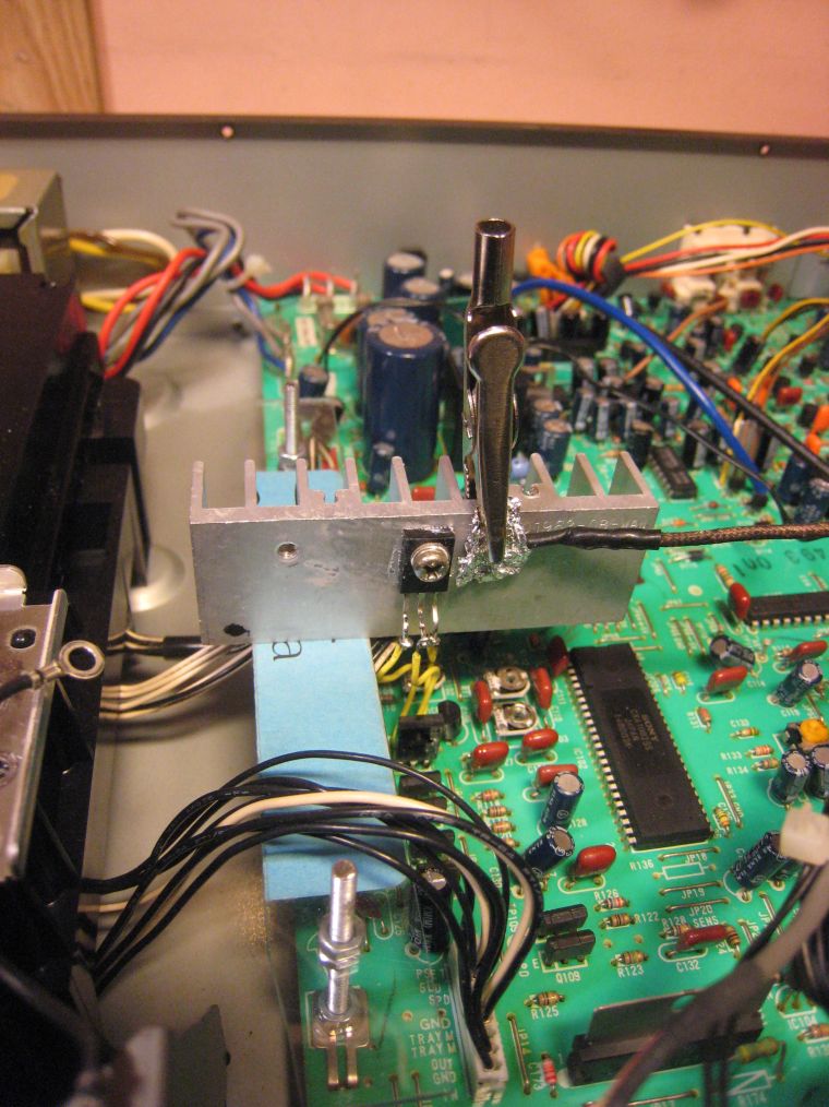

Since there`s no way to give it a sensible heatsink while it`s mounted on the pcb, I decided to lift the transistor above the board, attached it to a temporary heatsink fixed to a piece of wood laying on the player and put on a cd. With proper cooling the transistor was sitting comfortably at 29C. I used pieces of 4mm threaded rod, some nuts and a piece of acrylic as a support for the final (I believe) heatsink. It`s still a work in progress and I`m testing the player, but right now the transistor does not go above 44C with top cover on. I can live with that.

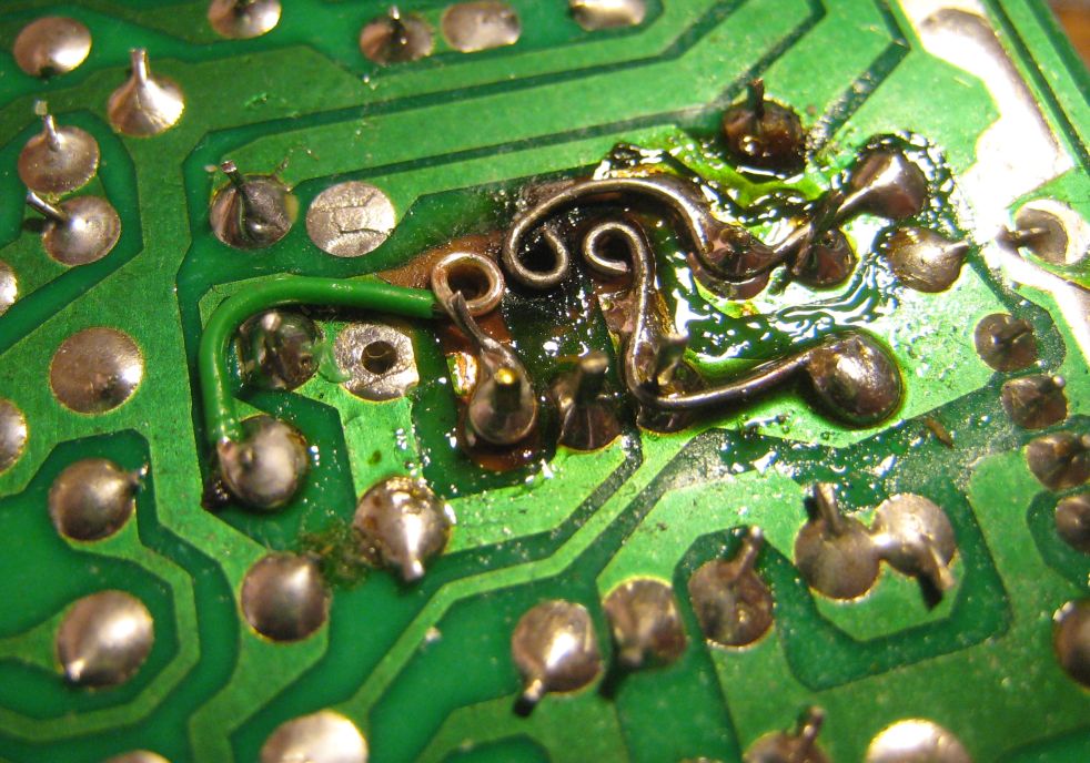

I`ll attach a couple photos so you can see things I do to keep my NAD going: on the first one is my first attempt at cooling, with that piece of aluminium the transistor was at 75-80C. See these 4 dinky transistors on the leftt? The original focus transistors were the same. I`m amazed they did not combust. Second photo: I had to patch up the traces and pads since I lifted them by accident. They probably were weak from the constant heat, all it took was a delicate nudge. Meh. Third photo: test heatsink and thermometer readout, fourth: the final (I think) arrangment. The leads need shortening, but mostly for cosmetic purposes, their length does not seem to affect the operation.

Suggestion: solder that TO220 transistor from the underside of the PCB, and bolt it to the bottom of the CD player metal case. With a bit of a luck, the transistor leads will be long enough -> no need for the "extra" hook-up wiring, nor the heatsink.
Interesting idea, but I think it would be rather hard to implement with not much to gain, if at all. I`ll tidy up the existing set-up, put the cover on and no one will know 🙂
By the way, it turned out that my meddling with the position of the platter did not do much good, quite contrary: the cd started skipping occasionally. After a couple unsuccesful attempts to reposition it I came up with a simple rig that allowed me to pull the platter up a fraction of mm at a time, pushed the platter down as far as it could go, then pulled it a tiny bit up at a time until I found the sweet spot. The NAD works nice now, laser replacement I bought is still in its box, case closed, I hope 🙂

Better do, and make them stand above the board like I did. See pics for reference. Of this pair only one gets hot, most probably because of design inconsistency: early units had different laser pick-up, Audio-Techica AFAIR, which probably was contructed differently and utilized both transistors, not one like later Sony pick-up. Note: check which one is in your unit, not that it matters much, but with Audio-Technica your focus servo might run cooler.
