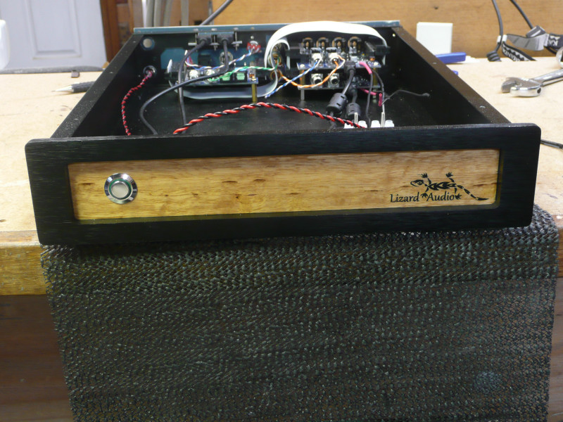

I have an illuminated switch on my DIY MiniDSP the illumination runs on a 12v supply, how can I dim the light? Add a resistor?

The resistor in series wih the LED limits the current.
Unlike a filament bulb the LED always drops a constant voltage and that voltage varies with the colour of the LED too due to the physical properties of the different materials.
A typical value would be say 5 milliamps. Modern high brightness types are very efficient though, so thats a ball park figure. 50 milliamps would be an absolute max before damage occured, again a general figure.
So to dim the LED you add more resistance in series with it. On 12 volts you would calculate it as 12 minus the volt drop of the LED (say 1.7 for red) and use ohms law knowing what current you wanted.
12-1.7/5e-3 which is 2060 ohms for 5 milliamps.
For your LED I would use trial and error as its the only way to get the brightness where you want. You might find even 10k or higher is needed if its an efficient LED.
