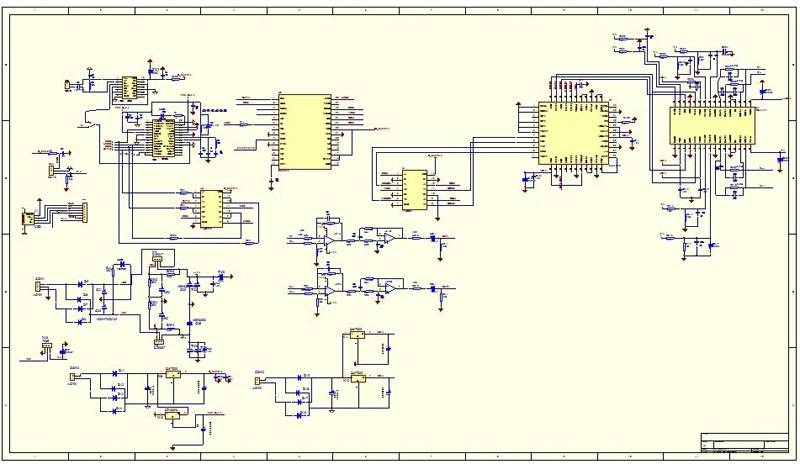

Judging by the barely visible schematic, there are 6 Regulators on board: LM317/337, LM7812/7912 (or LM7815/7915) and LM7808 and LM7909...am I right?
Following is what i found ( measurements )
LM317 = 7 vdc
LM337 = -6,4 vdc
LM7805 = 5 vdc
LM7905 = -5vdc
LM7805 = 5 vdc
LM7805 = 5 vdc
? = 6 vdc ( this one i can't see because a coolingsink is blocking the view, it must be a LM7806 )
😡 ...arrggh, i just found a loose connection = bad soldering for one of the terminals
I think you should measure all voltages on all the chips to see if they are within specification ... be VERY careful not to make a short circuit. Consult datasheet to identify exactly on which pins you need to measure.
Which schematic are you refering to ? I would like to see this schematic ...please ! Link ?
Okay i'll try that if i can find the different datasheets !
Also this one with the BOM ·ÉÀûÆÖTDA1547¶¥¼¶½âÂë°åÌ×¼þ TDA1541Éý¼¶°æ±¾ Ë«±¶Í*³Á½ð°å-ÌÔ±¦Íø
btw, this is what I bought for Christmas🙂
I just made the measurements again around the non visible one which is a LT1085-3.3 ...and it seems i missed the output ...the right voltage is 3,3 vdc.
