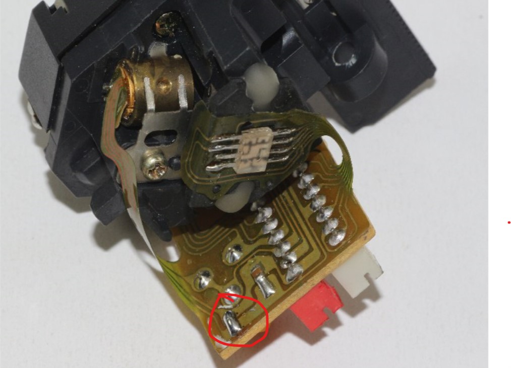

If this is a common KSS type pickup then did you remove the static protection shorting link (typically a solder blob)?

Alas! I tried just now (couldn't find the time earlier), found the blob, undid the connection, and tried. Regrettably, it takes in the CD, I hit start, the display shows ">" but after a few seconds changes to "- - : - -". However I noticed a sound coming from the lens positioning motor, just before it changes to "- - : - -". Out of frustration, I gave the CD a spin with my hand. It resisted but then started spinning the CD! only to change into "- - : - -" after one or two seconds. This must however mean the spinning motor and drivers are intact. It seems it somehow "thinks" there is no CD. Any thoughts?

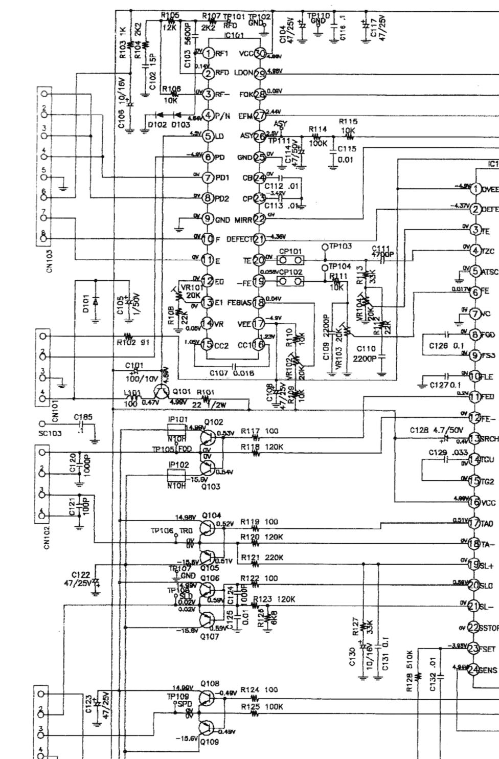

Thanks you all! I found the service manual and schematics. There is a trouble shooting / fault tree in the manual. I'll use it. It points to either the power to the optical unit or the transistors driving the lens movement, as far as I can tell now.

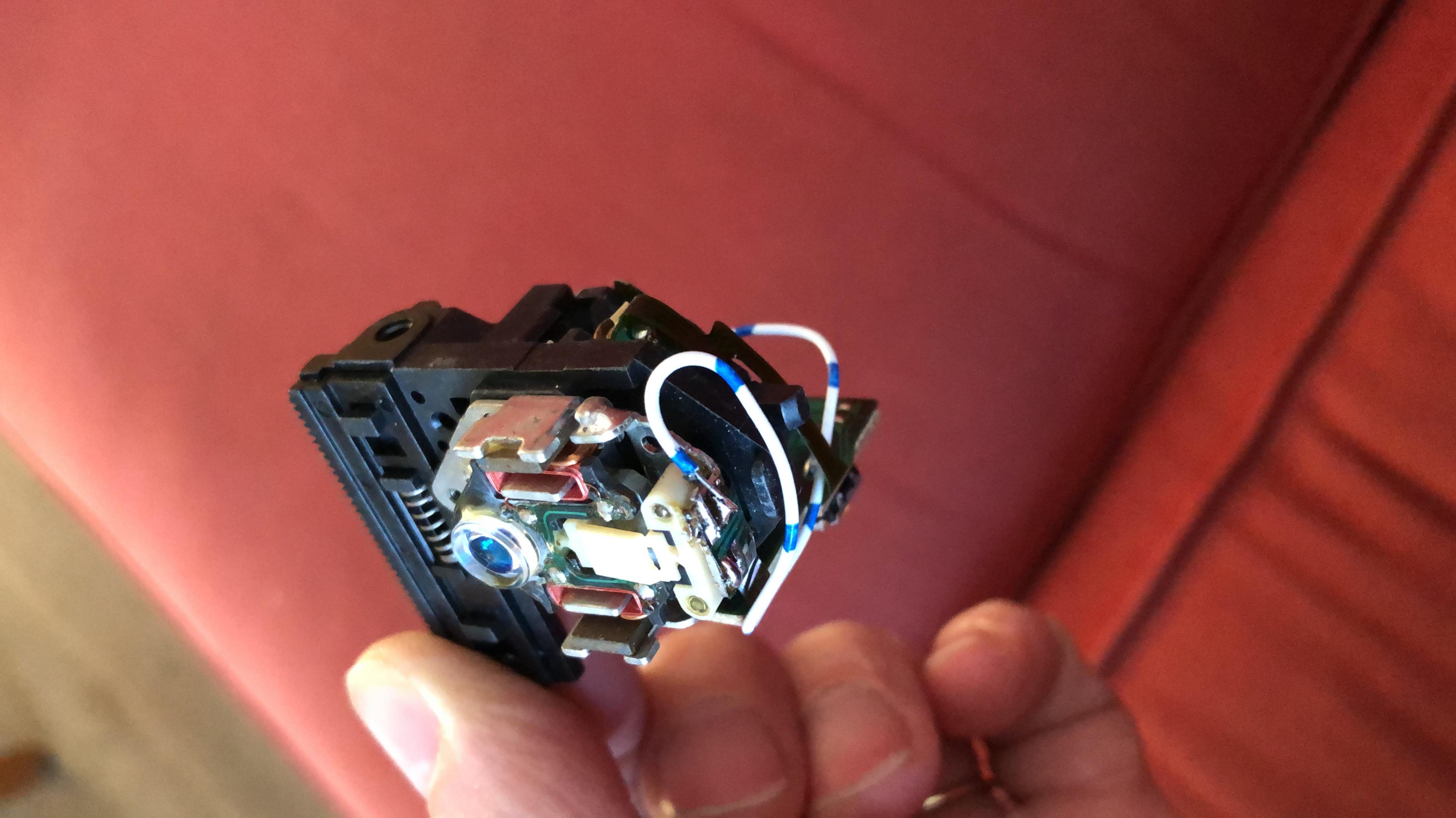

It's really resisting repair! Yes the laser lights but it does not focus, I mean the lens is not moving. I removed the plastic protective cover and found out the 'new' pickup unit is actually not in a very good shape, the connecting strip looks rusted or weathered. Now I checked the voltages of the transistors driving the tracking mechanism. There are 2, one labeled FOD, the other TRD. FOD does change, from 0V quickly up or down, to fast for my multimeter to display but it changes, some volts. TRD does nothing. The lens however does not move. I disconnected the connector at the pickup side, sprayed it with contact fluid and reconnected (I even put the 'antistatic blob' back for this operation). Laser still working but no coil movement. I am beginning to suspect the pickup unit. Any suggestions on how I can test it?
Try measuring the continuity of the focus coil... it works just like a speaker coil in a magnetic field.
I would also imagine that a DVM on the diode range might have enough current to actually move the lens. You should be able to do this test with it all in circuit. Just switch the player off and check the resistance from FOD to ground. That should be the coil resistance. Now try the meter on diode range and see if the lens moves.
You can do the same test on the tracking coil as well.
It’s all quite puzzling: I found out that one of the coils was not properly connected, because of the crappy flexible print in the lensunit, I bypassed it, now the connections, measured from the connector which connects to the main board, were OK, I tried and it worked! But only for about 1 minute! Now, if I put in a CD, it starts spinning, recognizes the CD, shows total length etc. in the display, but stops afterless than a minute. My gueass is the lens unit is poor quality. I tried the old one but that one has another problem. I decided to give up (very hard decision).
You've done well finding the break and proving there was a problem there but it does sound a bit like that pickup has other issues if it still won't play 100% correctly. The 'rust' you mentioned earlier could mean the optics have been affected by damp/condensation.
