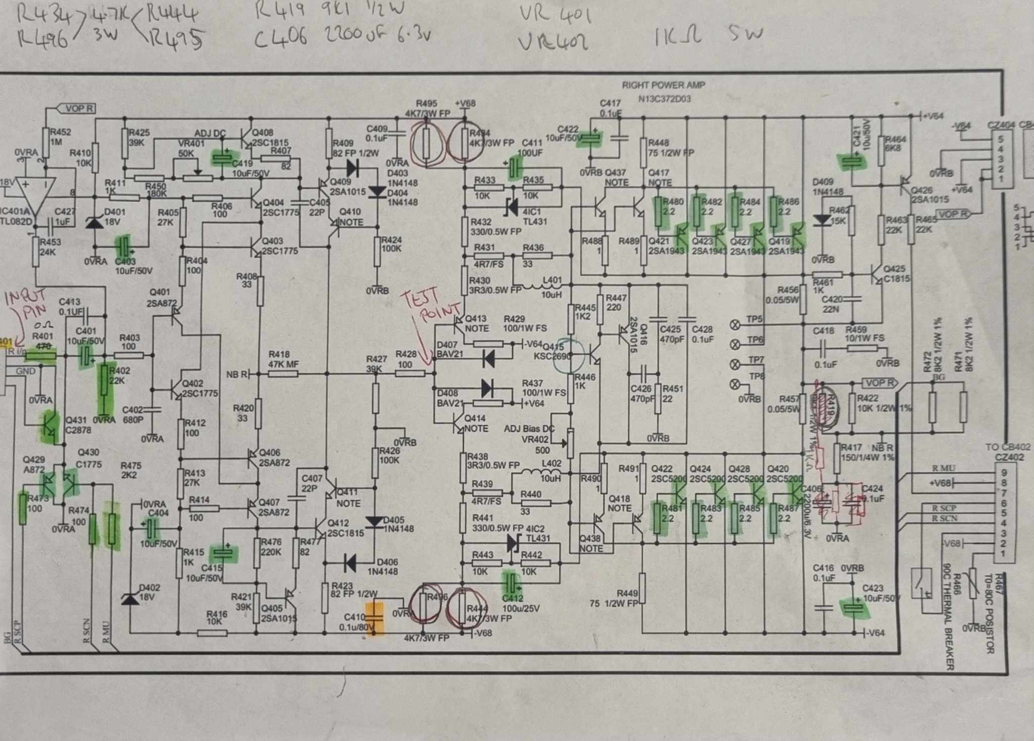

The current issue appeared as no sound from the right channel. The Pre-amp stage on both channels worked fine, and transposing the L/R preamp signal worked on the good (L) channel. The input of the (R) amp module was attenuating/pulling the signal low. Removing Q429, 430 and 431 solved that issue for the moment, but the signal is not getting any gain before the output transistors.

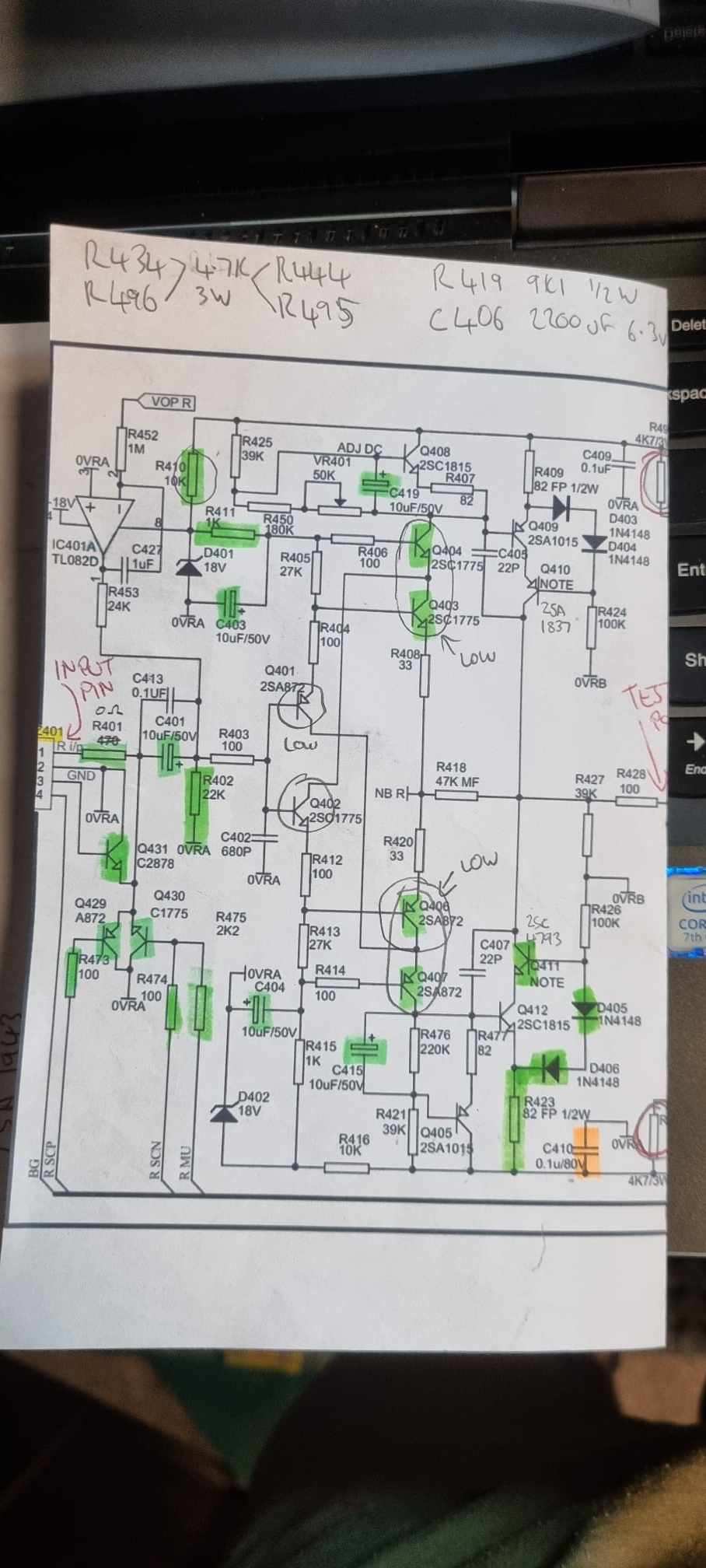

Tracing through the good (L) amp module, I found the preamp signal gets amplified at Q410 and Q411. This is not happening on the (R) channel, I removed and tested Q411 and it tested fine in my TC1 tester. The only other thing I've noticed is the +/-68v rails appear to be 69v/73v...
I'm sure I've missed out a few details. but if anybody could look at the diagram and shed some light as I'm often puzzled by what things do, as there seems to be no explanations of the operation/block diagram.

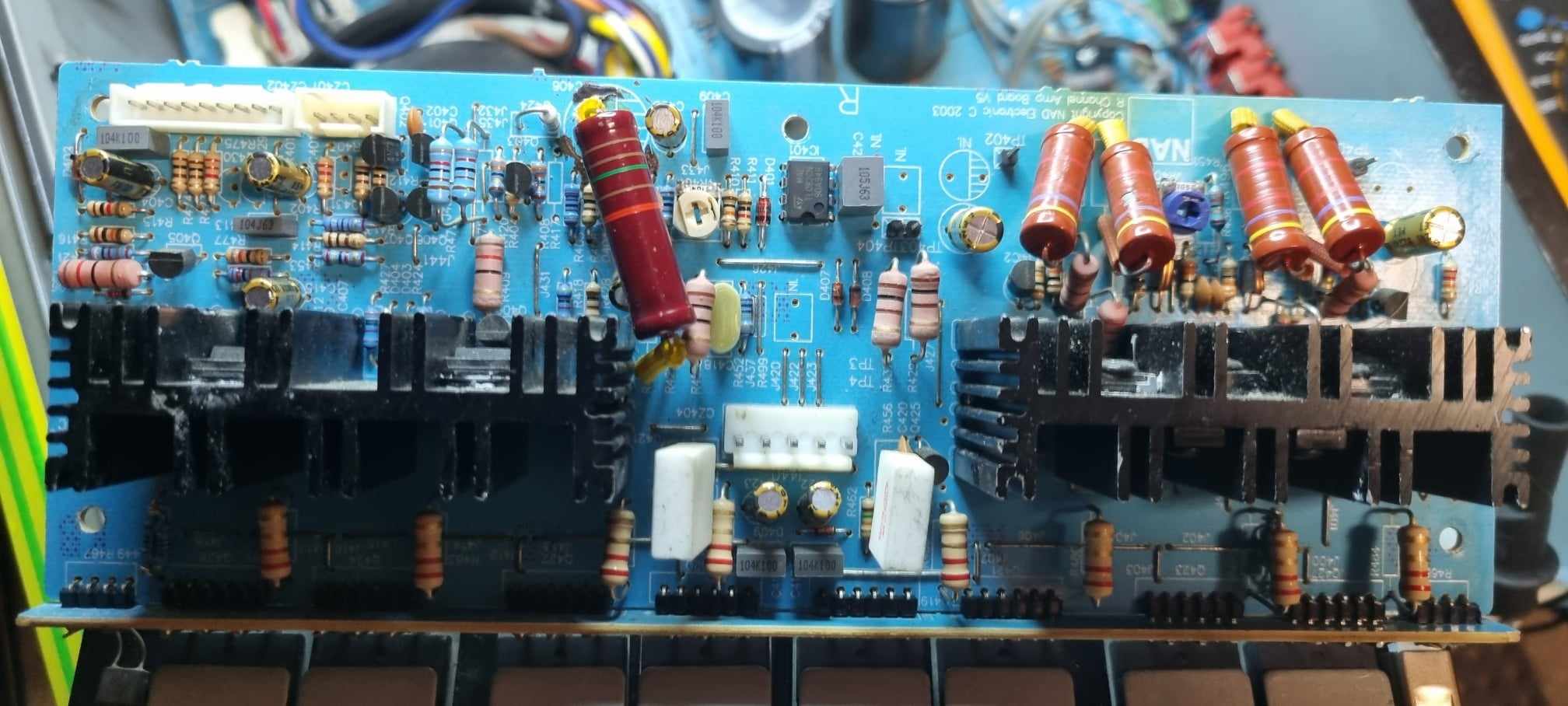

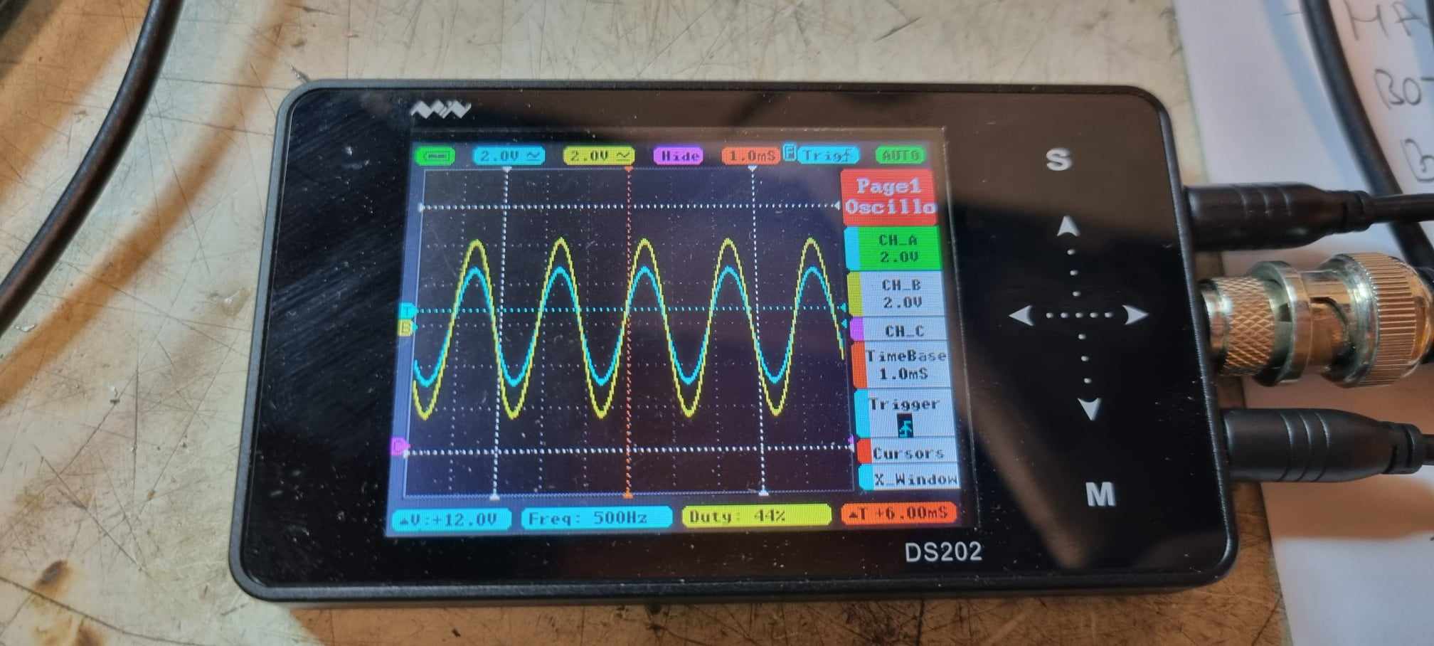

The photos show The input/VOP almost being the same on the scope, the full circuit diagram, the half that seems to be playing up and a photo of the PCB.

If I understand correctly, you have comparable probe connections on input and on VOP R terminals. In other words, the amp is showing abnormally low gain? Which trace is output?
The signals look clean, which is good news. Is output at VOP R showing 0VDC, i.e. no offset error? If so, also good news.
AC gain is set by R419//R422, R417,C406//C424. If you probe the junction of R417 with R419, the AC voltage should be about 3% of the AC voltage observed at VOP R. (This sets the AC gain of about 34.). There should be very little voltage at AC at C406; an open C406 might be the reason for low AC gain. The NB R should appear at junction of R408, R420.

Thank you Steve! Some of the sections of these amp circuits puzzle me...what the hell does that do?
The blue trace is the input pin of the amp module and the output pin is the speaker binding post. So there is gain, just SFA.

If you look at the diagram I uploaded, you can see where the amp was modified (I had some crazy old guy repair it when I couldn't stop it popping) and he insisted on modifying it.
You will see that he removed c406/c424 and replaced it with a pair of resistors in parallel, they measure 33ohms total.
He then removed R417 and R419 and put a 1k 5 watt resistor between the aforementioned 33 ohm resistor and the junction between R419/422.
He said it was to give it a 'More cass A sound'. I dunno. I think I want to return it to factory. What do you think?

As you asked I probed VOP R and got 0.496vac (when idle) and 1.042vac at R419/422. With a 500hz sine input both were about 0.475vac...
The voltage at NB R is 1.027vac...
So does that c406/c424/r419/r422 control the gain in the first stage of the module, via IC401A via the VOP input to IC401A?
Sorry for all the questions, there doesn't seem to be many resources explaining in a block diagram of the relationships of the sections and how they affect each other...you kinda just gotta know I guess!
SFA? I don't know that term. A gain of about 1.3 by my old eyes--- seem about right?

I was concluding that he had probably revised both channels. I don't see anything wrong with his mods, Basically, he eliminated C406. Electrolytic caps have a bad rap in in that particular circuit spot. I'll try to explain details later. (BTW, are you familiar with the concept of Thevenin Equivalent circuits?)
His mod is theoretically sound, but he could have achieved the same result by simply shorting C406. The 5 Watt resistor may be a bit undersized. But it's likely to fail to a higher resistance that would raise gain rather than lower it.
None-the-less, I would carefully test the 33/(1k + 33) voltage divider. It has to present the correct attenuation ratio to produce the intended amp gain. Also confirm R417 value and path integrity back to R408,R406. If this network is not the culprit, we'll have to track down some other defect.
The servo opamp has low speed and sets the DC bias of the amp output to nominal 0V. Would you report the pin 1 voltage?

So, one of his mods that I completely forgot, was to replace R417 with a 220uf cap. At some point I removed this to improve access to removing other components and forgot. I reinstalled it and...I was greeted with sound, enough to let the smoke out of my little test speaker...whoops!
So the original problem was dead IC401 and D401, which I replaced but forgot to replace the cap, so I was tearing my hair out.
I resoldered Q429/430/431 one by one and everything works fine. So the R channel is now ready for restoration and calibrating (the crazy old guy seemed to like rats nest style circuitry).
However, when I probed the left and right channels I noticed flattening of the sine wave every 180 degrees on the L channel. I traced that to the preamp...that should be easy.
