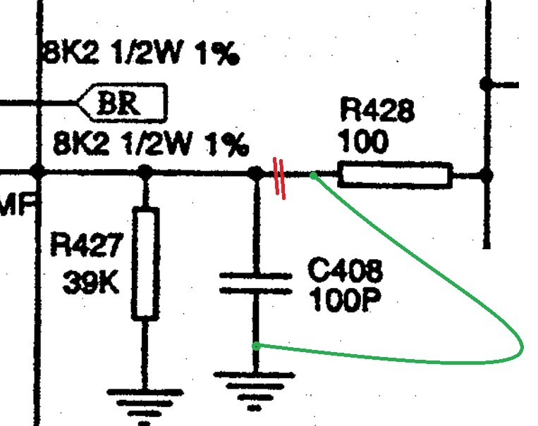

If you would lift the leg of R428 (the side that is connected to the pre-driver) then take this leg and jumper it
to chassis ground (as per @floriant suggestion) this should simulate a "good" pre-driver stage with 0V DC noise (offset).
Then measure VOP R to see if the value is in the <100mV range rather than 2.5V [2500mV]
If <100mV then the driver/poweramp stage is clean for offset and you can concentrate on the pre-driver (comparator) stage.

Victory.
Its was one bad power transistor.
I retested with transistors tester and one 5200 was bad.
Thank you very much.
Amplifier works fine after replacing and bias adjust..
