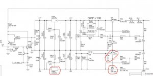

When I had a look at the amp, the +/- 55V rails were OK but the -26V and -18V rails were not- just a few tenths of a volt.

I looked at the supply circuit and measured some voltages and ordered some parts for wwhat I assumed was the regulator circuit for the -26 and -18 rails.
See pic below.

At first, I was getting too high voltages on the -26v rail (in the 40s).
The PCB traces in this amp are really delicate and once I had a good look with a magnifier I realized that the pad was missing from one leg of Q44.
Adding a jumper got all the voltages correct and the amp seems to be working...for now.
It still isn't obvious what caused the failure in Q44/Q42 (?). I replaced the 337 for the 18V supply even though I thought it was probably OK.
I replaced C46 as it pretty much fell out of the board when I was unsoldering the adjacent transistor leads.
Do these regulator components 'just fail' without something else being the reason?
Anyway, not much play value when the first guess seems to fix the problem.
(Time will tell.....).

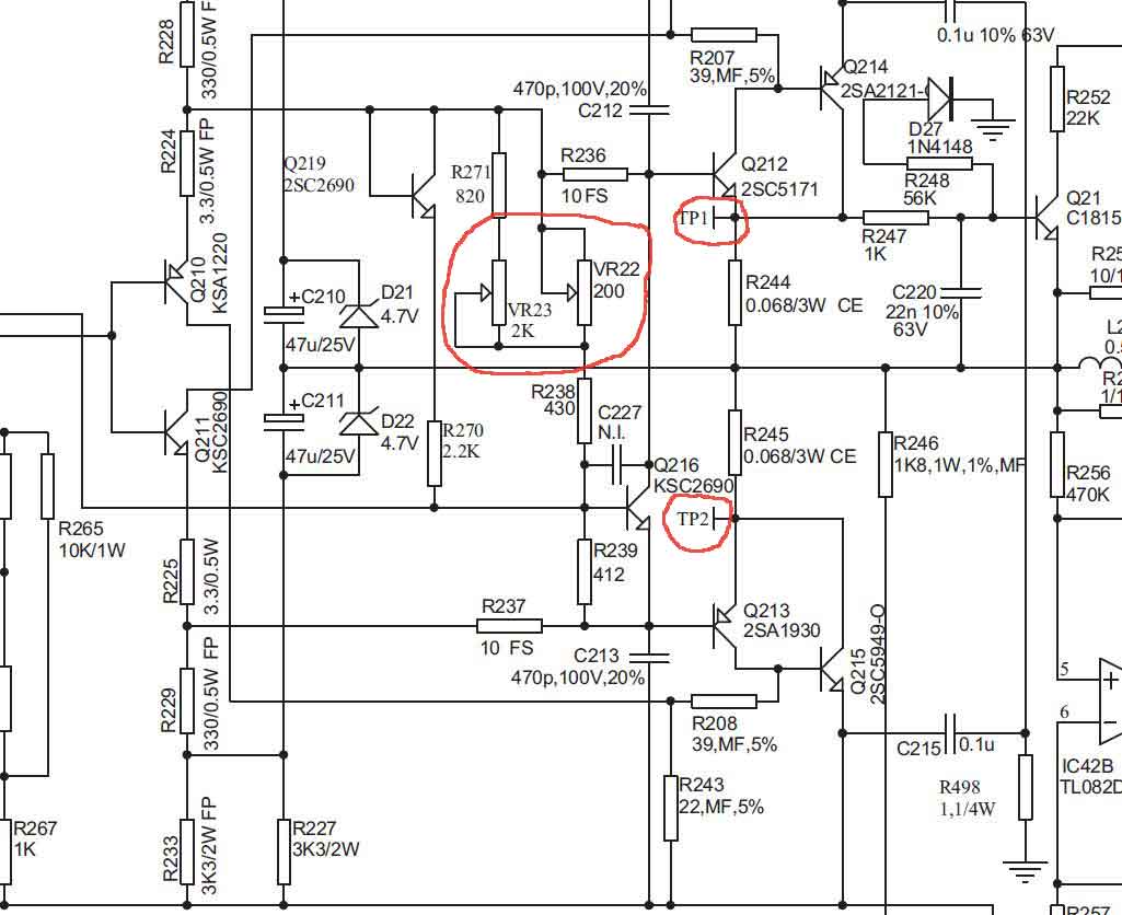

Flushed with success 🙂 I thought I should check the 'alignment' following the procedures in the manual.
Idling Current: Connect DC voltmeter to TP1 and TP2, adjust VR22/VR23 for 6mV reading.
Please see attached picture of the schematic in that area.
I'm not sure what the instructions mean. Am I supposed to measure the voltage between TP1 and TP2, or measure the voltage between ground and each of the TPs separately?
One combination (TP1 and VR22, measuring voltage to ground) adjusts easily but the other (TP2 and VR23, measuring between TP2 and ground) doesn't seem to be adjustable- it's just sitting at 3 mV.
I'd appreciate any help on the alignment issue.

The amp idling current setting like this :
Setting the VRs and measuring the voltage between TP1 and TP2 to the requirement, no need to consider the polarity of the probe, a +6mv or -6mv reading is ok.
There is 2 amp channels, so that you adjust VR22 and VR23 and measuring the voltage between TP1 and TP2 and then adjust VR12 and VR13 and measuring the voltage between TP3 and TP4.
If you need adiust the idling current, try adjust VR13 and VR23 only, do not adjust VR12 and VR22 first, if the first VR(13/23) can not set the value then adjust the second VR(12/22)

Umm-mm 🙁.. This is on point, but I'd suggest adding one little thing.
If you hit the peg on VRx3 (Fine adjustment), center it before moving on to VRx2 (the Course adjustment). Then you only have to get 'in the neighborhood' on the Course, and the Fine will still have enough control range to polish it.

The amp adjustments were already pretty close to specs, so it wasn't tough to tune that idle adjustment to 6mV.
Thanks for the hints!
