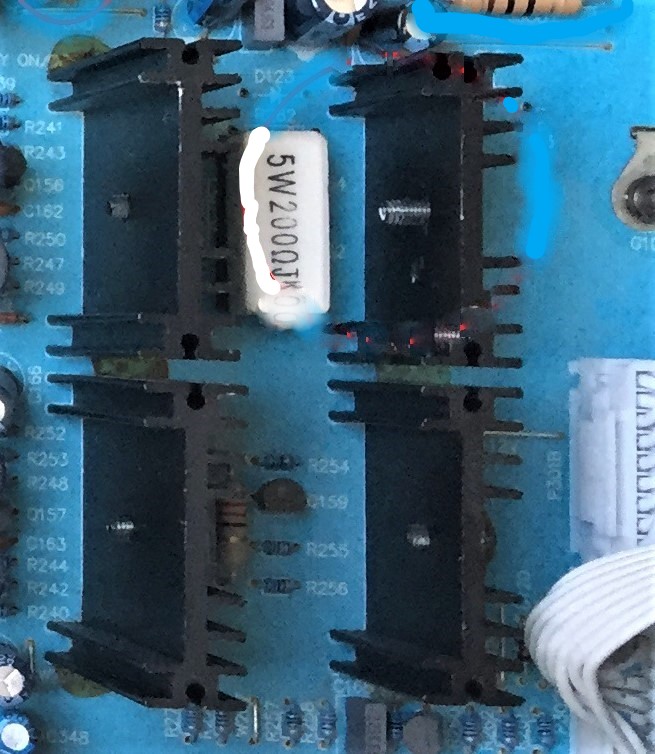

I came across a web, one of the photo showed the C352 mainboard,
there is a 200 ohm 5w resistor in the middle of the 4 heatsinks,
you can check if that is the R245,
suggest you post a detail photo of the inside,
so members can know more about the amp.

I just learned how to insert link,
here's the photo link, it is one of the three images.
But again the link can't be shown here,
I've edit the photo but don't know how to post it here.
suggest to use a 5w 200r to replace R245 temporarily to locate the faults,
change it back to 33r 0.5w when everything fixed.
