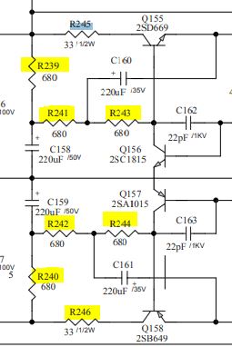

I'm thinking Q155/Q158 are the ±18 V regulators. They're on the bottom of the power amp schematic. I bet the +12 V "regulator" is the voltage divider formed by R254, R255 and emitter followers Q159, Q160. They're fed from the +18, so once you get the ±18 V rails working, the 12 V will probably spring to life as well.

Check all theses r680r and the opposite 33r resistors I highlighted. In my experience, these 680r go high, usually 1-2k and it causes excessive current on these 33r resistors and triggers protection. You can check them in circuit if you can get to them, you are just trying to verify if they are open or high resistance.
Check those 680r resistors nearby, there had to be a reason that zener died. R247, R249, R248 and R250
