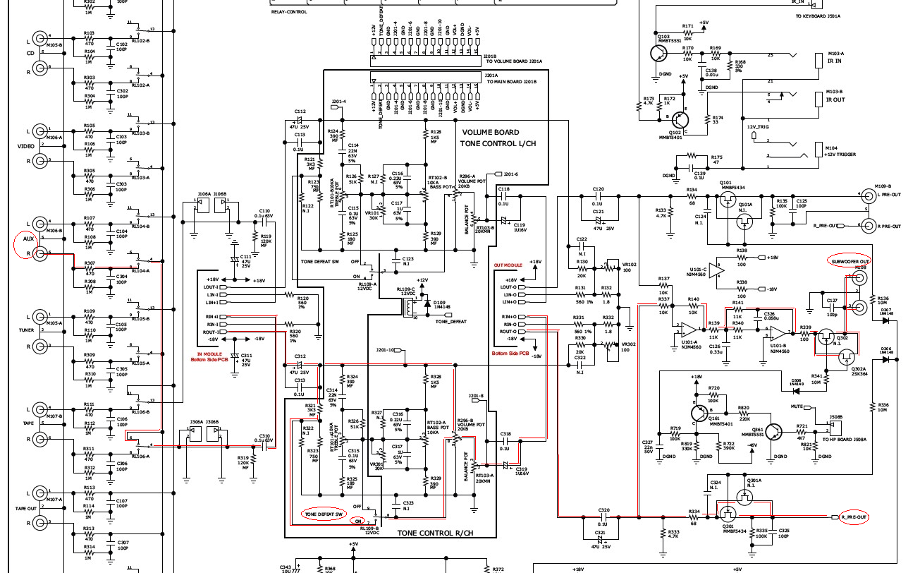

The right channel of my NAD C326BEE is dead.
Main amplifier works fine on two channels.
Pre amp with headphones or speakers no right channel.
No music,but very great cracks.

Follow the red line.

Hello.
I recived my audio tracer.

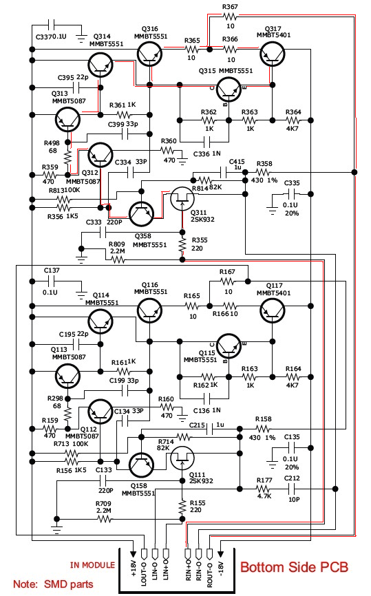

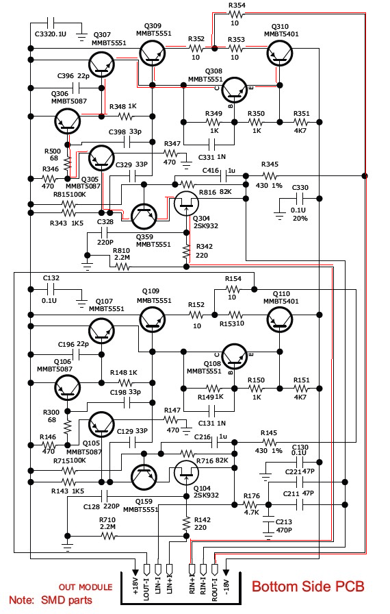

The signal stop and cracks on C320.
I verified​ out module,signal stop on collector of Q359.On base and emitter signal is ok
I replaced Q359 it's ok,good signal on collector,good signal not cracked on C320 but 2 min later the same situation
Nothing on C320, nothing after collector of Q359.....
18v ok.
I desoldered the q359 on little China DAC 5V it's was marked G1....i think it's it the same MMBT5550LT1G.
