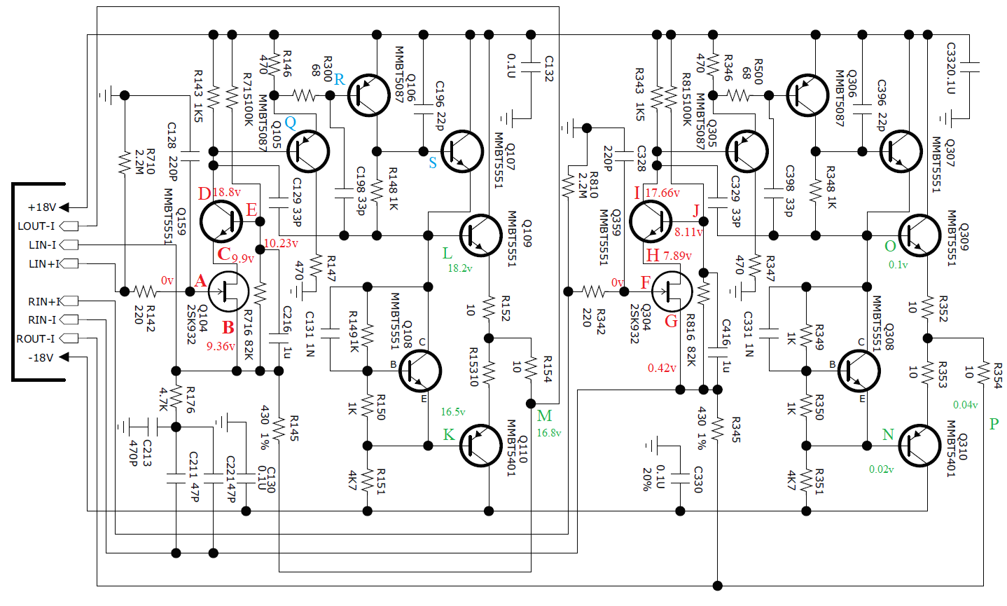

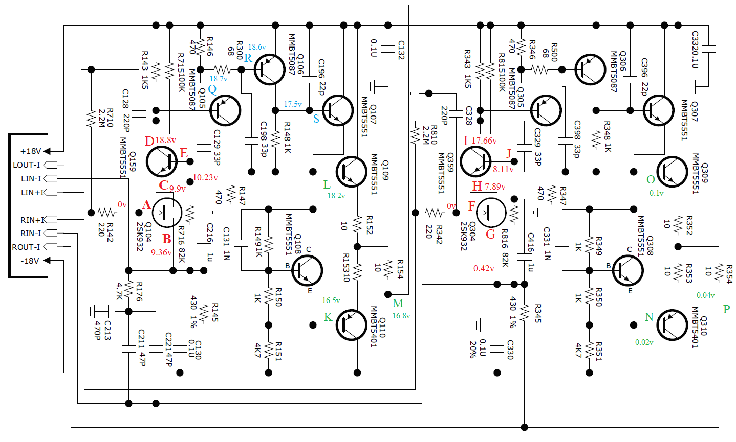

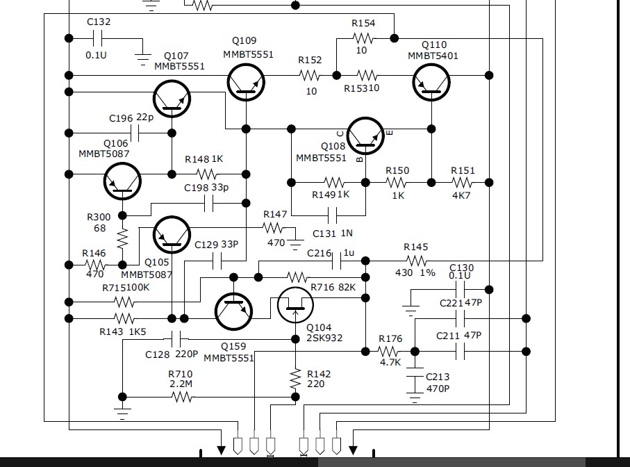

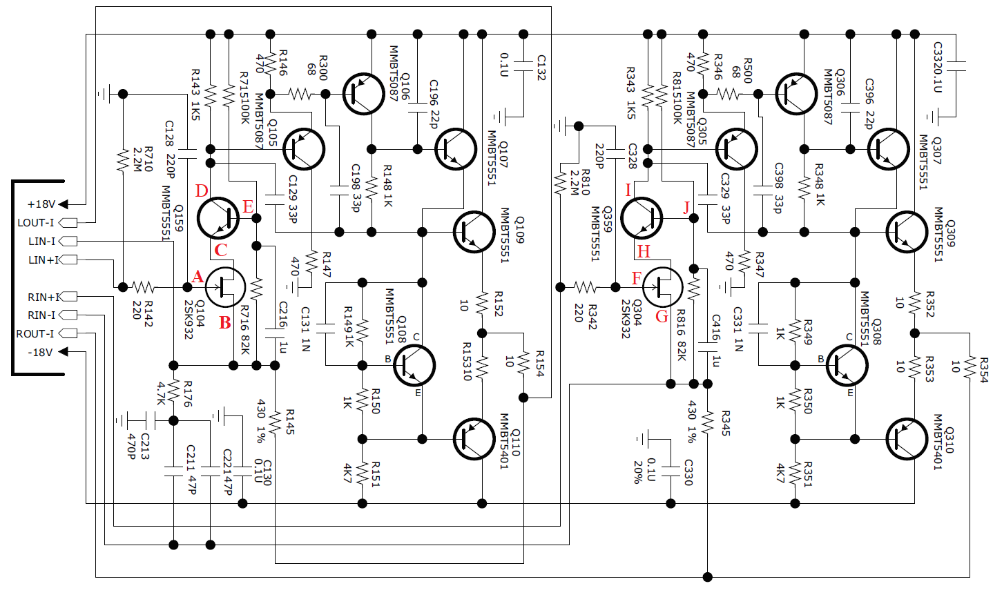

Nad C326BEE left channel pre amp problem
