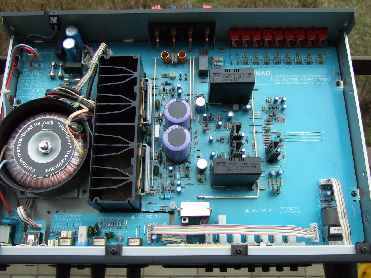

Could you help me determine the location of the MOSFETS so I can attempt replacing them ?
Some basic instructions written or drawn over the attached photo would go a long way for me.
Thanks in advance , I hope you find the time to help me. Cheers !
Hm, the internal layout doesnt look like whats described in the C320 service manual!
Check for the blown fuses. If they are blown, it is likely one or all of the output transistors have failed - these are the 4 square devices on the large heatsink to the right of the power transformer. The service manual says these are 2SA1943/2SC5200 (very popular in amplifiers), but your picture suggests they are not. I'd want to see the correct schematic before advising further.
Hi. The 5A fuses are blown and got blown again after I replaced them and the amp is still playing distorted and barely audible ,same from L and R. channel. Also, pictured in the photo is a C300 not a C320 .
