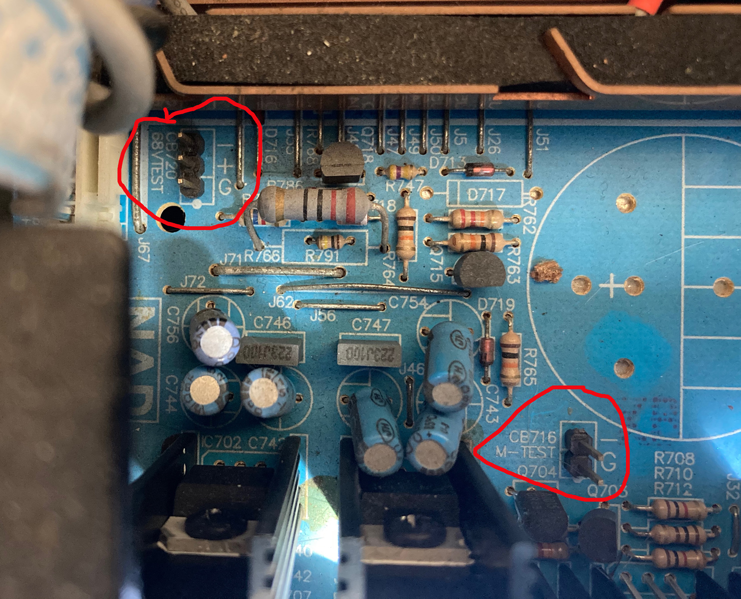

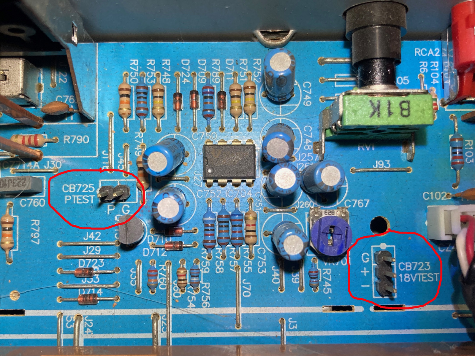

Ok, with that preface out of the way, the problem I have is the unit simply stopped working. No noise or other problems; it just has no output. The unit will power up meaning that the LED comes on when the power switch is pressed and it still clicks as it always did but there is no sound. I assume this points to the power board. I've looked closely at all parts inside the unit and have found no obvious problems or evidence of high temps. Everything looks normal.
So I tested the main power supply on the power board and it checked out fine. +68.7v and -68.6v in the appropriate places. However, there are also 2 more sets of test poles, one labeled "CB716, M- Test" and the other "CB717, M+ Test." I could not get a reading from either of these. And what does the CB716 signify? Every test site has a unique CB number.

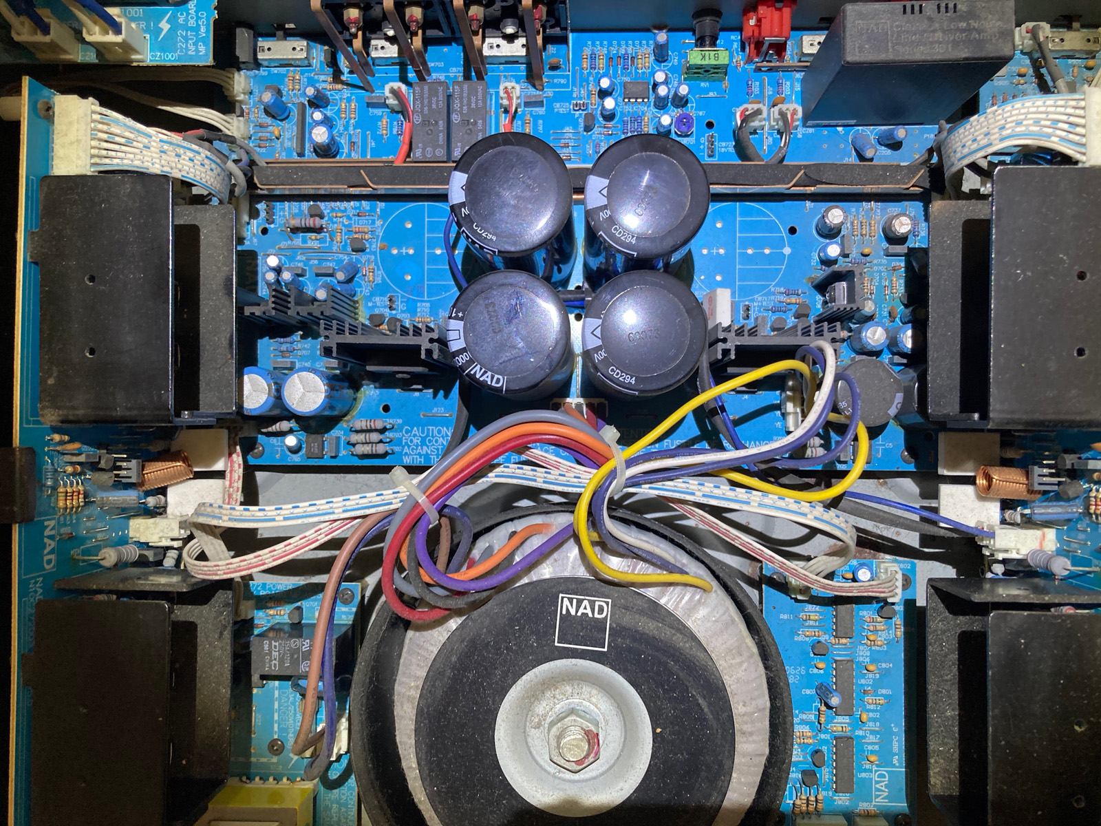

Here are some pics in case I'm not describing in appropriate ways:
Here is the overview with the power board towards the top and the large 4 capacitors.

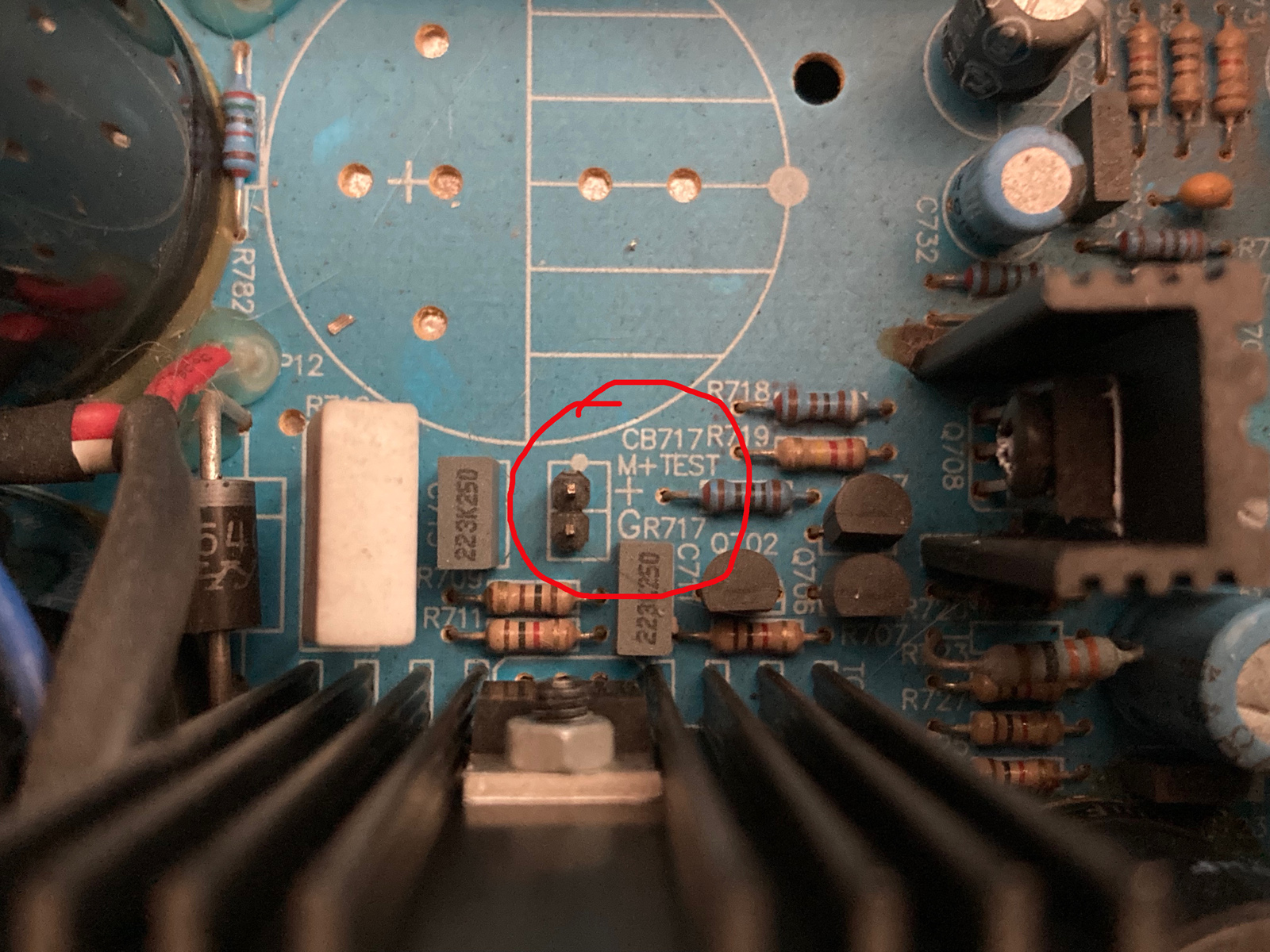

By the way, my power board is labeled as Version 5.0 as I guess there are different versions that NAD used to combat the capacitor and transistor issues.
At the top left is the site where I measured +68v and -68v so the board is getting the correct power. However, the other test site M- in the photo measured 0 as well as the M+ site in the following photo. I assume these should be -68v and +68v respectively but hopefully someone out there can help me in measuring the test sites properly.
I also measured the 18v (CB723) test site but again, readings were 0. The other site I did not measure as I'm not sure what it is. What is a "P Test?"

Well, after the main +-68 power supply, the next check would be the +-18 v supplies at C744 and C745. Those or feed C742 C743 may have shorted, or feed cap C738 C739 or feed cap C765. If the load caps 744 or 745 shorted it may have taken out regulator IC 02 or 03.
There is also a 5 v supply at C709 with feed cap C708, either of those caps may have shorted or taken out IC 01.
Load caps C750 or C751 may have taken out +-18.
There are 3 electrolytic caps around the protection IC05 that may have sent it into protection mode.

First, thank you to Indianajo for all the time and help, I definitely appreciate it.
Ok, new information on voltage testing:
I have tested all of the voltage test sites on the power board and nearly all of them test as they should. I could have sworn earlier I was only seeing a working +/-68 voltage and all others were dead but whether I wasn't making contact or there was no voltage earlier, now there is. So in addition to the +/-68, I also have +/-18, +/-64 in the appropriate test sites. I don't know where to test for the 5v as there is no test site. And I also tested CB725 P TEST and found 1.38v but I'm not sure what this is supposed to be or what it is exactly.

The instructions on what to do with CB725 are on page 3. Unfortunately you won't have a 4 ohm 150 w load, nor a 20 khz signal generator. So leave it alone. I don't even have a 20 khz signal generator.
I would check DC voltage on speaker jacks at idle silent. This is equivalent to TP2 & 5. Should be <30 mv they say. 200 mv in general. Adjust VR301 & 401 as they say. If greater than 200 mv something may be leaking somewhere and need replacing.
One thing that could have caused silence is oxidized connection on low voltage signals. With power off I would reseat 9 pin CZ61 from input board. I would spray out switches 705 A B C & D with contact cleaner from the lumberyard. CRC is one brand. Also the volume pot, probably RV1A & B. Warning contact cleaner is flammable, no smoking, open flame, pilot lights, turning electric switches on or off, within 10 m. Set up a fan previous to spray to dissipate the fumes. Test contact cleaner previous to use on cheap PVC plastic (not the amp) to make sure you don't have a brand that dissolves cheap plastic. Like a cheap toy.
Volume pots do wear out and have dropouts, so if you find this silence to be chronic you may have to change it. Usually one side or the other, not both at once.
Then before putting the case on I would check Idle bias current via procedure on page 3. Spraying out the idle bias pots could also be useful.

If DC out is <30 mv when protect LED is on, Then I woulld look at age of C754 C755 C 756 C758 around IC5. D718 can also fail, but you can check its forward continuity with a DVM. Electrolytic capacitors you could check with a $120 peak ESR meter after removal, but I prefer to use the calender test on electrolytic caps. > 10 years old, circuit doesn't work, out they go.
Blip noise is not a recognized diagnostic. Clicking of protect relay is. Should click in after power up delay, then stay in, no more clicking.
Thanks for the thorough answer.
I measured the DC offset and found .02v in both channels. I left the amp on for quite awhile measuring these numbers and it never went to protection mode.
Also, I measured via the speaker outputs and not on the amp boards. I would think this doesn't matter but I'm not sure.
Should I try measuring DC offset with some input from the preamp? And keep measuring as the amp goes into protection?
In alignment procedure, there is some voltage ranges. Measure the voltages, are they in the range or changing in seconds?
Like that; you adjusted the 30mv, when you start the amp. it may alternate to 100mv. if so, the amp. will be closed. Your adjustment must be less than 30ma.
This is the one of the way to go protection mode.
Ok, I also set the idling current as described in the service manual where it says to measure mv at TP1 & TP3 while adjusting VR302 for L and TP4 & TP6 while adjusting VR402 for R to 6-7.5mv. After adjusting, I reinstalled the amp and have been listening for a couple hours now with no problems.
The DC voltage went down slightly after this, down to around .015or so.
Not sure if this is affecting the protection circuit from blowing or even what the idling current even does but if it works, it works! Of course, I've been down this road before so we'll see....
It's been a few days now and the amp has been working well so thanks to Indianjo and others who helped me with this. However, one small problem I'm having now is that the sensing circuit isn't as sensitive as it used to be and when using the amp with TV and the volume is low, the amp will turn off. I don't see anyway to adjust the sensitivity so I'm not sure why the amp shuts off now with lower volumes when it never did in the past. Is there a way to adjust or solve this problem?
If not, I'm still happy that the amp appears to be working properly otherwise. I just like the sensing circuit since that means one less button to turn on and off.
