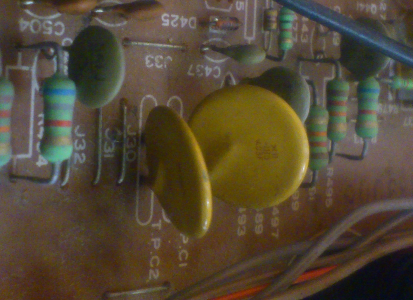

what are the P.T.C.1 and P.T.C.2 in the schematic (on the rails). I can;t find them in the nomencalture, not identify htem on the board. Are they these "wire links" to the main switch? Why have they a resistor symbol with a A value?

Without seeing the circuit my guess would be either thermistors PTC = positive temperature coefficient which is standard labelling.
Wire links across low value resistors are seen in some amps, the idea is you snip the link to measure the volt drop across the low value resistor and hence calculate the current.
Post a screen snip of the circuit 🙂
Edit I can see them in the diagram in post #1. They are drawn as thermistors but I suspect they are either "polyswitches" (which are like a bit a thermistor) which have a low resistance until a set current is exceeded and then they "flip" to a high resistance. Used as resettable fuse. Or they could be thermal fuses that go open circuit at a specific temperature. These are non resettable.
If you post a close up detailed photo of the part we could probably ID it for sure.

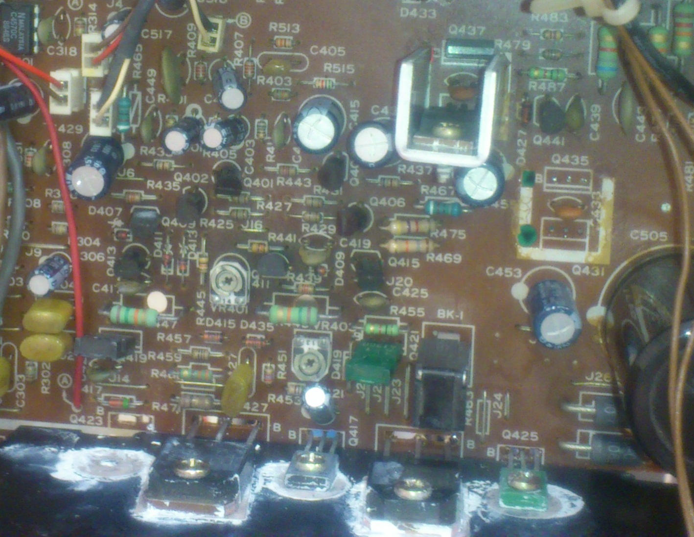

I think you are right they are thermistors used as cut-of limiters (see pic attched). At cold they measure as a short

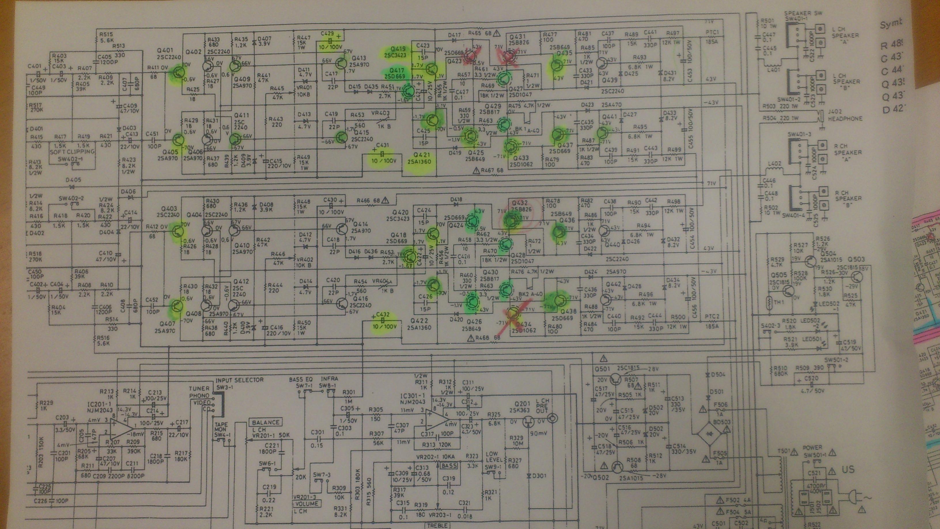

So far here is where I am:
I have tested OK the 4 mains caps (505/50 509/510) (DMM C function)
I have tested Ok the 2 diodes bridges (DMM D function)
I have --at my big surprise-- tested OK (DMM D function) the 4 outputs transistors 427 428 429 430
I have indentified 3 shorted transistors:
423 431 434
Their counterparts 425 433 424 432 426 were tested OK...I may change them eventually to match whetever I put on for the
faulty ones...
I have also tested OK 419 417 421 420 418 422
I have also tested OK 401 405 403 407 (and 409 /411 / 413/ 415)
And also 435 437 436 438
Note that 434 433 were BD911, no SD 1026..and 432/432 were bd912, not sb826....a/ they looked like "factory made" hence
maybe another revision from NAD and b/ specs are Ok i believe.
I have removed the three shorted ones, but the thing keeps blowing its 4 fuses (Amp section only, the preamp is fine)

Note that the PCB looks "roasted" in the areas around of q411 and q415 which I surprisingly tested OK (taken out, not

I also attach the schematics from HFE which is easier to read IMHO than this one.
I am thinking of removing the ptc1 and ptc2 for the next test...looking like it may help me identify the fauly aread of

Any advice as to "where to look next" would be much welcome! I must admit I'm kind of lost now...don't want to be

They are polyswitches, normally low resistance and when excess current flows they heat and suddenly flip to a high resistance.

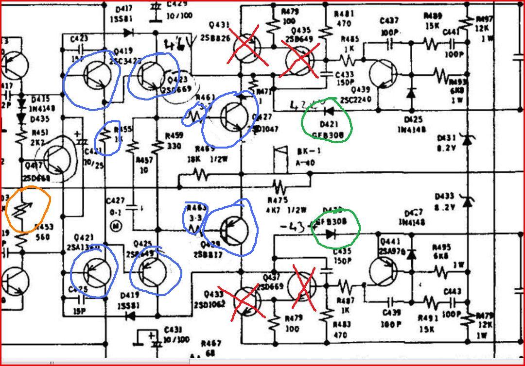

OK, it should make more sense as we test and check the amp. Tbh I would be looking at replacing several of the semiconductors but its good to go through it all and confirm the faults.
So first steps are to remove the high voltage switching transistors and their drivers on both channels. These are marked in red. These only come into play at high volume so the amp will work correctly without them and it can be tested in this condition. Out of circuit and they can be more fully tested but I would be looking to replace them with matched sets of newer devices.
The two diodes circled in green should be tested. These are "commutation" or switching diodes and are vitally important. They isolate the high and low rails from each other and allow the low voltage rail to power the output stage when the rail swithing transistors Q431 and 433 are off. If you wanted to replace them then something like the BY399 should be suitable.
The preset pot marked in orange should be turned to maximum resistance (giving 1560 ohms approx between B and E. This gives the lowest quiescent current in the output stage. Do that for both channels.
The six transistors circled blue (drivers, pre drivers and outputs) should be checked and replaced as necessary. Also check the two 3.3 ohms and 1K also marked.
That should give you a working amp minus the high voltage rail switching. When the amp is confirmed working and OK is when the rail switching transistors can be replaced and the rail switching tested and confirmed as OK.

I checked and replaced if required the Q427,Q429, Q425, Q417, Q423, Q431, Q435, Q433, Q437 - so they are all now ok. On power on (I am in a temorary house and cannot find my light bulb tester) on normal/4ohm setting and with soft clipping circuit bypassed (off) I get smoke from R465/467 then a flash and they're gone, usually with the RH 5A fuse - this leaves the output transistors Q427 and Q429 hot to touch.
I've checked the rest of the circuit with no apparent faults anywhere. From memory when I was testing with main driver transistors removed, the RH channel ones had twice the rail volatage on one leg as compared with the good channel. I started tracing this back through the circuit but got lost.
If anyone has any ideas from this info, or some guidance as to where to look next, I would be very appreciative.
Regards - AJ
In my case, I've had real trouble getting this one working. The right channel blows both the R465 and R467 rail 68ohm resistors and the 5A fuse.
Regards - AJ
Just discovered Q419 and Q421
Had shorted. I've ordered some and will report back when I get them. - this thread is a great benefit to those working on these amps.
That was it - Q419/421 replaced and system was ok. Like an earlier poster - and I've done this twice now - while doing final checks and adjustments - one slip of the probe and I had lots if magic smoke from the good channel - so had to rebuild both channels. All done now - adjusted and playing nicely. Thanks again to the great info from members in this forum.
