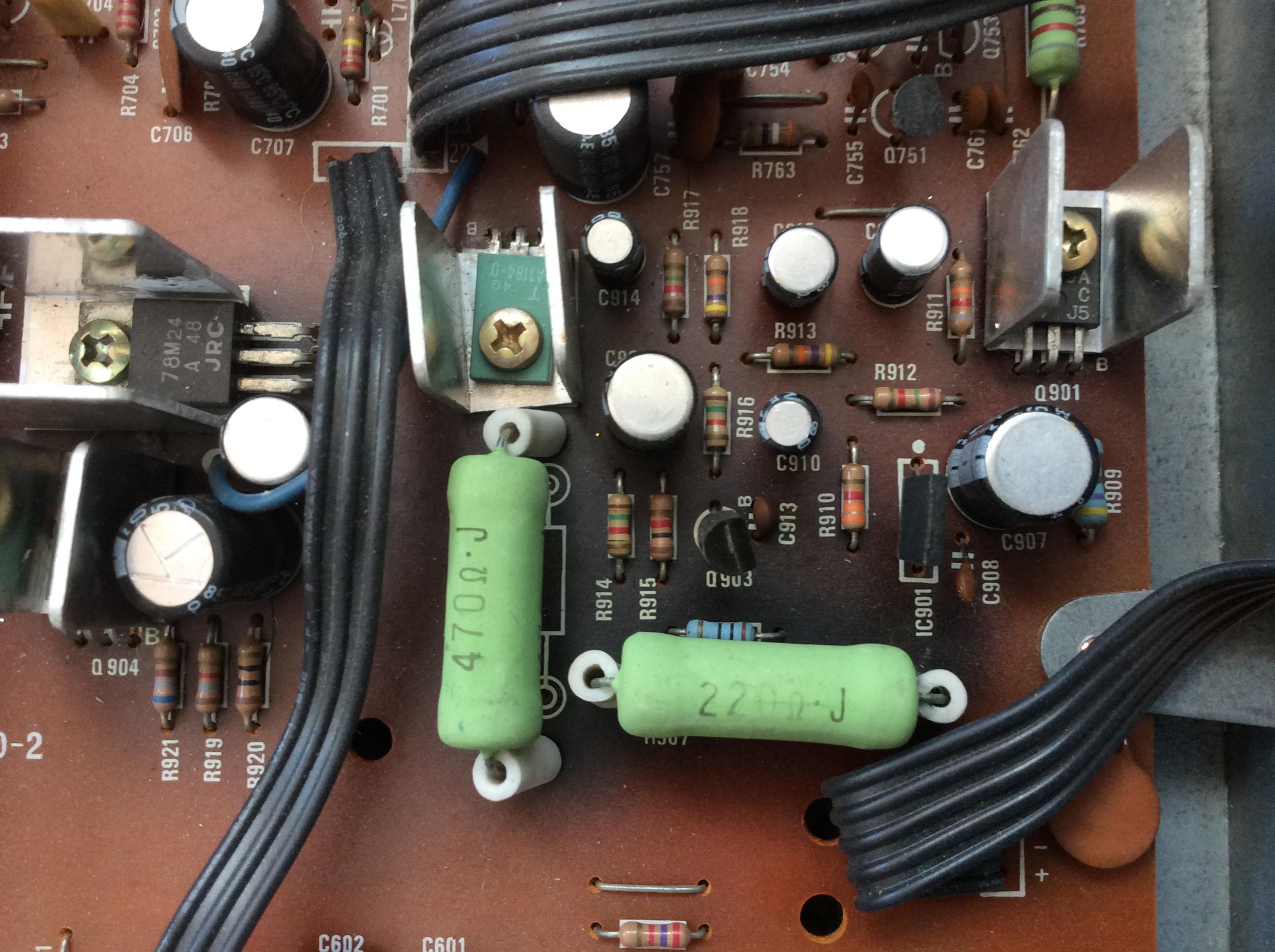

I’ve gained access to the amplifier board and find no swelling or leaking on any of the mentioned caps, but there is some scorching of the board in the vicinity of C907(photo attached). The center of the scorched area is at Q903.
I have a donor 7155 amp and the amp board looks very clean and no sign of overheating. The mentioned caps have been removed from the donor board ready to swap into the faulty one.
Should I address any further components in the overheated area?

Swelling and leaking are only two of the visual clues.
Lack of this won't tell you what condition they are really in.
Don't use second hand parts to replace second hand parts.
Especially electrolytic's that come from the same age and model of unit.
If it's worn out in one, it will likely be worn out in the other.
That picture shows the bulk of the caps as heat stressed.
Shrunken sleeving.
What happens to an eletro when you subject it to prolonged high temperatures ?
As JonSnell said, hum will (normally) be result of failing main power supply filter caps.
It's far cheaper and easier to outright replace them rather than muck around removing, testing, reinstalling.
Spend the $50 on quality new caps.

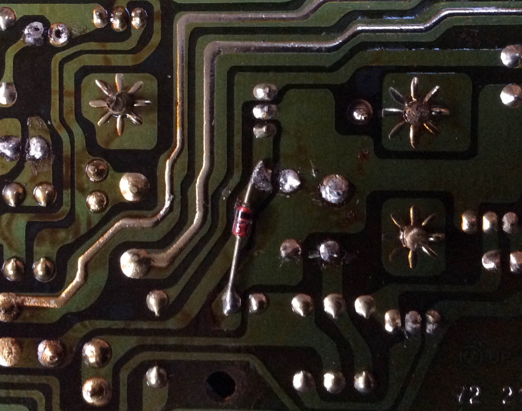

Apparently someone has soldered a diode across C917. Photo attached. I have no idea why, maybe it is a band aid for a problem? Is it related to a problematic cap that I am going to replace or something else?

Diode. Remove or not?
Just purchased a dozen caps from Mouser and included replacements for all the 9xx caps in the scorched area.
The donor board that I have is very clean and all components intact.
Any help would be much appreciated.
Peter
Could be a running change from the factory.
Then there's it being a nad.
The schematics do not always match the unit on the bench.
For some models there may be 3 or more different schematics for the same model.
Personally I'd leave it as is and just replace the caps.
Don't forget to go over the whole board for bad joints.

The identical donor amp does not have the diode, and my knowledge of why it would be there is nonexistent. Or how it affects the circuit.

Unless your going to reverse engineer the thing, don't worry about the diode or other differences.
These changes just 'are'.
In short, stop over thinking it. It will drive you insane. :)
