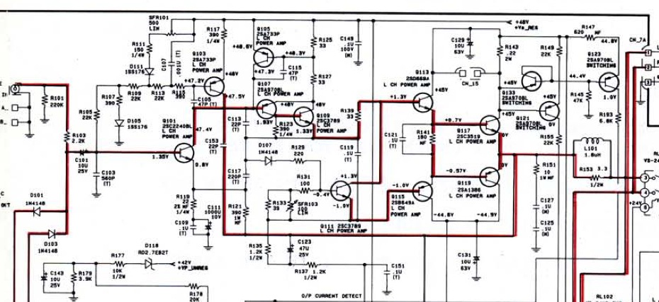

At that point, I have no idea where to check as I can't get it to play up again. Both channels had a similar looking output when the amp was faulting, and the preamp's output was clean. Does anyone have any ideas? Any known common problems with these amps? I really would appreciate any help with this, as I don't know where to begin as its working fine currently. I have included a schematic of the power amp so you can see what's going on. Thanks for your time :)

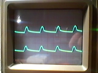

I turned the amp on again today and it was doing the same thing again, so I took a photo of the oscilloscope, this is from the speaker outputs. Different input levels didn't change the shape of the output waveform, just the amplitude. If I turned it up too high it would click into protect mode. Then it started to behave normally again, so I went to load test it again to check its stability. It was fine for a couple of minutes then started clipping, but the clipped portion of the sine was on a a decreasing angle as opposed to the normal flat line along the top starting from the peak sloping down, leaving a flat spot on the side of the apex. I have included a small picture to better explain the waveform, and then it went back to doing the same thing it was before (refer photo of scope).

Your receiver has soft clipping control , the sketch is showing this soft clipping in operation so you were probably driving it near its limits to show this waveform so that bit appears to be OK and nullifies my thoughts so far .
Probably best not to drive the amp into protection mode as this comes in as a result of high heatsink temperature.
Would you post a scope photo with the oscillator output on one scope channel and the resulting distortion ( not the clipping waveform) on the other so we can see how it correlates .

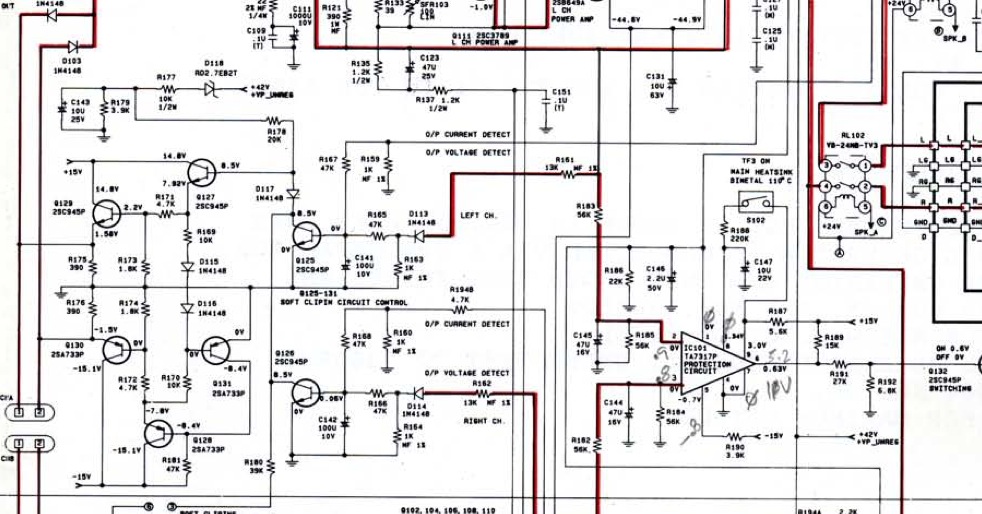

First you have pencilled -0.8 volts at the -15v pin of the protect ic.Pin 5?
As mentioned above, i would suspect the clipping detection, but 0.9v at protect input (Pin3) seems to be quite high. is this DC or AC?

Going back to your original post .....its odd that the signal looked OK on the emitter of the first trannie Q101 as thats where the global feedback attaches .
Thanks for your reply. Epicyclic, yes I thought that was odd as well. The distorted sine wave I drew a picture of is not the soft clipping, when the amp was working I tested the output with the soft clipping on and off purely out of curiosity and all it did was round off the edges of the dc portion. What I drew a picture of is completely different and I have come across it on other amps but not sure what it means.
@ whizgeek- Ignore all the pencil marks on the schematic, as this was already there. Someone must have scanned an original paper document that had the writing on it and not erased it, but its not mine. Sorry, I should have mentioned that.
Next time it plays up, I will take more photographs of the scope at various points throughout the signal chain. I will measure the voltages throughout the protection circuit, I checked the voltages in the amp and they were all okay. I have a feeling the problem may lie in the protection circuit simply because its one circuit acting on both channels, and both channels show the same fault behaviour at the same time.
