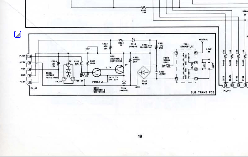

Hi Expert !
I am a novice. I have an old NAD 705 which works perfectly, until I cut the speaker wire...sorry...for the first time in 2 years...After that there is no more power, nothing. I check every fuse, everything is good. I notice that there is no current at the Swicth output, so I think it is the RL_301 relay that is blown... I force the relay to turn on by jumping it (see the red line in diagram) and NAD 705 powered on, YES! So I think it was the faulty relay, I change it with a new one and reinstall it...nothing changes...the relay does not close. I check the voltage at the relay, it was only 6 Volts, it needed 13v (see diagram below). So my question, why is it only 6 volts? This is beyond my competence. Anyone have a lead? Thanks in advance everyone.

How can I test the DC at the output if there is no electricity going to the output, because the relay is open? No light on the panels, the external socket is off, etc... because now, no DC at the ouput !
