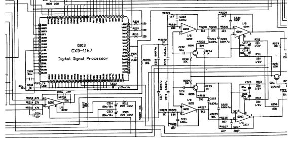

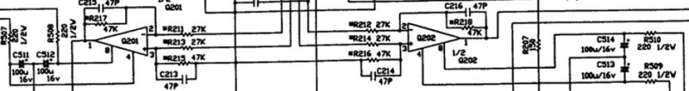

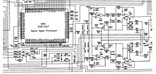

Mooly said:Going crosseyed looking at that. They are 5532,s not 5534 in the player. Pin 5 does not look connected on the layout.
Pin 5 of Q201/202 is connected to ground....
Mooly said:
Edit, If they are 5532 then there are 8 individual OpAmps in there, the filter for the player shows 4. So how are they connected. The image is not really clear enough.
Service Manual at... 😉
http://www.hifiengine.com/manuals/nad/5420.shtml
I was just about to say that there are parts C213/4/5/6 etc that are at the edge of your layout but not on the circuit. Problem solved then.
Mooly said:That accounts for six ? I think 2 missing ? 😀
Unused perhaps
LOL....
Effectively Q203 and Q204 are only half used... (pins 3, 2, 1 ) 😀
Tube_Dude said:LOL....
I believe you are correct. The power supply connections for Q201 & Q202 are on the left side of the schematic, under the MASH and DSP chips. See attached image.
Maybe it was easier and cheaper for NAD to purchase lots of NE5532, and waste a few halves, rather than mixing NE5532 and NE5534 parts on the one PCB.

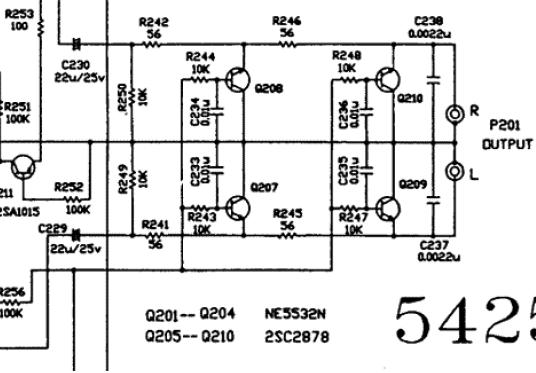

Besides playing the opamp types, there are lots of other mods which could improve the sound. To name just a few:
- Add film bypass caps across all the electro caps associated with the power supply pins of the opamps (C511-518) and also the input & outputs of the voltage regulator ics (C501-504). This CD player is completely devoid of film cap bypasses on the analog power supply rails, its a wonder its stable.
- Put film cap bypasses on C229 & C230 audio output coupling electro caps (or get rid of them completely)
- Disconnect the mute circuitry (emitters of Q207 - Q210)
- Upgrade the quality of the all the film caps in the active filters (C217-228). They are all garden variety polyesters.

Part "D" of your question, these transistors provide a mute function. When they turn on the output is "shorted" It's up to you whether you can live with any noises produced-- switch on/off, between track searching etc. If you are really keen you could replace these with a small relay instead-one for each channel.
I would listen with and without them connected- if you really can't tell a difference leave in. As they are in parallel (sort of !)why not remove one set, probably the ones nearest the output would be best and try that.
