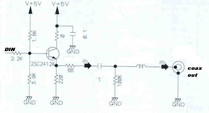

You could try this.
Add better de-coupling ex oscon >100u, MKP/MKT and ceramics NPO, loose the coil and parallel a few HQ MKP-foil caps on the output and you should have a nice drive circuit.

A 8 said:
You could try this.
Hi
This cicruit does not look very promissing
- It does not show 75 ohm source impedance
- It is too asymetrical
I suggest the use of reclocking, drive with 75 ohm and please use a transformer before leaving the CD players' cabinet

In all honesty I have not tested it, found it in a commercial high end dvd-player superior to a player based on the same circuits except this buffer stage.
Either way I agree with Guido that the best you can do is to re-clock dout before you buffer.
Output impedance......
It might be close to 75 ohms, by the time you take into account the impedance of the follower. Still, doesn't look that promising.
Make sure the transformer can actually pass a square wave at SPDIF frequencies. A lot of the ones that I have seen in CDPs are too low in bandwidth to be useful. Good for keeping EMI down, but they sound dreadful.
Hi A8
I overlooked your remark to take out the choke, ofcourse that makes it much better, but still.....
Not knowing the value of the choke....
It might be there to build out the impedance to compensate for the excessive capacitance of the RCA jack.

But probably not. Probably to limit EMI.
