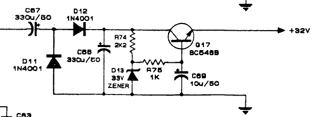

The mains transformer in my NAD 402 tuners died, and I would like to replace it. It is a standard IE48 type, but with a non-standard value of 2x23volts on secondaries.

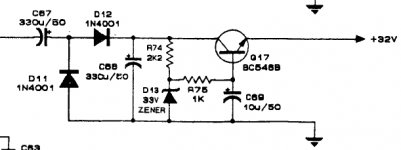

I thought I could replace it with a 2x24volt one. But while most of the NAD’s power circuits are regulated by 7805 and 7812 type regulators, there is one power circuit that outputs 32v. The schematic is here below. The circuit is feed 23VAC, which is rectified by D11 and D12. Therefore, I believe, 23VAC translates into 32,5VDC, which is then regulated by the zener and transistor to 32VDC.
But what happens if I apply 24VAC, which is 34VDC after rectifying. Can the following regulators handle that, or will they be overloaded.
I greatly appreciate any input on this:)

That series cap, parallel diode is a voltage doubler, to get enough voltage headroom for the cap-multiplier regulator to work. Presumably it is a low current supply (Tuning diodes ?? ;-)
The downside is that it has a high impedance and poor regulation, ie the voltage ( at Q17-C) will lower as current is drawn.
Given all that, I cannot see any problem at all with using a higher voltage. Measure across C58 when it is working. Make sure it is not wildly above 50V !
Dear tvrgeek and Cliff
Thank you for your input. I will have a go at it, and hopefully not experience any smoke ;)
The old trafo doesn't show the VA rating, but being a IE48-type, these normally have ratings between 8-12VA. Will try a 12VA one.
Thanks again
berthej

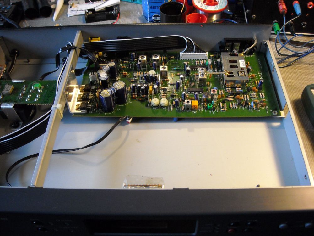

had similar problems with my nad 402.
first the 12v bulb behind the display burnt through -now there are 4 yellow leds with a res in series- and after some time the transformer died. i built in a new one with 2x12Vac (the voltregs in my nad are 7812,7912,7805).
indeed it is a puristic good sounding fm tuner........
