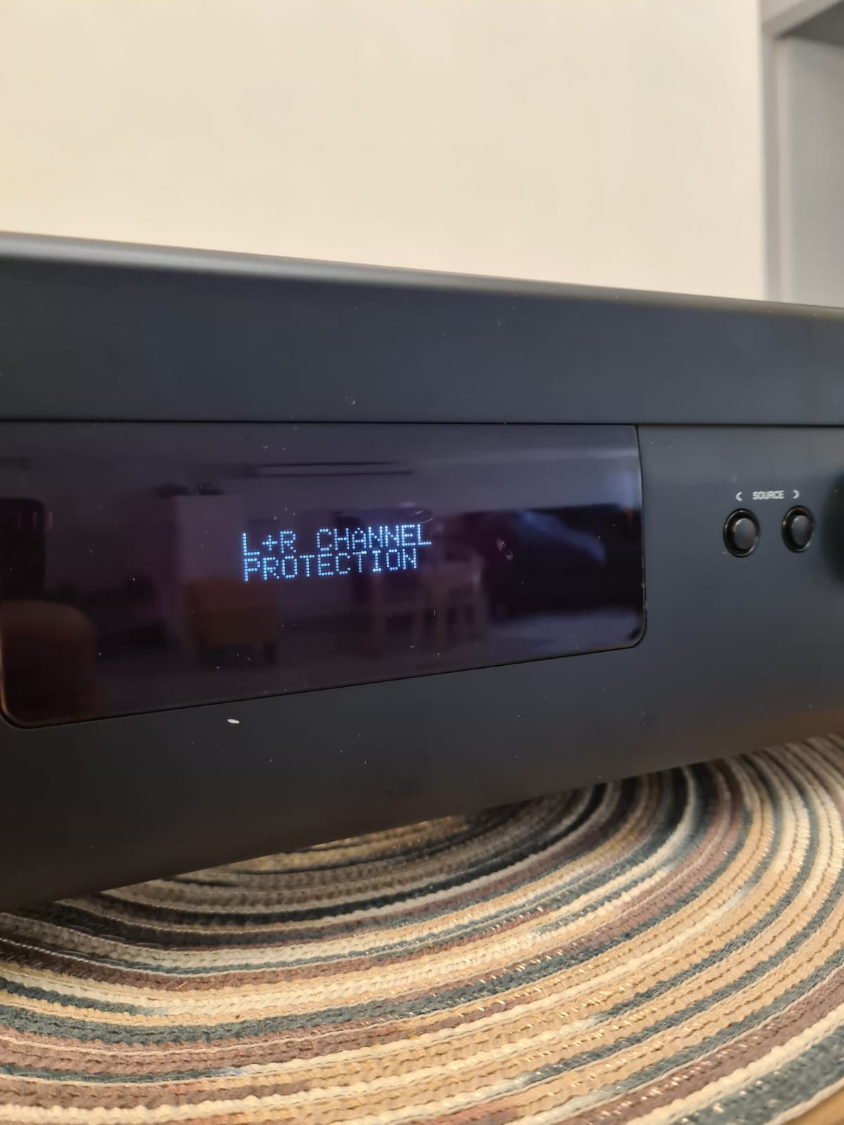

NAD 390DD amplifier protection mode issue
I have NAD 390DD amp, that recently enter to protection mode. (L+R channel protection) and turn off.
Maybe someone familiar with this situation, and can tell me what to check?

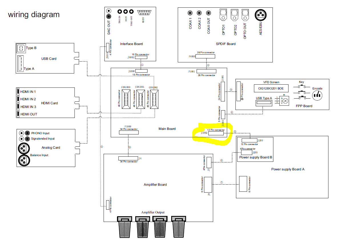

Yesterday i disconnected J1002 connector on the Main board, and reconnected ,and the amp started correctly, this morning the protection mode returned.
Thanks.

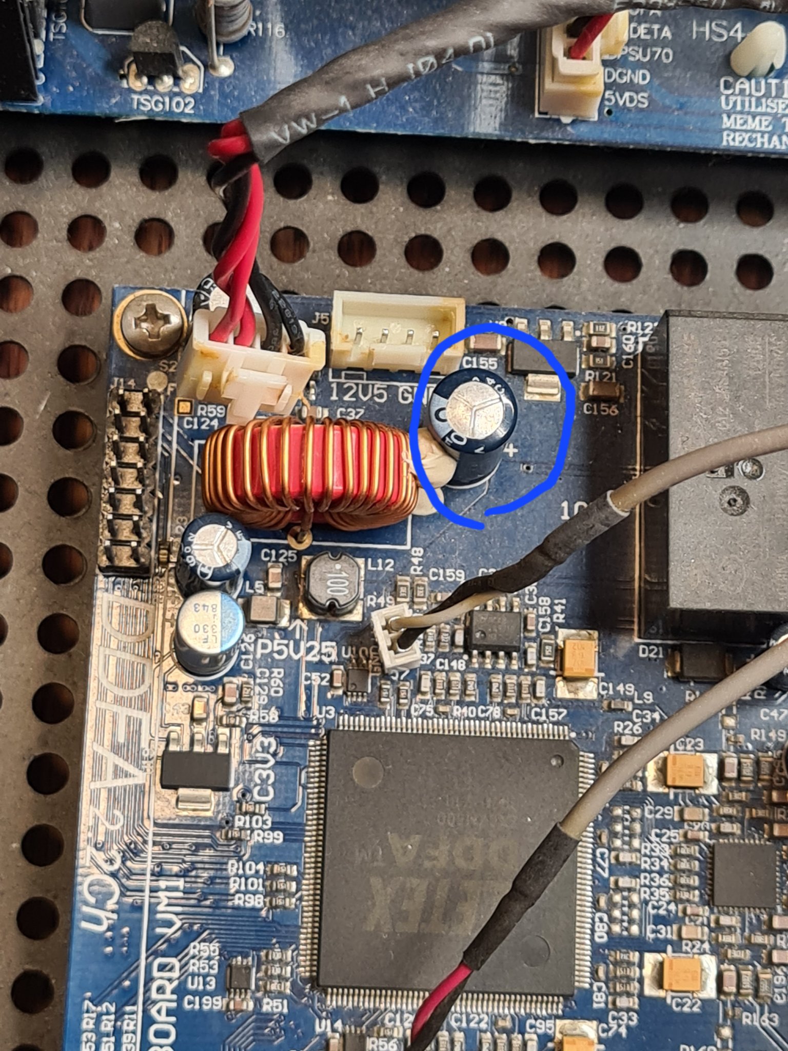

SOLUTION:
Found a solution for this issue, the capacitor C155 on the AMP board was faulty, replacing it solved the problem.
Maybe this can help someone in the future.
