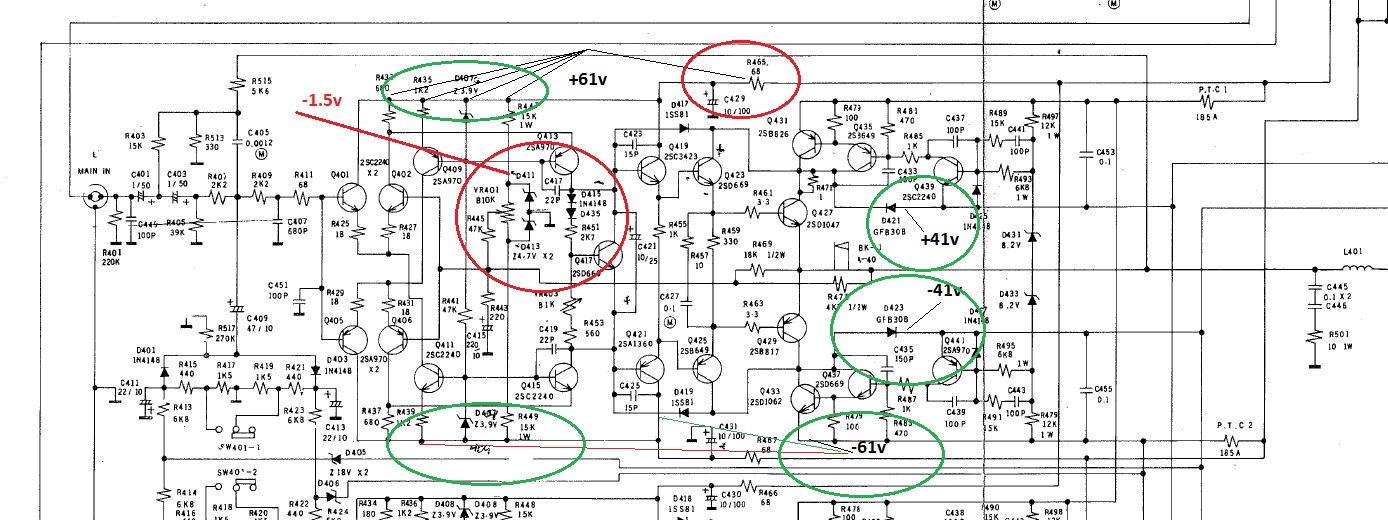

what reason would you hve no idle on either channel, i appear to have all the voltages in the right places but i have no current at all across either R471/472-solder shorts removed
not come across this before

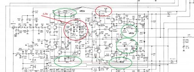

here is where i am
i did as suggested and the current across both of those caps is just over 3v on each
what is strange is i only have about -1.5v on Vr01
now im thinking it could be one of the zeners, but would you have the same issue exactly on both?

ive managed to set both currents now, so is the above right, and im just an idiot?
i think i just had one of those der.... moments😱
The Zeners should have the correct voltage across them. If both channels are the same then the obvious common factor is the +61v supply. Next up are the 15k's feeding the Zener and then the Zener itself.
Providing the circuit hasn't been got at 😀 then there can be nothing else because the Zener connects to high impedance circuitry (the 10k preset and its 47k going to the wiper).
So it has to be one of those three things or else the amp has a man made fault.

The amp works ok, so are the voltages(both are the same) incorrect at -1.5v on the trimmer
voltages at the zeners are correct +4v and -4v
both are correct 0v to ground, so iwas trying to find a fault that wasnt there.
told you i had a duff brain sometimes 😉
-1.5v is OK on the wiper of the trimmer as that is the voltage needed to achieve zero volts offset at the output. The wiper should swing between the two Zener voltages, so between - and + 4.7 volts.
