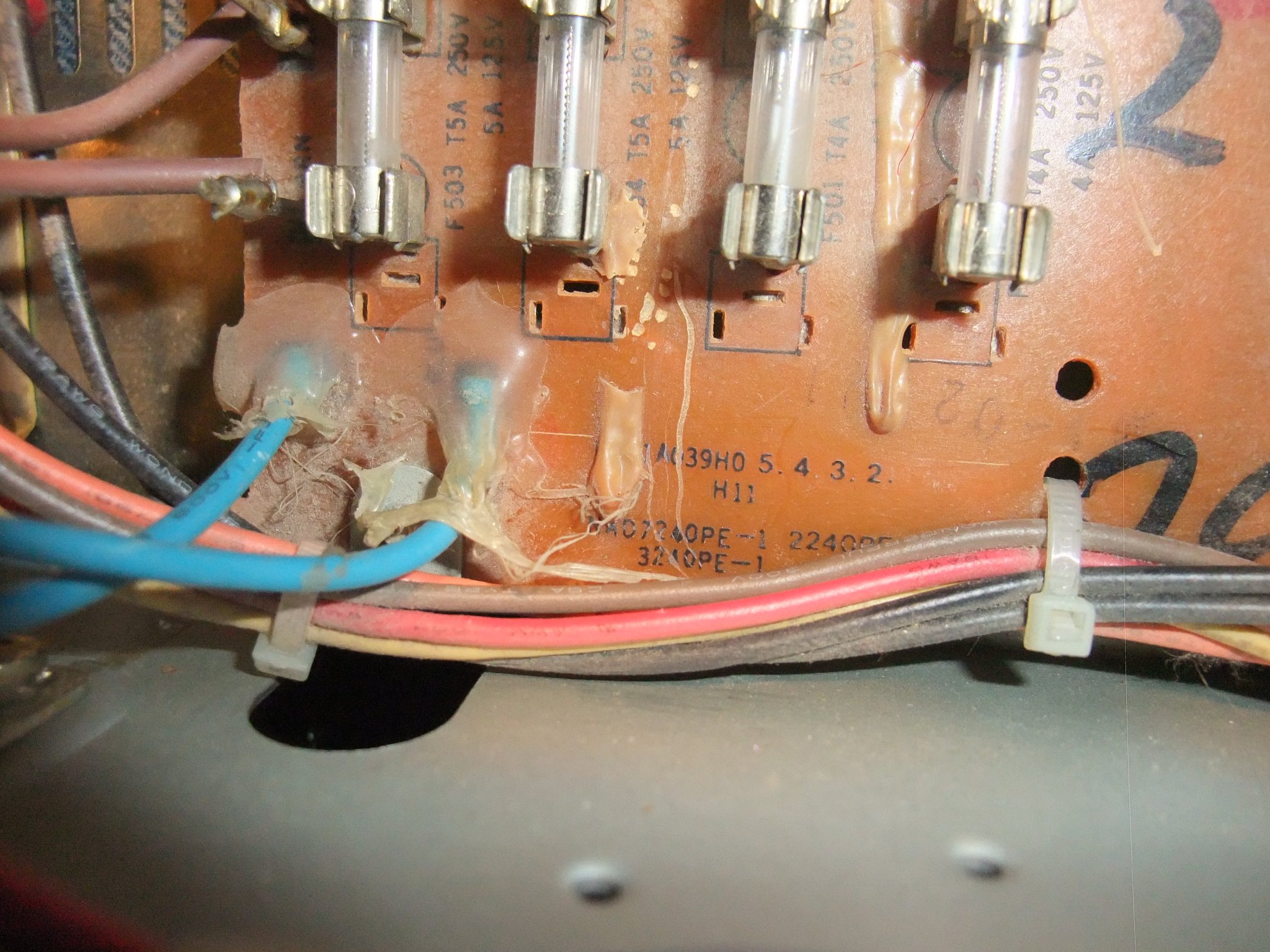

I have this NAD 3240 PE integrated amp on my bench that has a bad right channel.
Original symptom - blew F-502 at the power supply and R466 failed open on the 71 volt rail.
Replaced those components and blew F-502 again. Very high offset in the right channel - like 30 volts at the speaker terminals.
Found also Q424 bad - it's a 2SD669 - obsolete, so substituted in a MJE344.
On turn on, blew F-502 and overheated and blew R466 at the same time. Did not damage Q423.
Looking for ideas on where to start with this. Hoping that one of the output transistors isn't gone as they're obsolete also.

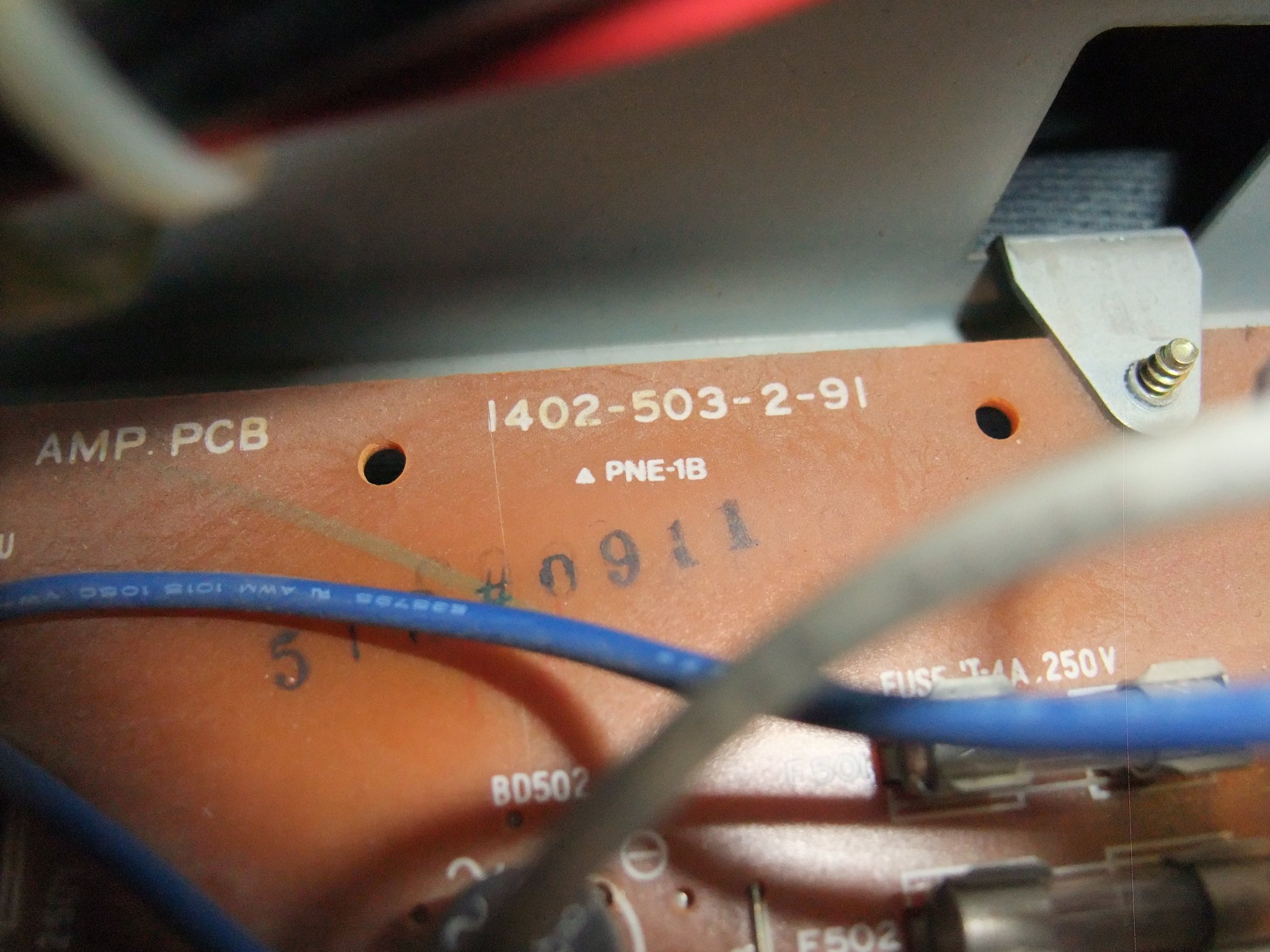

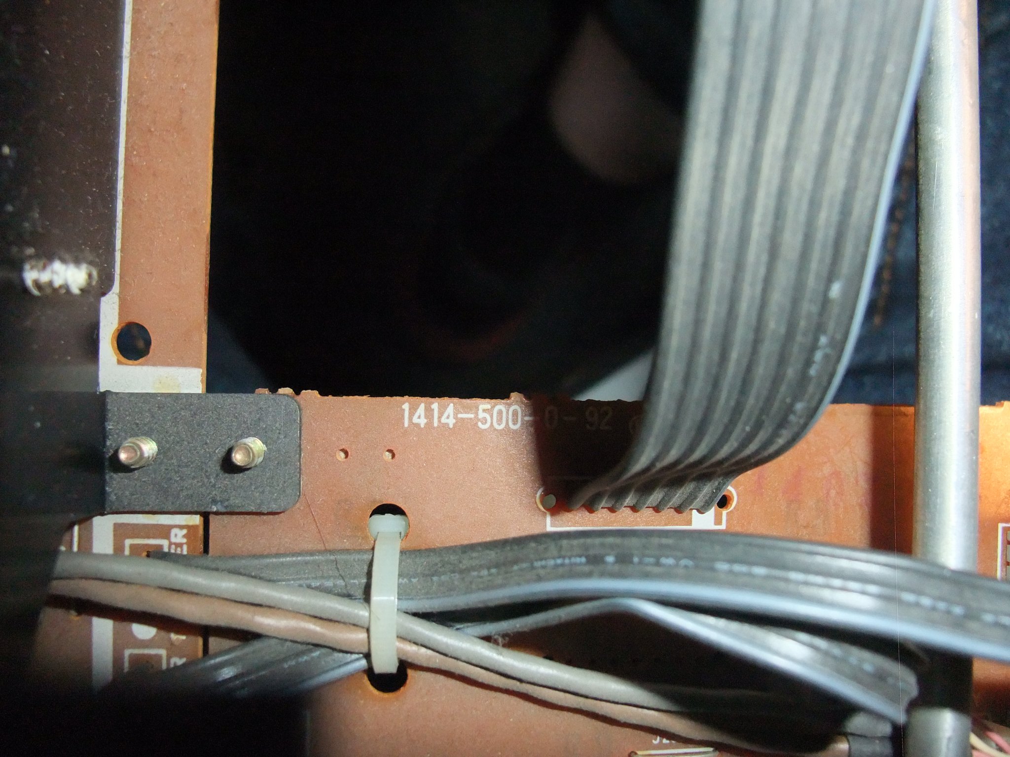

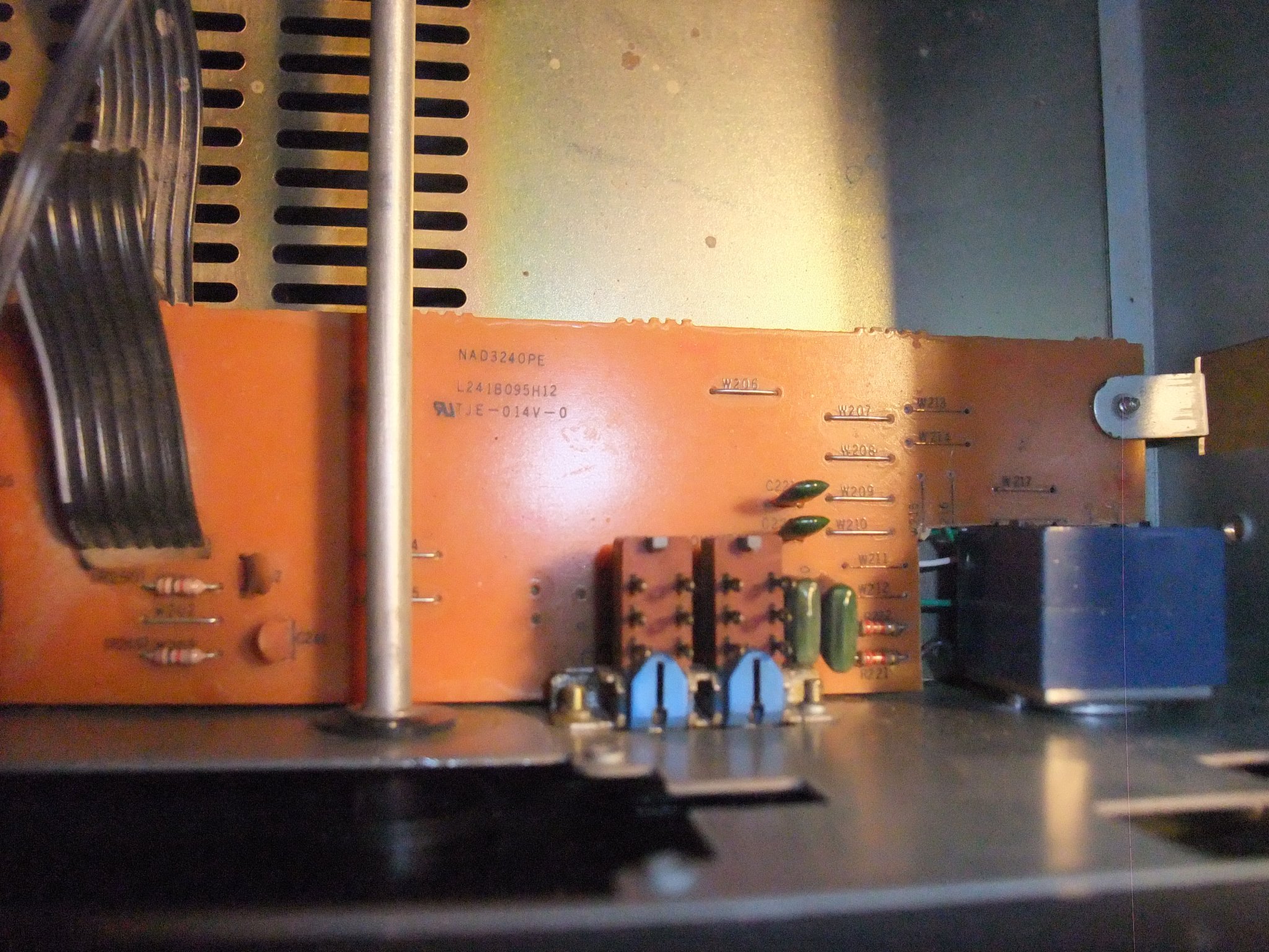

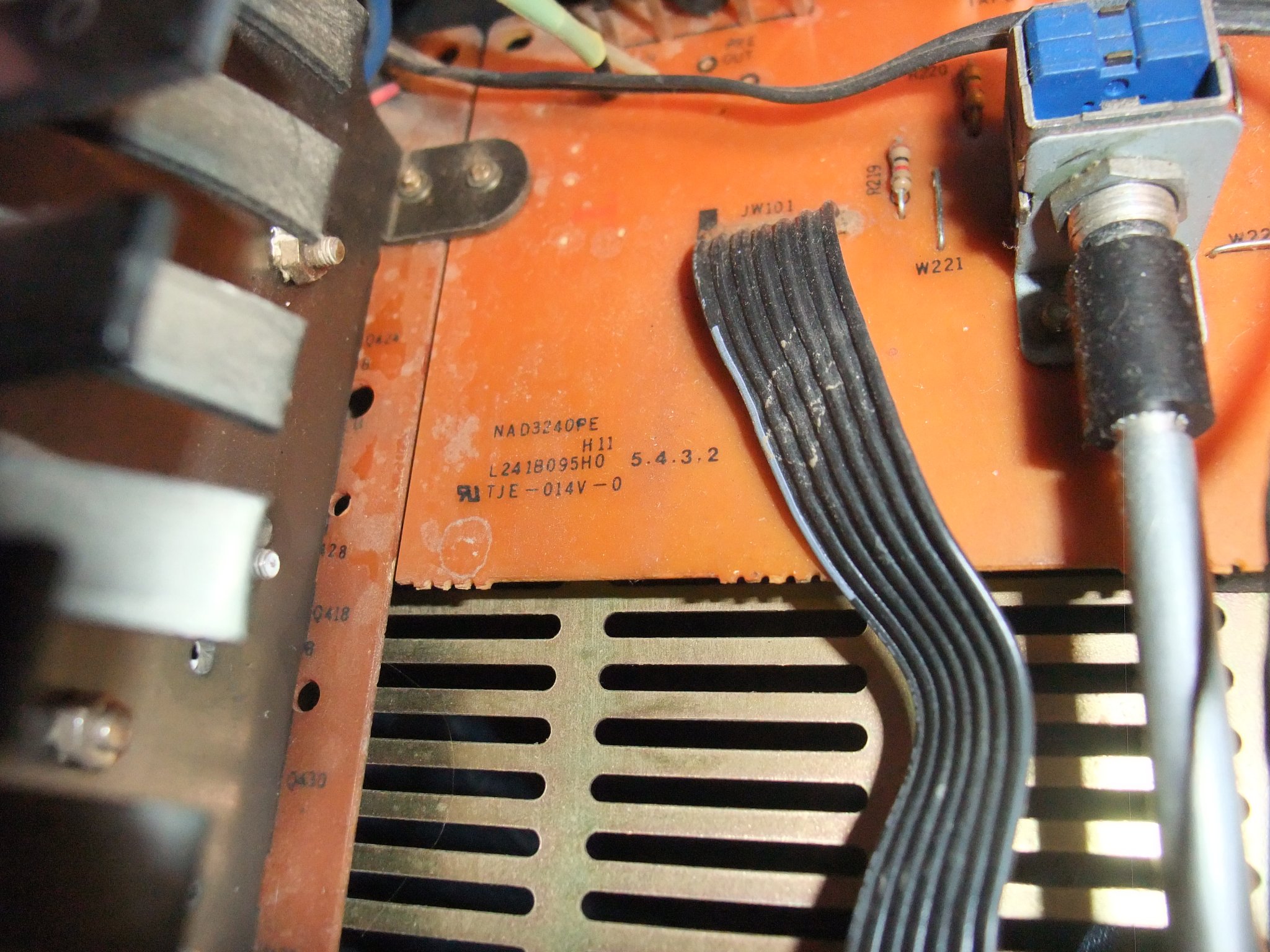

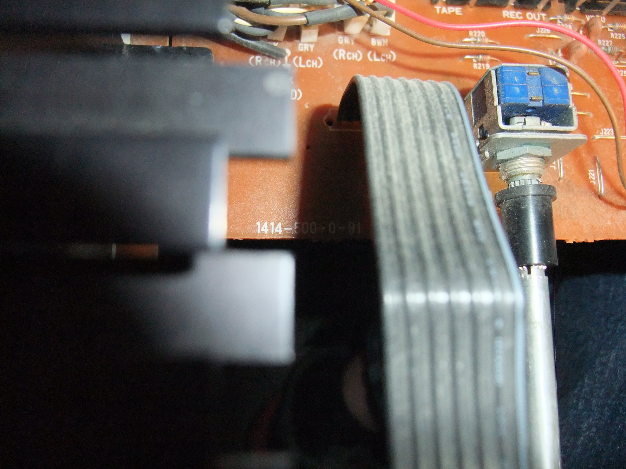

Obviously there are different versions of this model. Currently I have on the desk two different versions - one device "Made in Singapore" and a second device "Made in Taiwan". Check out the attached files:
Are there even different schematics available ?

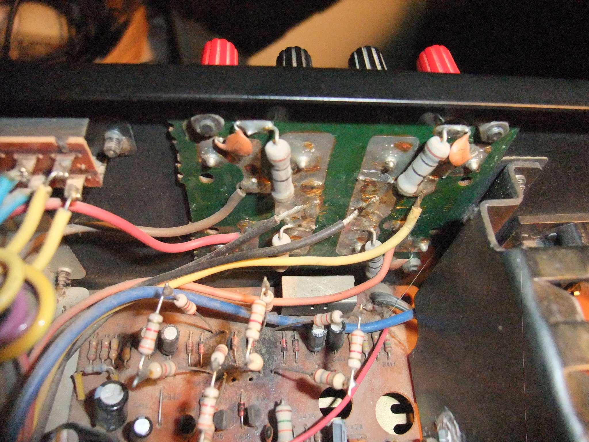

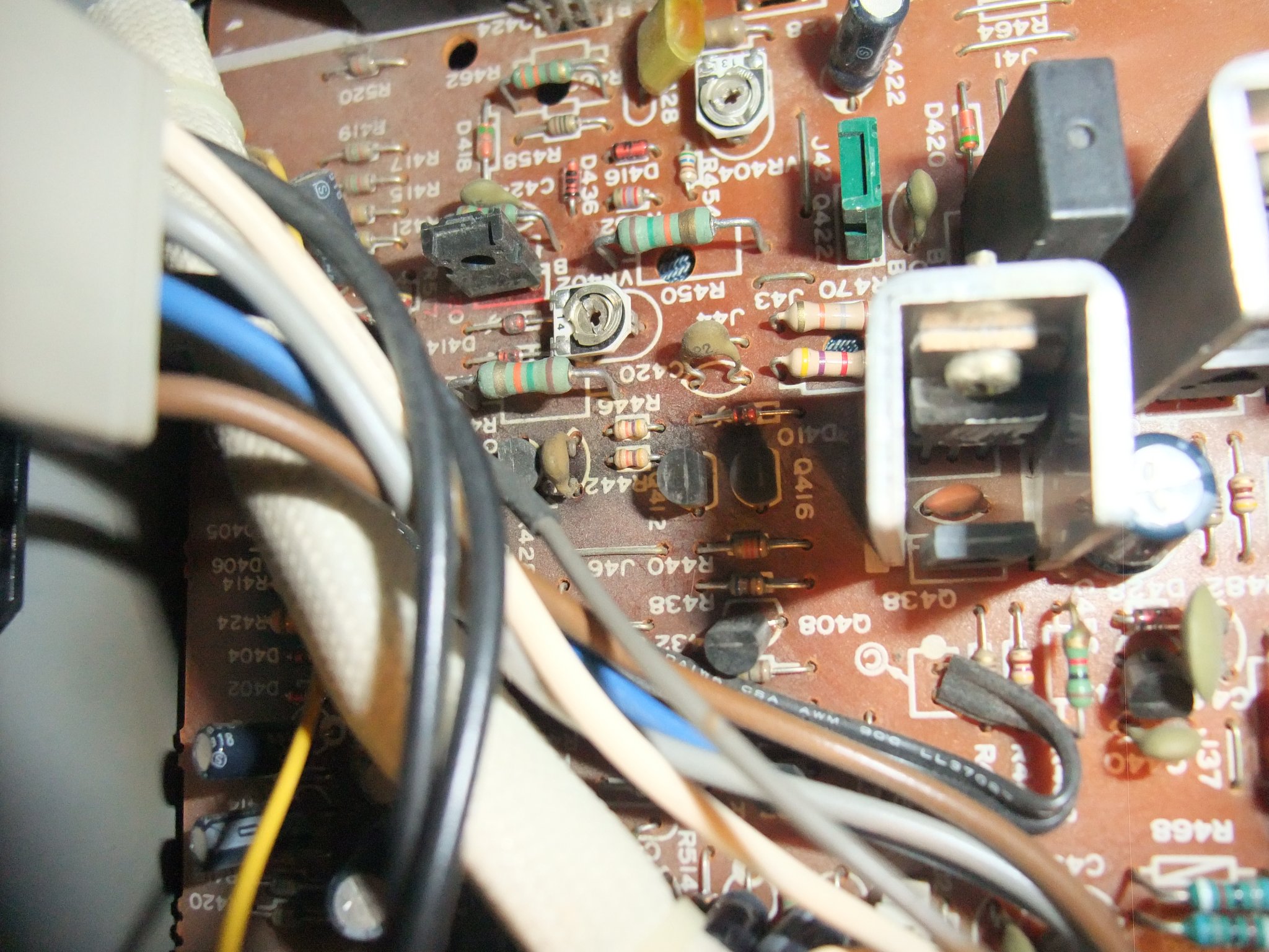

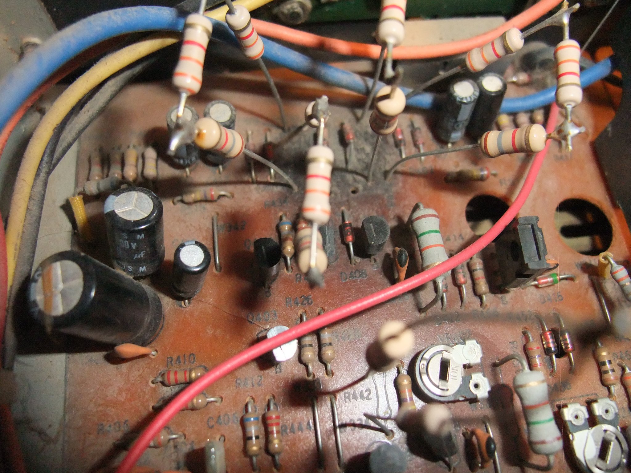

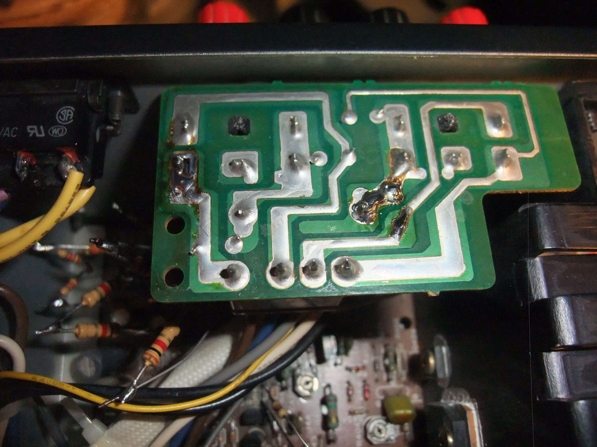

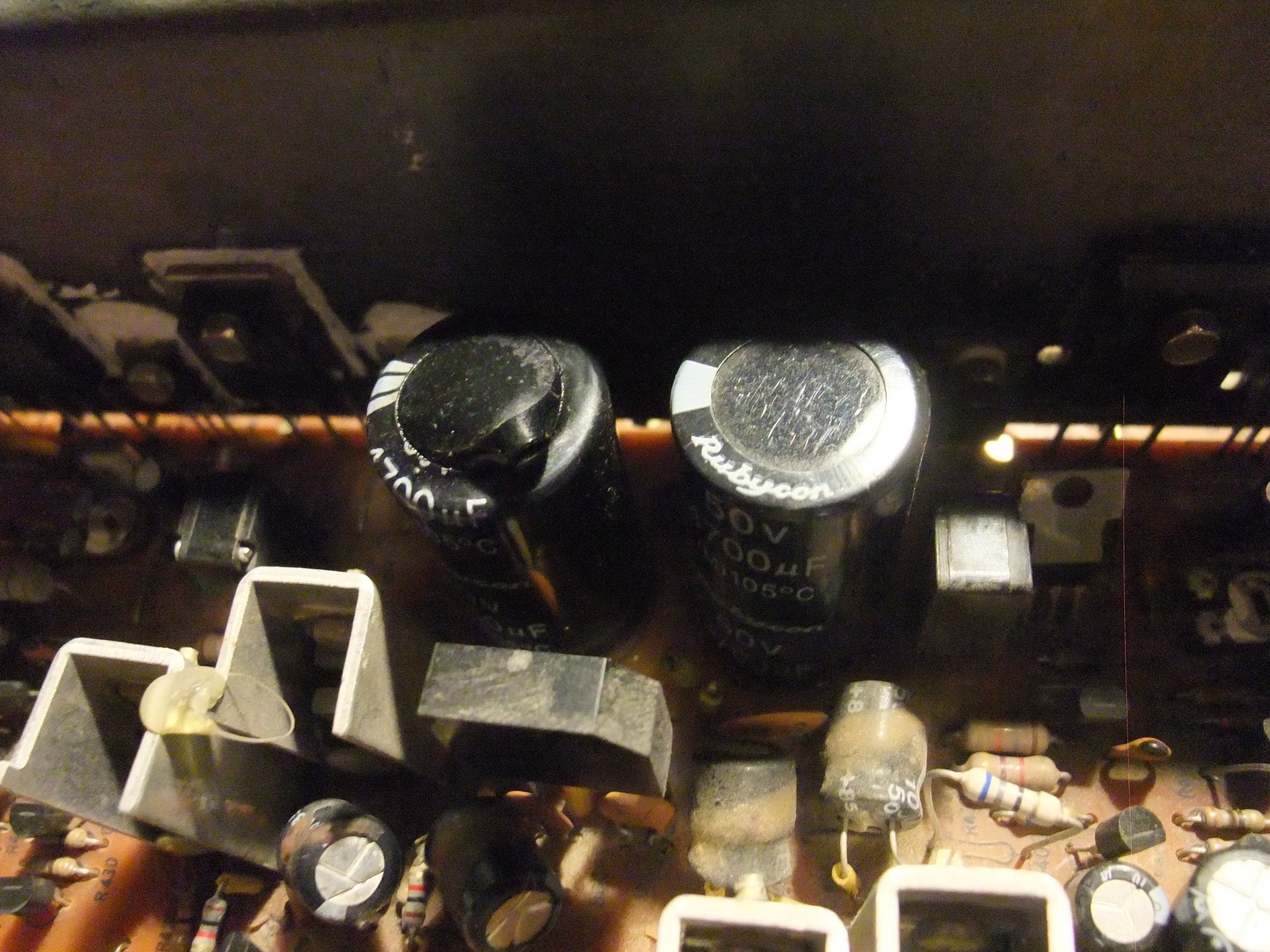

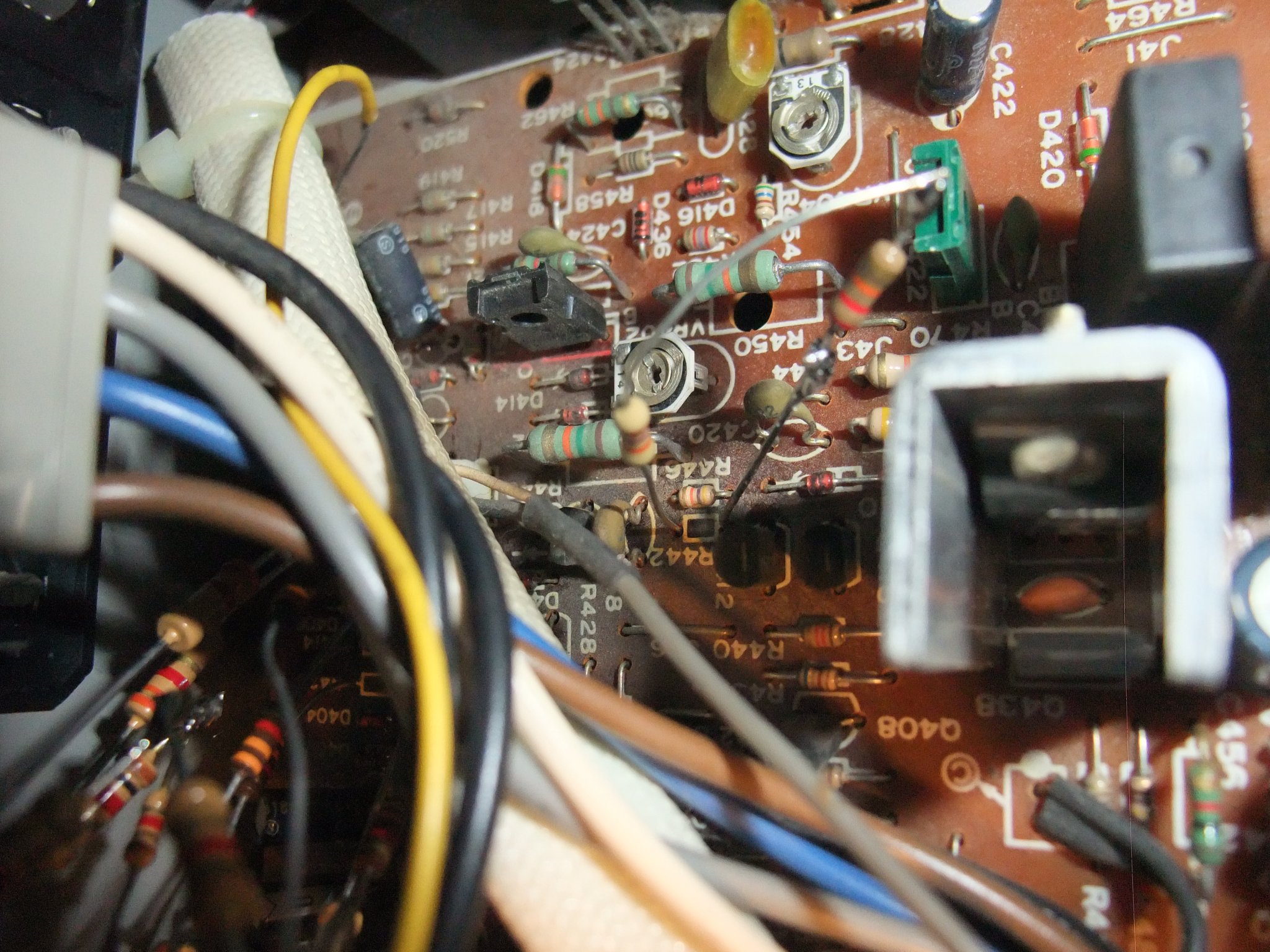

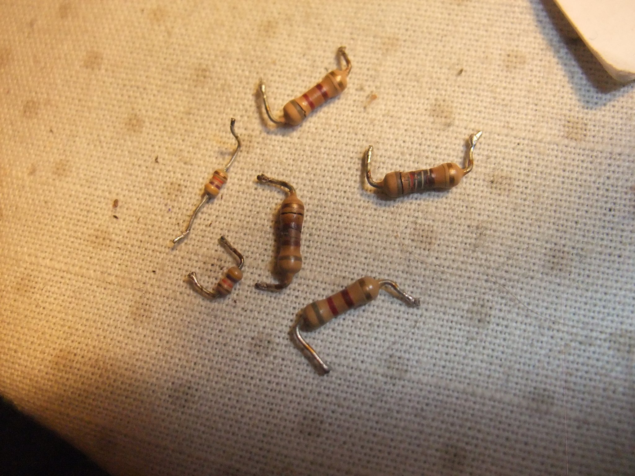

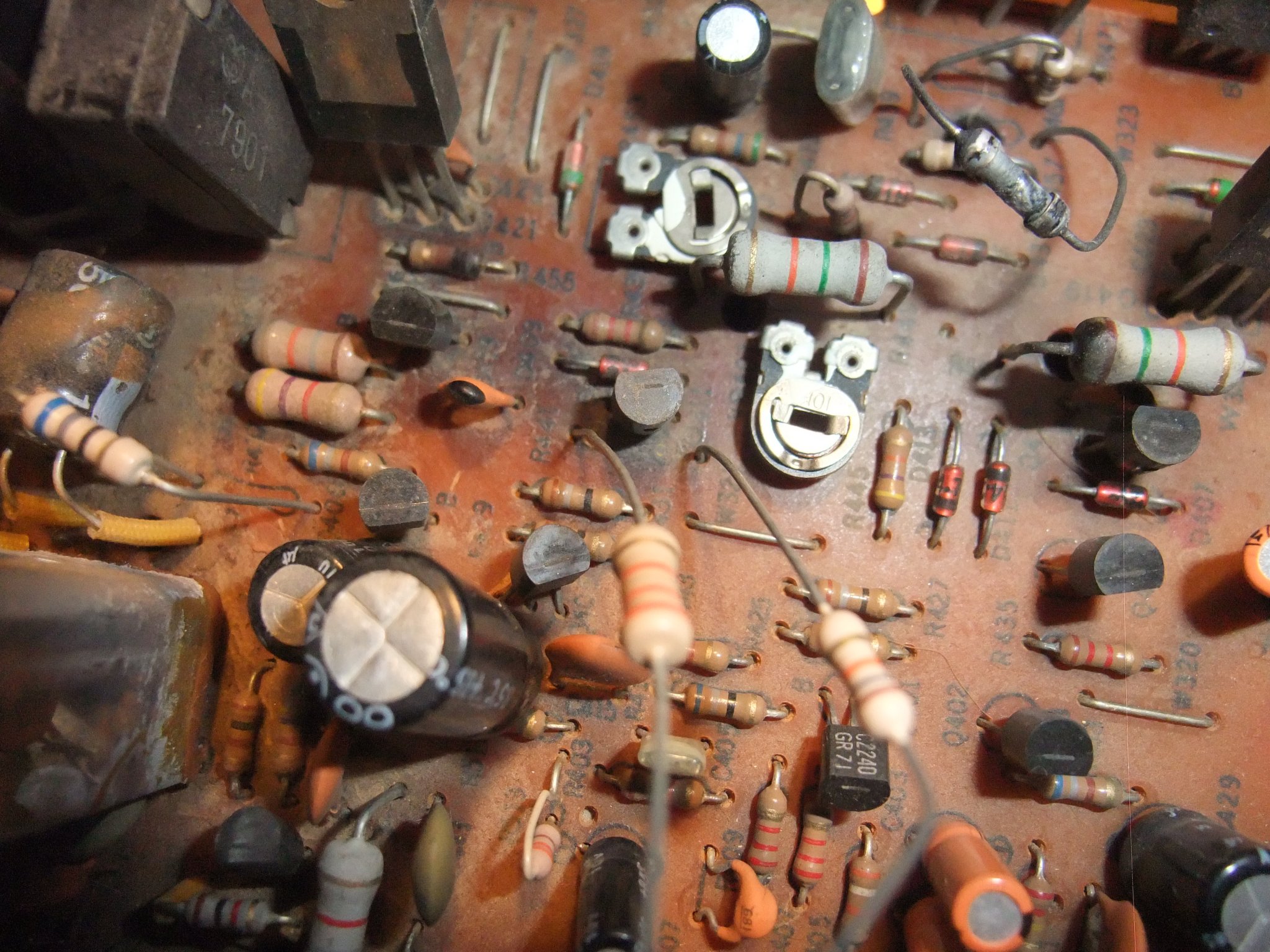

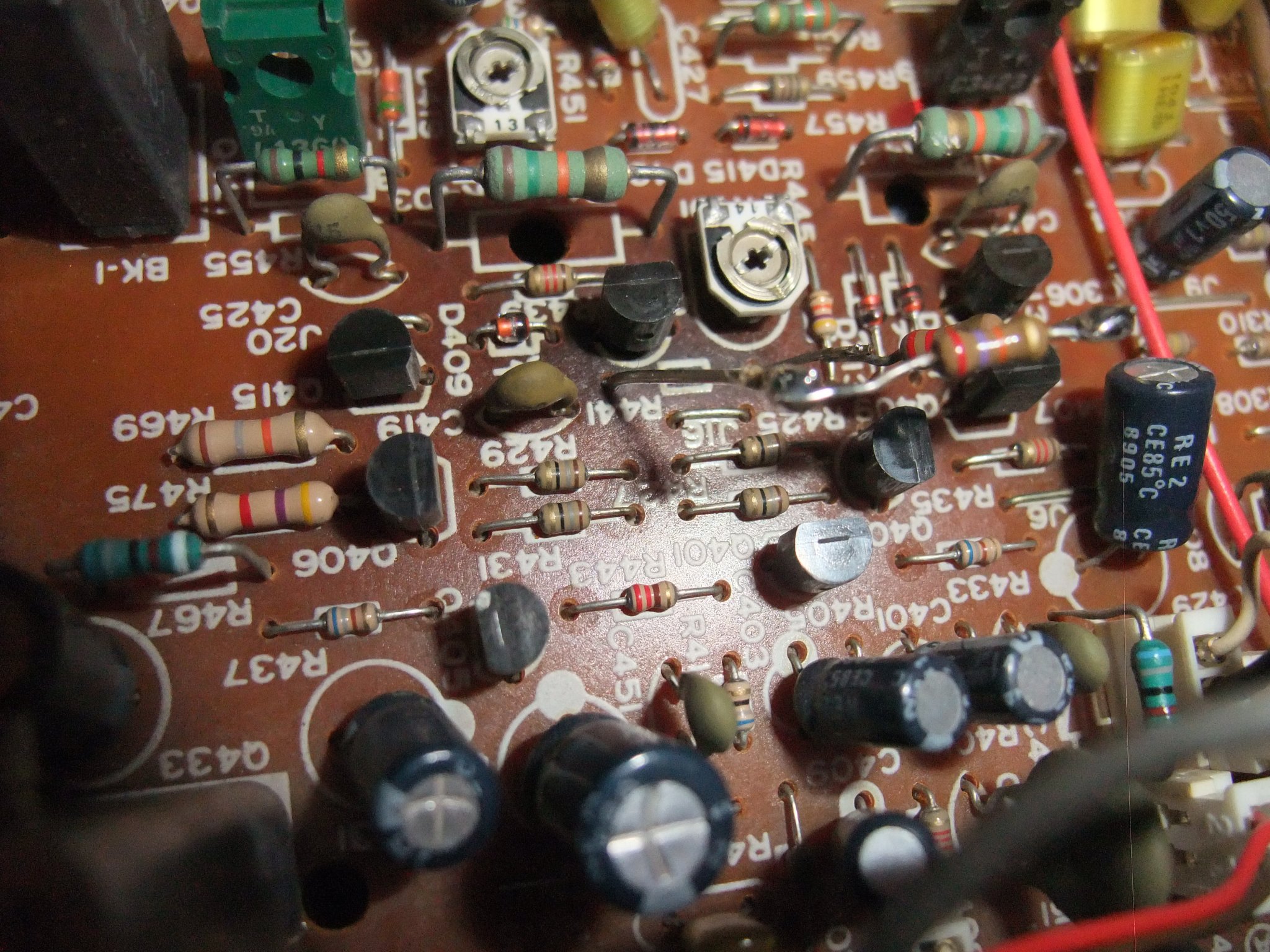

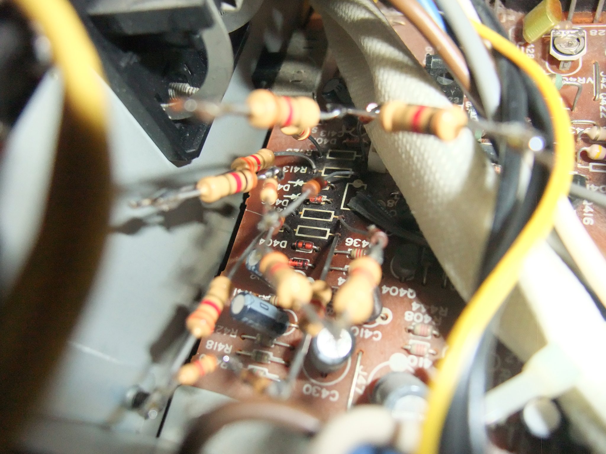

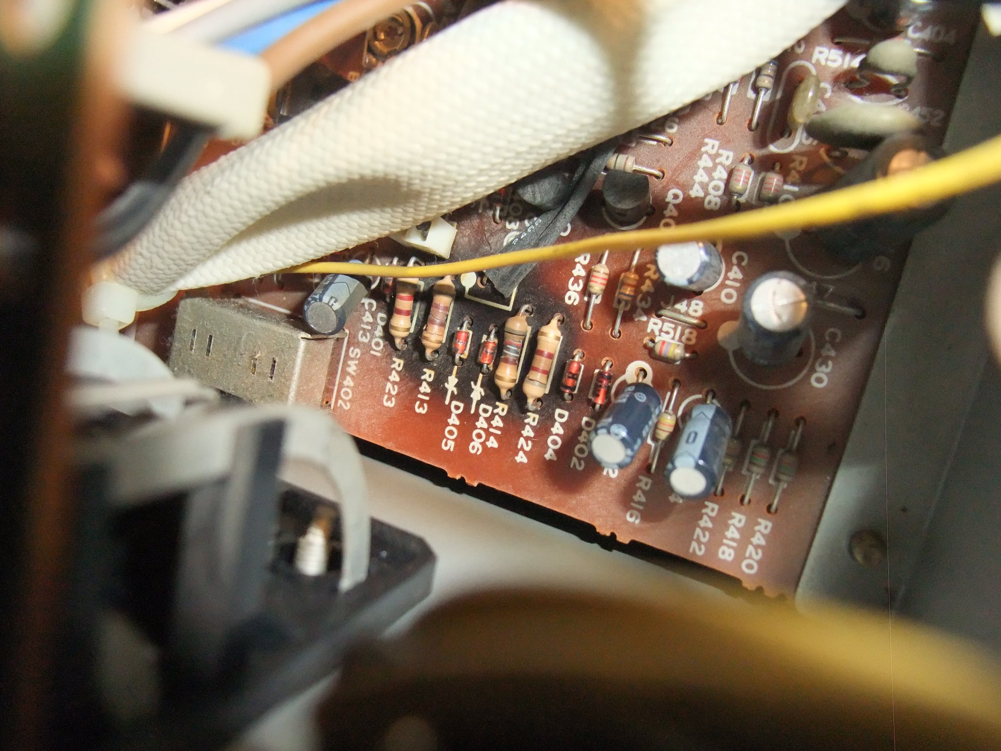

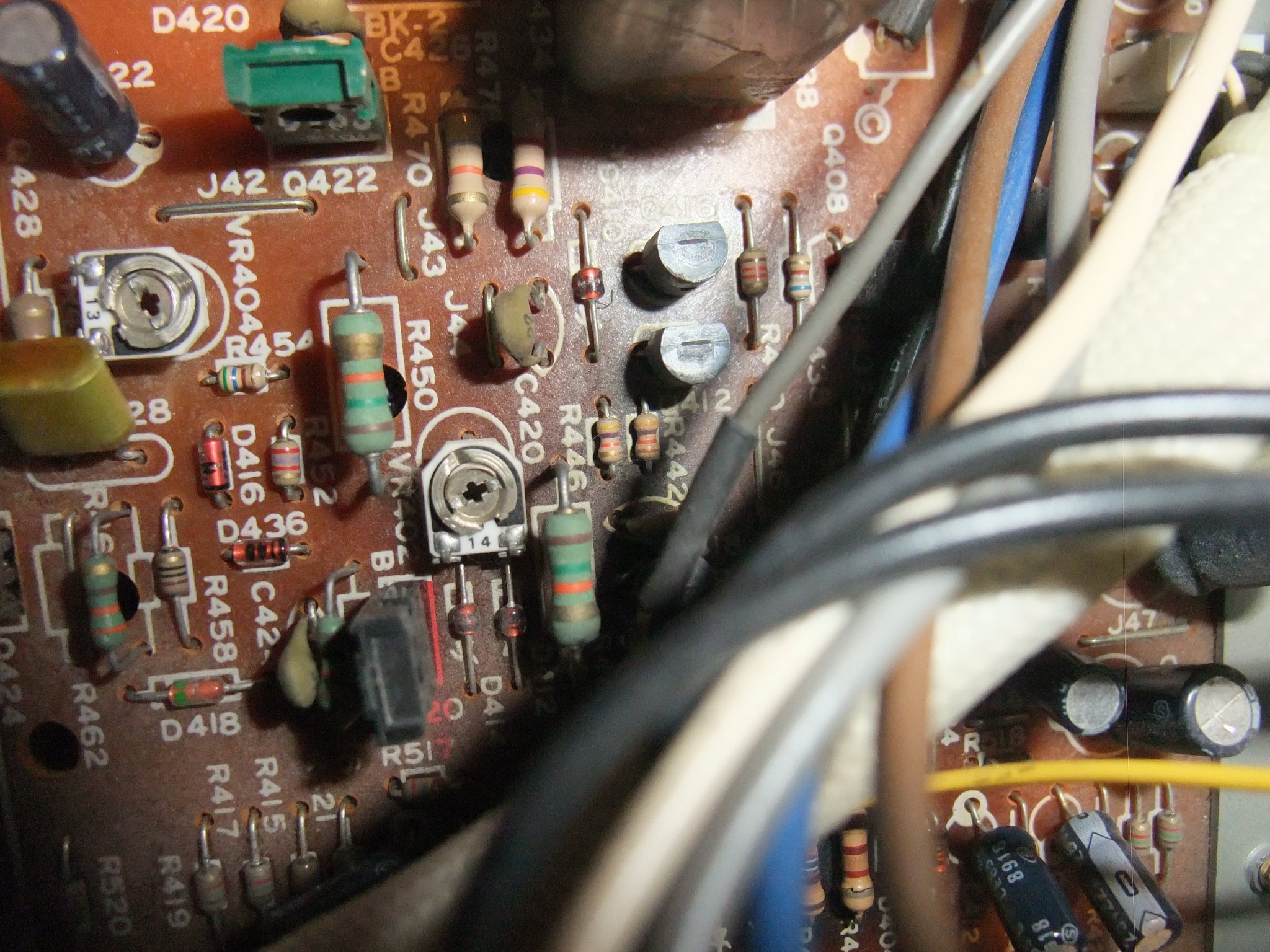

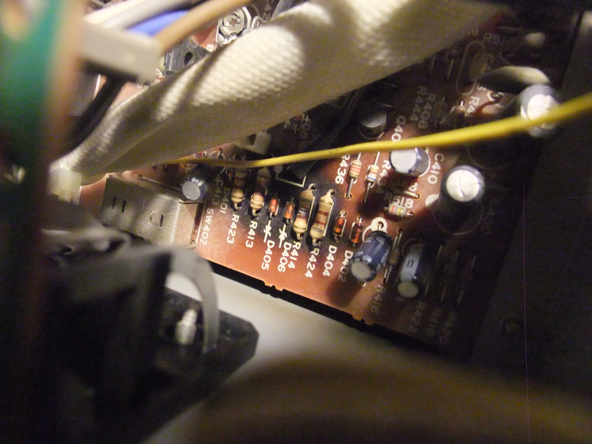

The device "Made in Singapore" is in working condition, but to avoid excessive overheating in the future (like on the images in my previous post) I replace the mentioned resistors from the names of the attached images by other versions with long silver wires and large distances from the PCB.
The replaced resistors (4x8K2) from the first both images belong to the soft clipping unit between the power amp input and Q401/405 resp. Q403/Q407.
Are therefore anywhere a circuit description available ?
NAD3240PE Singapore desolder R413-414-423-424-441-442.JPG470.2 KB · Views: 124

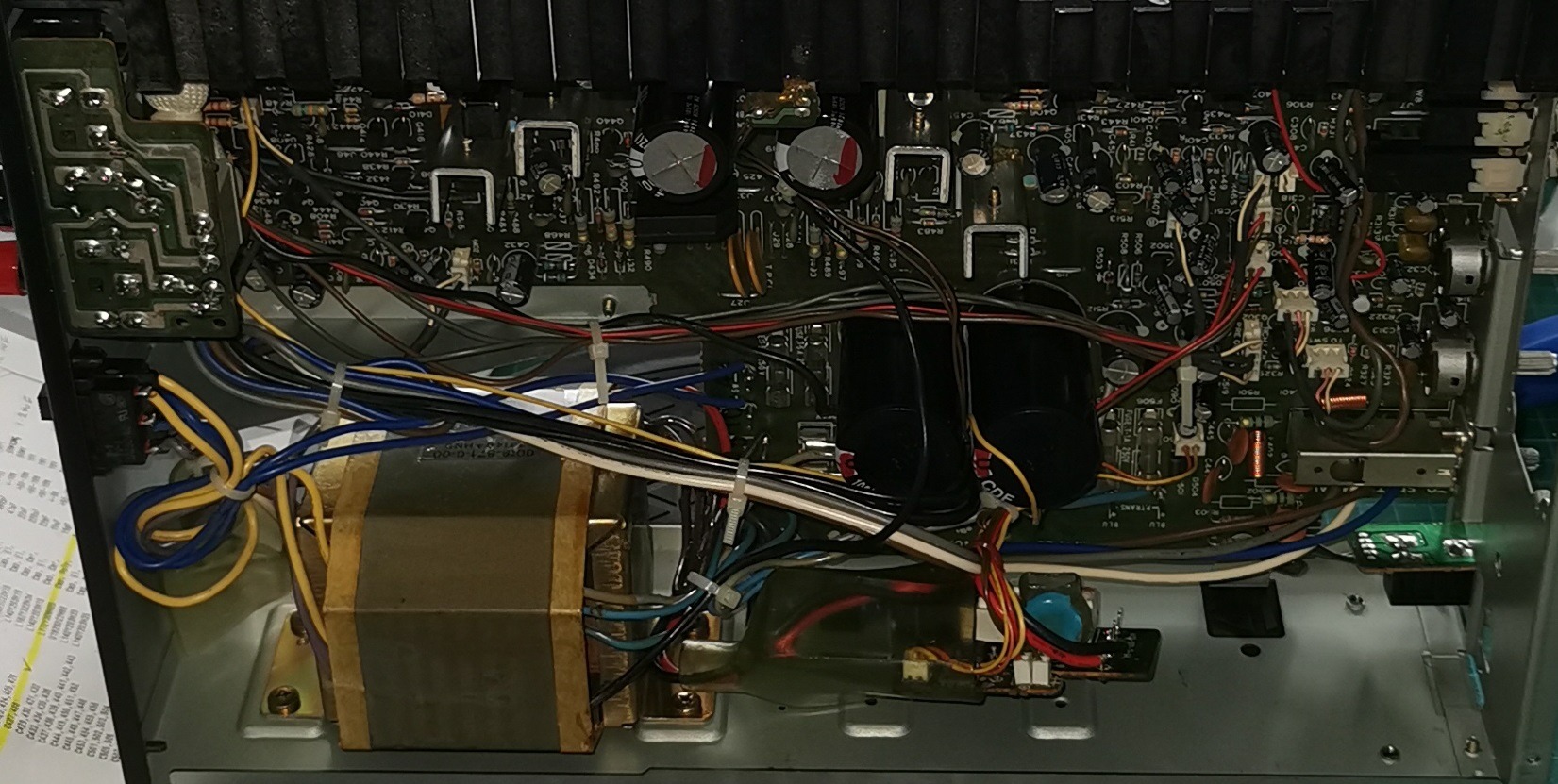

not sure where you got this from but they never looked like that new, nor have i ever had one that looked like this.It has had some serious messing about done, all those make do series resistor set upsObviously there are different versions of this model. Currently I have on the desk two different versions - one device "Made in Singapore" and a second device "Made in Taiwan". Check out the attached files:
I would suspect its failed as a result of poor workmanship.This is what they should look like
I have two different service manuals and one device of this model for repair on the desk, which is different again to both service manuals - go for details to post #67 and #68 undernot sure where you got this from but they never looked like that new, nor have i ever had one that looked like this.It has had some serious messing about done, all those make do series resistor set ups
https://www.diyaudio.com/community/...repair-nad-3240pe-advice-needed.256520/page-4
your attached image looks like a device in perfect condition - maybe due an improvement in circuit design (green PCB I haven't see before) - I think it's more likely, however, that the image was taken of a device that has played very little (i. e. few operating hours) and thus it appears in visual new condition.
Please upload an image from the sticker of rear panel from the device showed in your post - thank you very much.
All the units I've had through my door have been the same and never varied from the scheme I posted the one you have has had some seriously bad work done on it at dome point. I don't have that one anymore I'm afraid as I sold it
