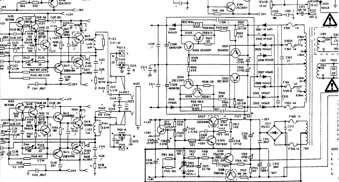

NAD 3225pe amplifier problem
I have a NAD amplifier and need help debugging it.
Sorry I had to wait until thread was aproved.
The c511 was damaged and I replaced it (radio shack .1 uf 50v 🙁 ) also noticed the fuses were blown. but replacing them did nothing as they blew again. What and how should I proceed?
That's the PSU you have posted.... maybe it's a bit early in the morning lol... it's a bit odd.
Which fuses are blowing ?
Do they blow with no speakers connected ?
It looks like the amp runs on a high stabilised supply with a lower higher current supply to "take over" if the output increases beyond a certain point.
Most amp faults see the output transistors fail... either as "just" that or with other damage.
You need to put a mains filament bulb of say 100 watts in series with the incoming supply to allow you to work on it non destructively.
There is a switch that allows for 4 ohm or 8 ohm operation. All fuses where blown, as I tried changing the position while debuggin.
How ever after reolacing the c501 and fuses, I left the switch on the 8 ohm position and only f503 and 504 blew.
I'm trying to add a better shematic view with no luck. also I have to wait for approval on postings. is there a post limit to be able to post inmediatly or something?
Where do I connect the 100 watt bulb ?
the speakers where installed when this happened.

Ok here are the ones that are probable cause. Q501- 2sa1015y,
Q503- 2sa905y, Q505 -2sb363

If it's blowing fuses it's 99% certain to be one or more of the output transistors that are short circuit. Measure them ! That's Q415/6/7 and 8
None of the transistors in the PSU would cause it to blow fuses.
The 100 watt bulb goes in series with the mains to the amp to limit current. Instaead of fuses blowing the bulb lights.
Don't have any load connected to the speaker outputs during testing.
Check those output transistors first, middle leg to the emmiter and see if they read short circuit.
