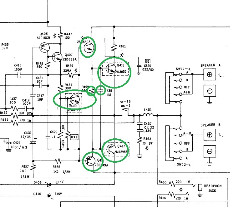

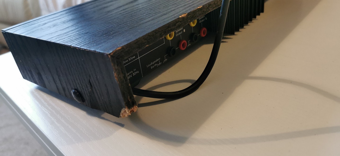

so another sorted
all circled were faulty/replaced
just adjustments now

its called disrespect sir!
anyway ive got some good chippies at work who will give me some guidance with the cover
its only chipboard so im going to make the new one out of ply and make sure all the edges are finished off
terrible that isnt it how it could have been sold like that.

and im going to make a new cover for this one from scratchView attachment 1026862View attachment 1026863

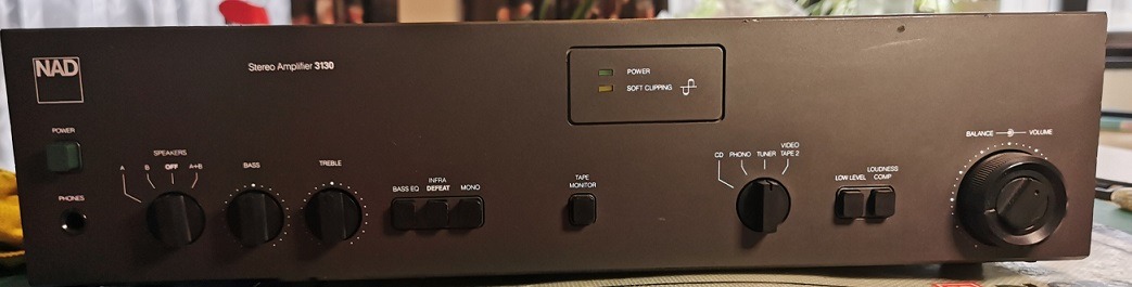

so ive just got to find the right colour match for a few marks on the front, thats the trouble with these early models ,they were very lightly sprayed onto black plastic so any chips realy show
top cover has been resprayed.
the rest has come up ok though and its had a realy good clean inside an out.
job done
