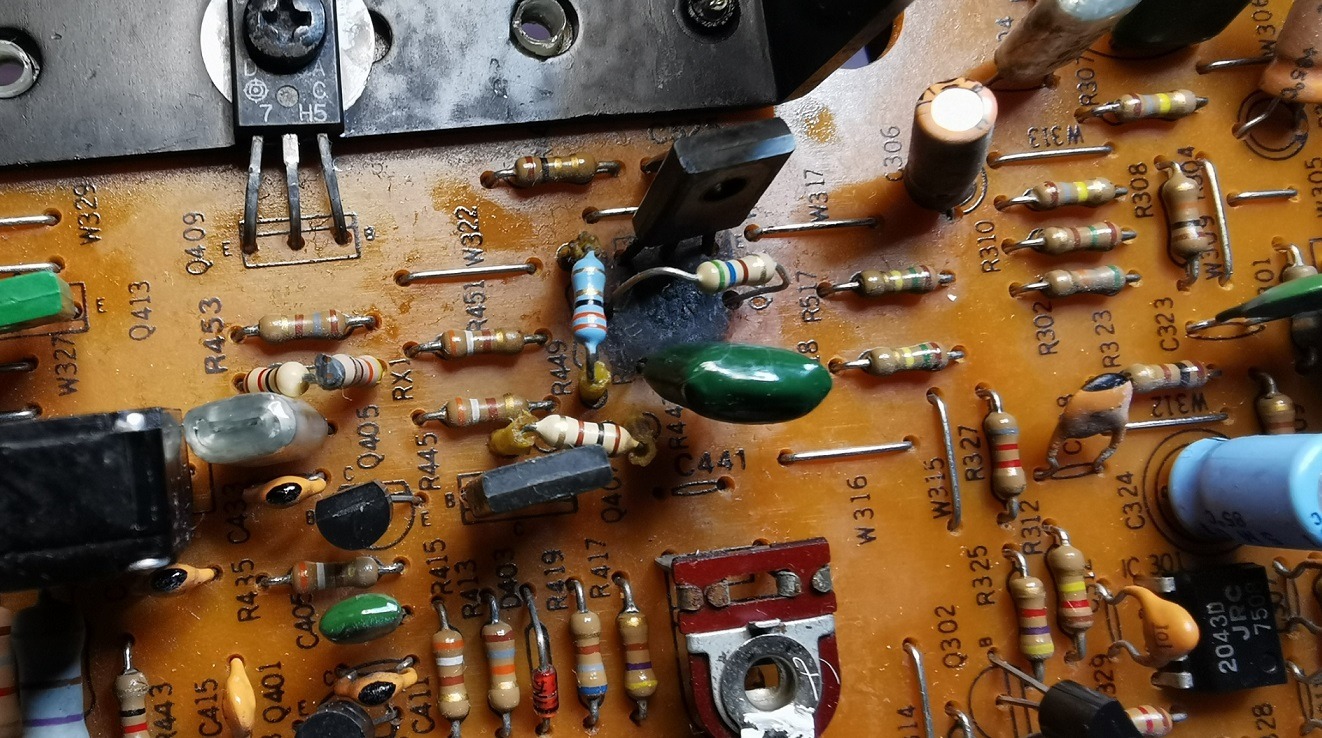

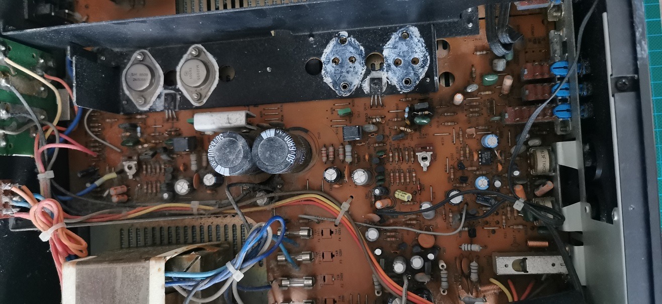

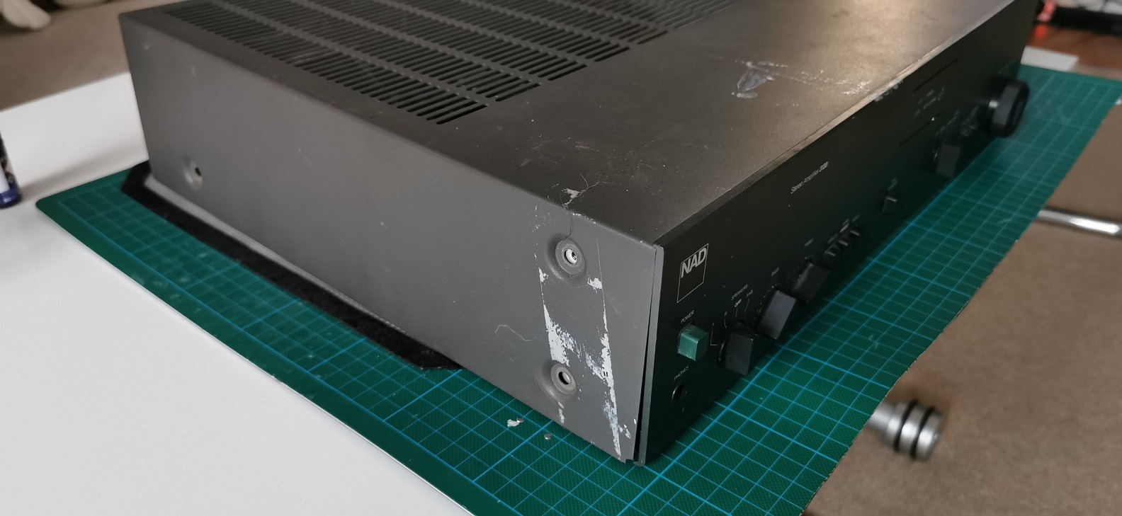

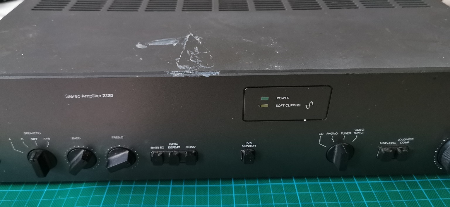

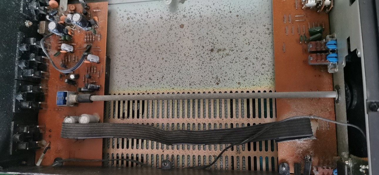

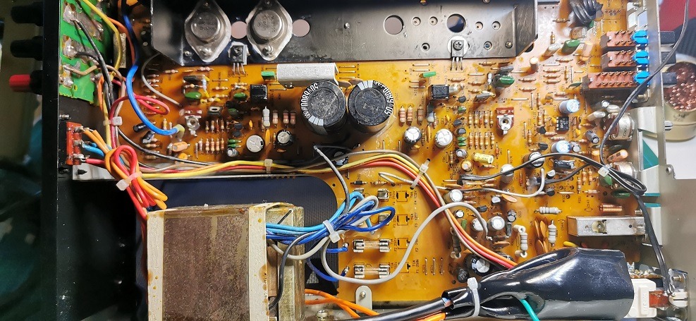

realy sad when i get things like this, how do people get things into such a mess, more as to why do they let them.
well it wont look like this after i have finished with it.

I was able to get a NAD 3155 a year or so ago from ebay. Terrible condition, similar to this 3130.
A little bit of TLC and wow, what great performing amp.

At least it's an honest wreck, meaning that there's no attempt to conceal the aborted repair. You can see by the way the goop was plastered on that Mr Fixit was inexperienced and unlikely to know the problems with sourcing the right type of 2N3055 output transistor (i.e. hometaxial as opposed to epitaxial process). There is a way around NAD's obsolete tech. problem that enables us to use present day, epitaxial type transistors but there are already a number of threads detailing the procedure which involves inserting emitter resistors. I know this works reliably to stabilise the bias current but I'm not convinced that you get near to the same original NAD 3020 type sound quality.
Out of this comes the advice to take great care with your old NADs - never turn them up like there's no tomorrow or there won't be one for an amplifier which no longer delivers its reputed sound quality.
