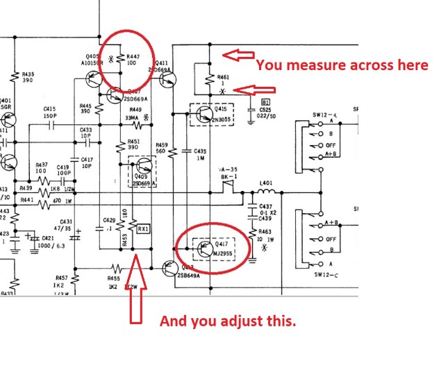

RX1 and RX2 are values to adjust to get the correct bias current but you measure the voltage across R461 and R462 to determine the current.
So 0.035v across the 1 ohm gives I=V/R which is 0.035/1 giving 35 milliamps. That sounds reasonable for such an amp.
0.007 is a current of just 7 milliamps which is pretty low. That means distortion might be higher than it should be but a lower current is also safer for the amp.

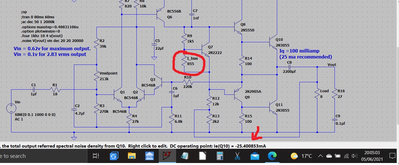

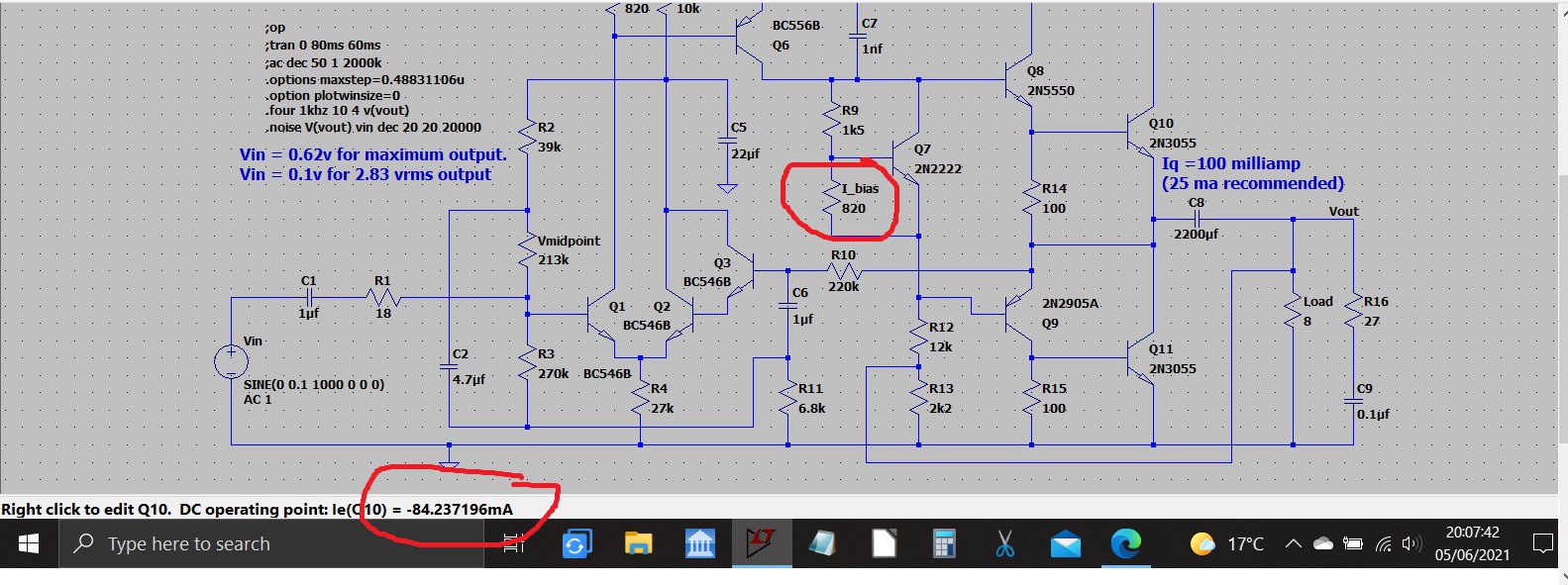

Going higher in value reduces the current in the output transistors, going lower increases it but you have to be aware that only a small change to the resistor can make a massive difference to the current.
Look at this simulation of an amp a little bit like yours. The resistor change here was small but look how the current has increased.
And that's all for tonight folks 😉
