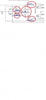

i picked up a damaged nad 3130 recently and decided to repair it as i have a good front cover spare.

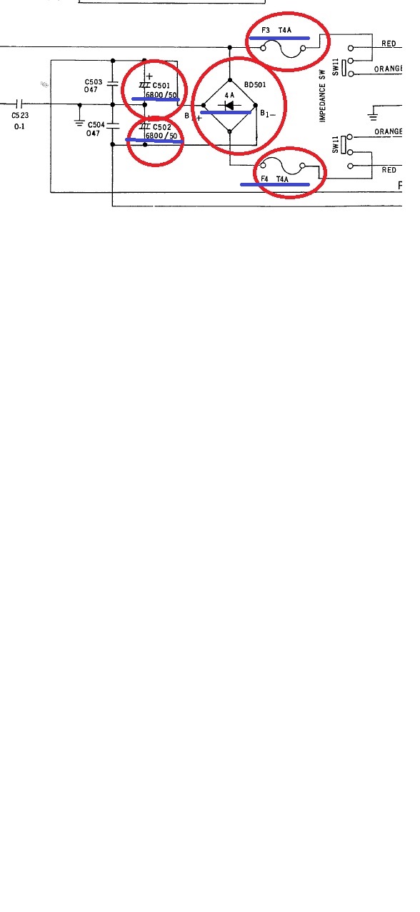

in the pictures you will see circled in red the parts i replaced as they were all faulty, the 2 resistors were scorched,but the resistances seemed ok.
the rectifier was faulty-replaced with an 8amp unit
the 2 no T4a fuses were blown-replaced
the 2 no power caps were replaced with new ones
Q 418,417 and 416 were all faulty,Q 415 was only showing a reading of 3.5v so i replaced that as well
the 2 scorched resistors were replaced

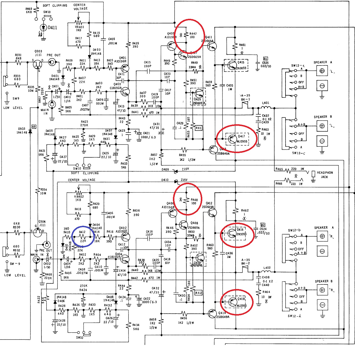

now i finished doing this about 10am and have had it on since,using all the outputs, then all of a sudden the sound on one channel started getting very distorted and then i heard the resitor burn out, so i turned off straight away and opened it up to fine R412 totaly killed, but fuses still in tact.i couldnt see anything else visualy that looked burned.
im thinking over current? but at the moment ive not looked at it and proberbly wont get a chance untill next week now, so i wondered if you guys had any thoughts.

Thoughts...
While it is not impossible for a 22k to fail I can not see how it could scorch. The reason for saying that is this... a 22k 0.25w (so a small wattage) can withstand 75 volts across it.
It would need a pretty obscure failure mode to get close to that (the full rail to rail voltage is the most it could see whatever that is) and I can't really see any conceivable fault that could give that.
Are you sure it is R412?
i will double check as i couldnt see the writing on the PCB,but this board has a mirror image of each channel so i assumed it was its opposite to R411

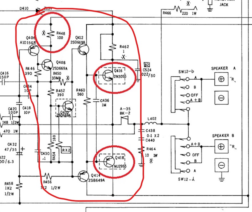

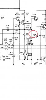

🙂 so R459 should never see any significant voltage across it. For it to burn implies that either the output transistors (one of them) has gone open circuit or that there is a problem with the driver stages.
Knowing the 2DS669 and 2SB649 types and how they can become intermittently faulty I would suggest replacing these along with Q407 before the drivers. Q407 probably runs quite hot in normal use. Also check for dries on the two 1k2 resistors R455 and R457 and if they look discoloured then replace them. They will run hot. I would also replace Q409 which is the vbe multiplier.
Although it is always better to actually measure voltage under fault conditions, the fact these 2SD/2SB devices can give trouble means that in this instance I would simply replace them.
Output transistors usually fail permanently, they don't usually have intermittent issues. If you are happy with those then you can leave them in place.
Turn the bias to minimum before powering on and use the bulb tester initially to make sure all is well.

so it is actualy the other channel that is faulty, i was just looking at the top of the diagram, same components though just the opposite channel
bit of a mess actualy
so far R460-shot
R458-ok
R456-ok
Q408-ok
Q410-shot
Q412-shot
Q416-shot
Q414-shot
Q418-shot
thats as far as i have got.
i dont have any 2N3055, i have the rest so ill have to get that one first before i can go any further, unless there is anything else i can check in the meantime
