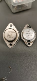

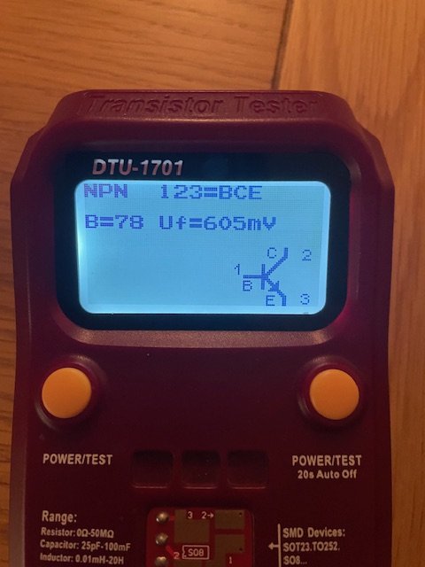

I power up the NAD 3130 with my newly built 100W Dim Bulb Tester Today, the bulb flashed and went out and the green LED on the front was illuminated much to my delight. I then attached my MM to the left speaker output but no voltage, then noticed the speaker switch was off, selected speakers A & B then the bulb slowly got brighter and I saw the magic smoke from around Q411, it appear I have a short again. I removed the MJ2955 & 2N3055 to see if I had damaged them but both appeared to test fine on my parts tester (photos below) got them off Ebay could I have fake power transistors?

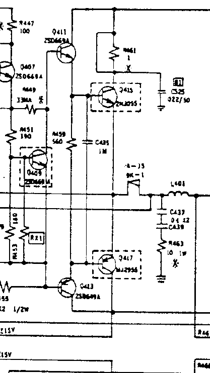

I also noticed that Q421 1000uf 6.3v was bubbling from the top vent, could this be over voltage, however, I don't see any voltages on the service manual schematic? I will test Q411 and surrounding parts tomorrow, could the speaker switch be faulty or can you suggest what I need to check next?

The outputs should be OK as the bulb will have saved them. If you bought them from an authorised supplier they will be to spec and genuine, if bought off eBay then they could be anything.

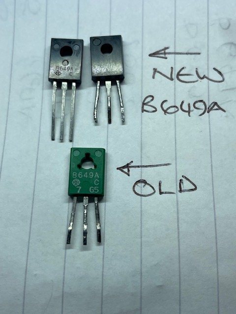

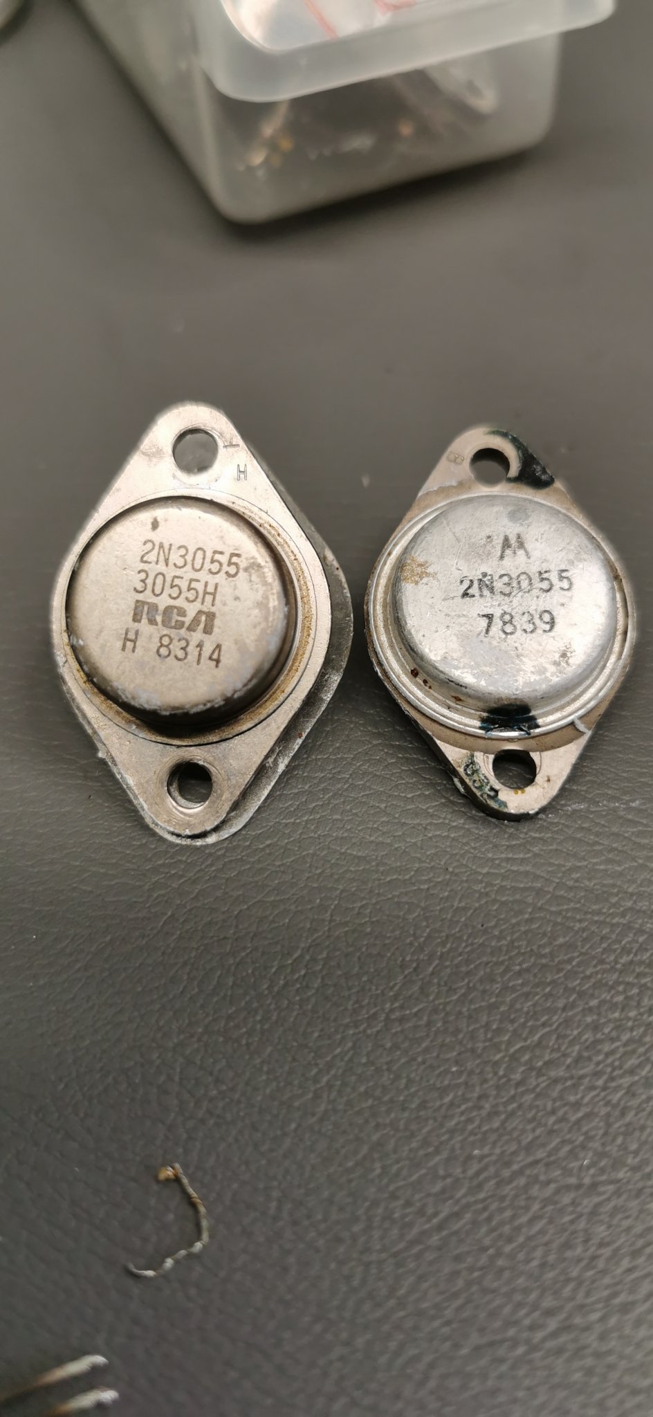

I found what smoked on the dead side, it was the B649a I also replaced Caps C428,C427, C426 and C425 all reading low with a high ESR. I still had the MJ2955 & 2N3055 removed (Looks Like I fitted fakes) and the newly fitted dead B649a, I'm now suspicious of the new replacement B649a and D669a (Ebay) Photo's below?
When testing yesterday the good side stoped working and had a very loud buzzing, I decided to remove the new replacements B649a and D669a (Ebay) from the working side and refitted the BD140 & BD139. I found that after removing the dead B649a and replacing the Caps above the unit power on the DBT with one quick flash and I had sound on all inputs and no short when I selected Speakers A, B or A+B.

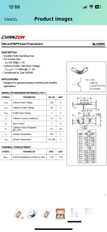

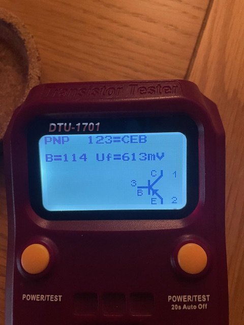

I'm now thinking I could remove the working MJ2955 & 2N3055 and fit them to the dead side to see if I have Fakes or not? Is there a way I can test any of the the Transistor I have purchased from Ebay, obviously my components test only confirms what it is NPN/PNP and basic stats?
I have looked for genuine MJ2955 and 2N3055 online at RS, CPC, Farnell etc it looks like the Mj2955 is difficult to obtain, Some require a minimum purchase of 10 that's £30 + ! Does anyone have any for sale or can recommend a cost effective supplier?
The new B649a has no metal back I noticed when removing it, but the D669a has. Please have a look at the photo's below and give me you option if you think I have fakes or not??

The old 2SB's and 2SD's went out of production decades ago as far as I remember. I would lay odds on the eBay ones being fake, they certainly look highly suspect.
I think I would consider fitting more modern generic replacements all round tbh.

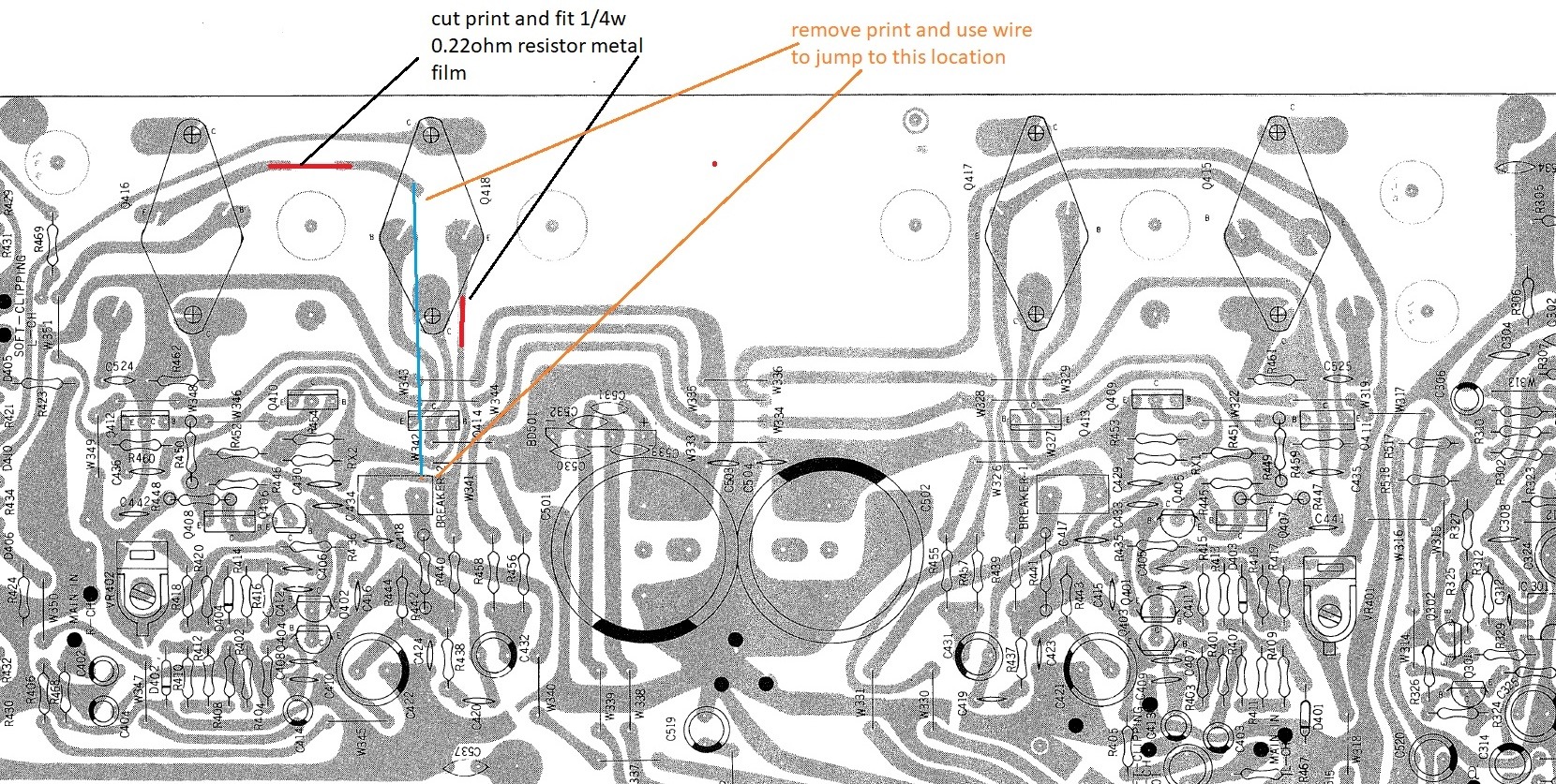

My circuit shows it doesn't have any emitter resistors and therein lies the problem for bias stability, it will be very prone to thermal runaway.
Thanks 🙂 you could be right... and I don't know for sure but any amp like this with no emitter resistors could (I think) be asking for trouble with regard to thermal stability. I would definitely include them for reliability.
you can normaly tell if they have the hometaxials, the RCA ones generaly are.If they have the older motorola ones fitted then they wont be
And i would suggest you do what @Mooly suggests and fit the emmiter resitors if they are RCA ones(they will have an 'H' on them)
the 669A and 649A are readily available, i get mine from cricklwood electronics, never had an issue
