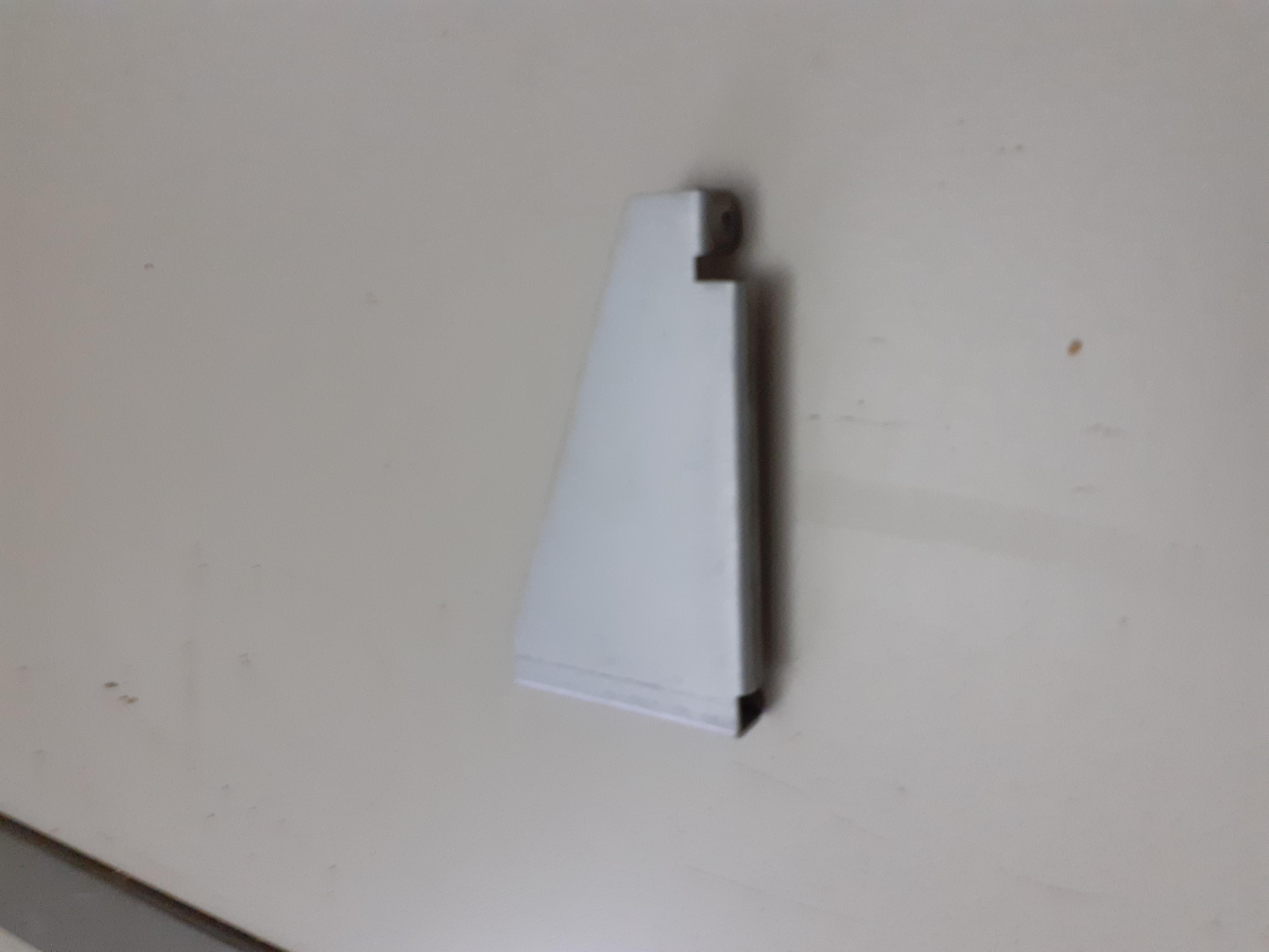

Hello,
does anyone have spare Nad 306 chassis parts or would be willing to take measurments of the Triangle which is screwed to the rear panel and supports the two input boards so I can replicate it? I sold my 306 and the part was missing when I bought it from from ebay myself. The customer insists that he wants to have it as he is afraight the whole amp might explode without it...even though he uses only the poweramp, so the board secured by said piece of metal wont be used anyway. Sooo I'd be very happy if someone could help me out and disessamble it from the chassis and draw around the edges and holes so I can use the drawing as a stencil to replicate this part.

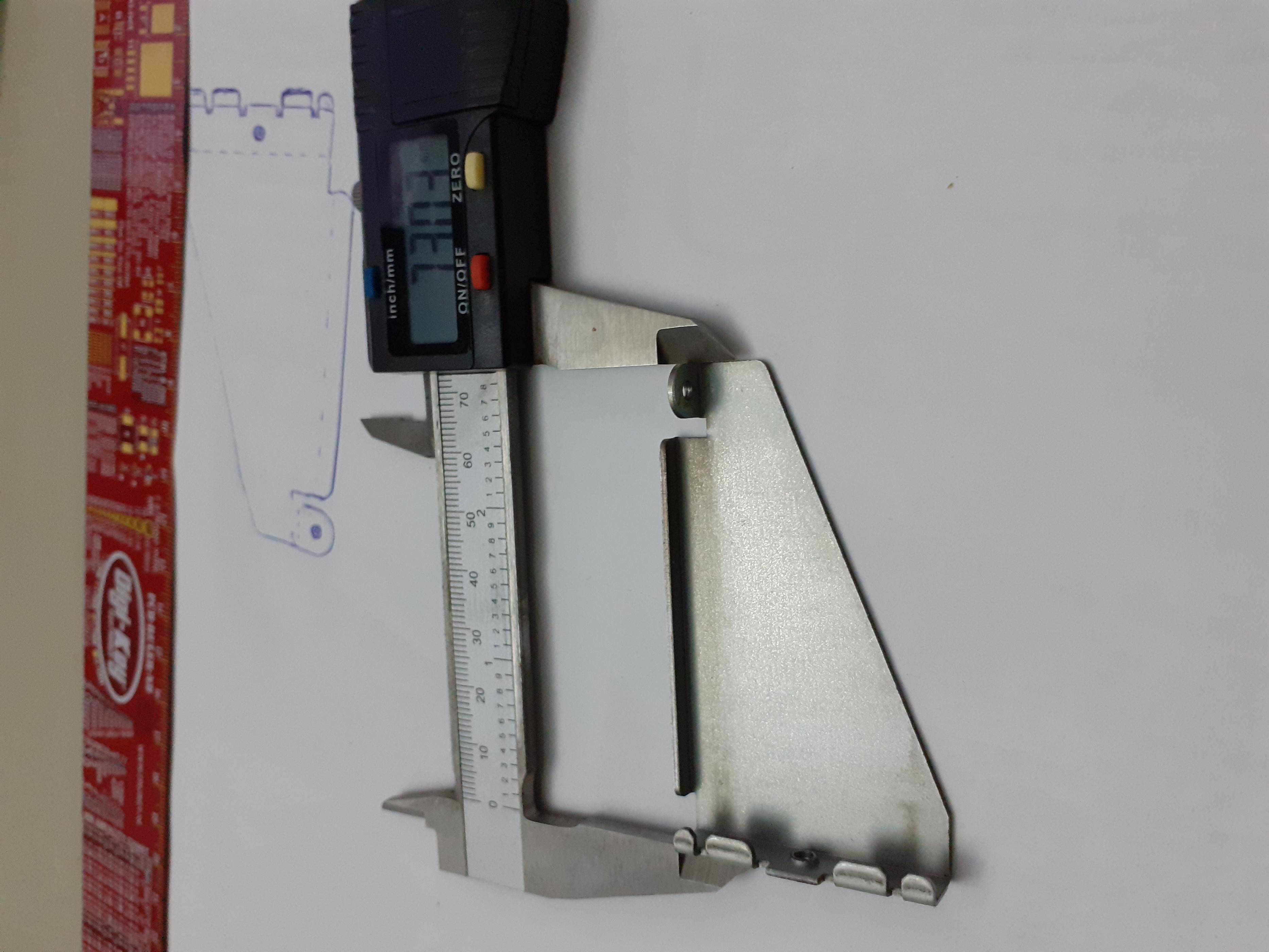

i can measure the little plate if you need

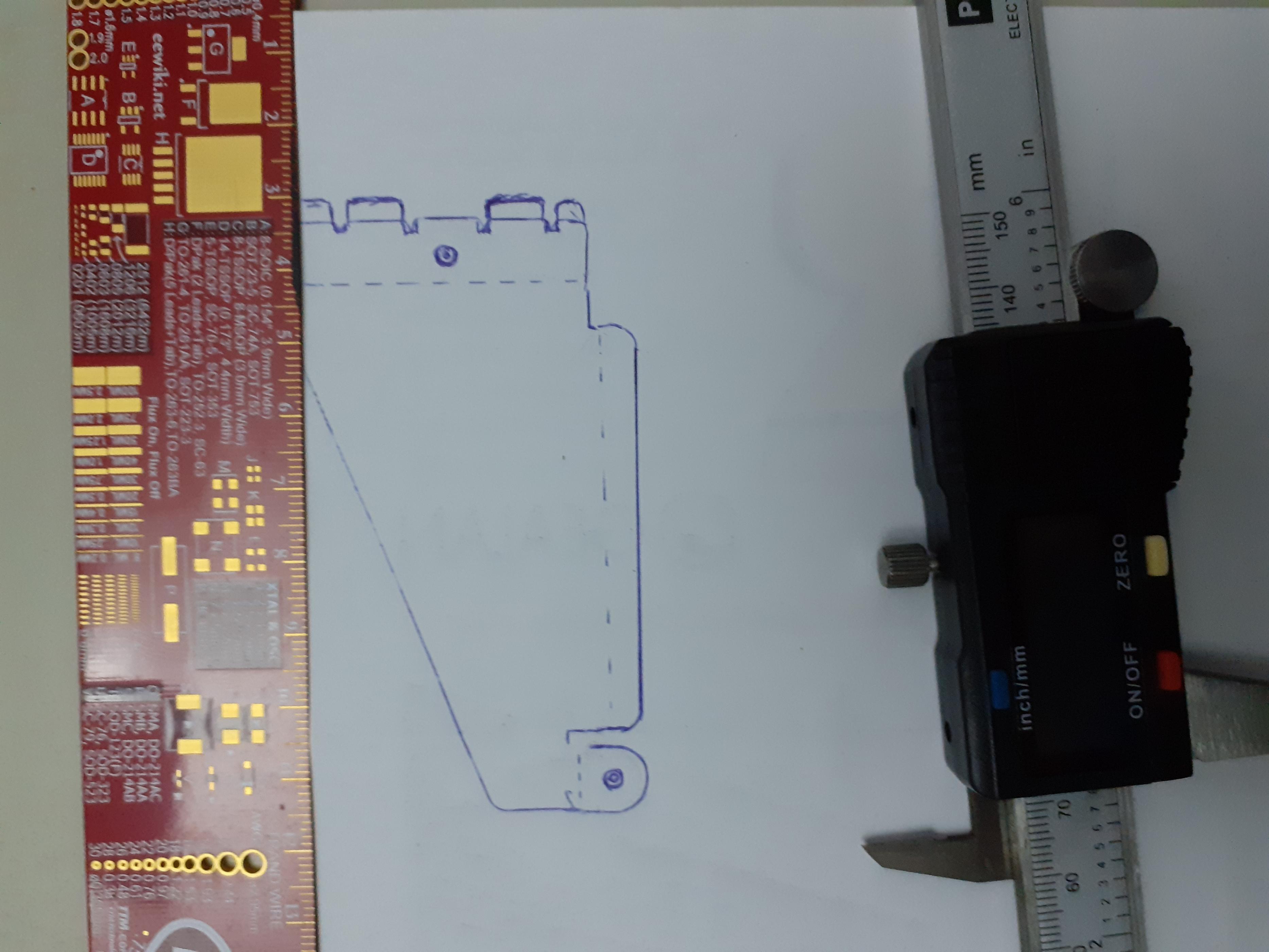

Yesss, thats what I was hoping for 🙂 actually better than measuring would be if you could take a sheet of paper and somehow draw around the edges and holes so that in the end it looks like a stencil or like the cut out piece of metal before its been bent. My plan is to print and cut it out and transfer the outlines on a flat piece of metal so I can then easily cut it out of the metal sheet and then put it in a screw clamp and bend it...Hope you understand what I'm talking about, my english suffers from being german. I didnt figure out how this upload system works here as it asks me for a url instead of a select file window so I cant show you but I hope the explaination of this "brilliant" plan makes sense to you. Of course some edge to edge measures would be great too so I can ajust the size ratio accordingly when printing it. Thank you so much!! Hope it works as I imagined.
You'll need a 85mm*45mm piece of 1mm or when being exact 1.2mm thick blech.
Long side 25mm from right top corner the triangle goes down to 20mm from left bottom corner.Right bottom corner longside cut out little rectangle at 17mm, 6mm shortside. Left bottomcorner becomes a tab for screw, make cut long side 11mm from corner and 8mm from corner, about 11mm deep, tab should be bend from about 11mm end off triangle short side, I will scan "stencil" later and add photo other little side bracket
Looking good, I'm just back from
work, sorry for the late answer. I will have a closer look after a shower 🙂 My dremel and a piece of metal are already waiting for action 🙂 I will show you the result when done. thanks again, I really apreciate that you took the time to do this for me!!!
