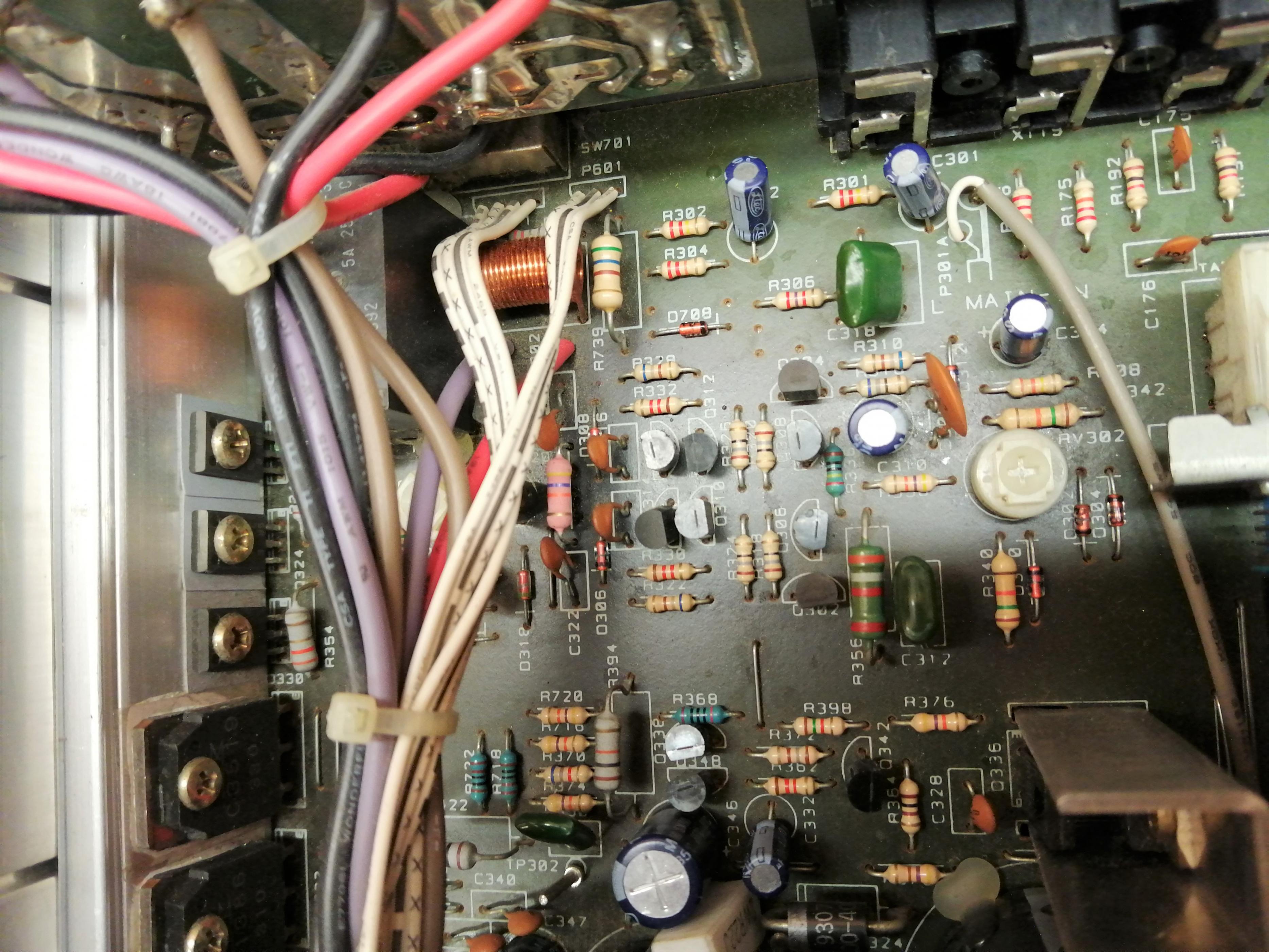

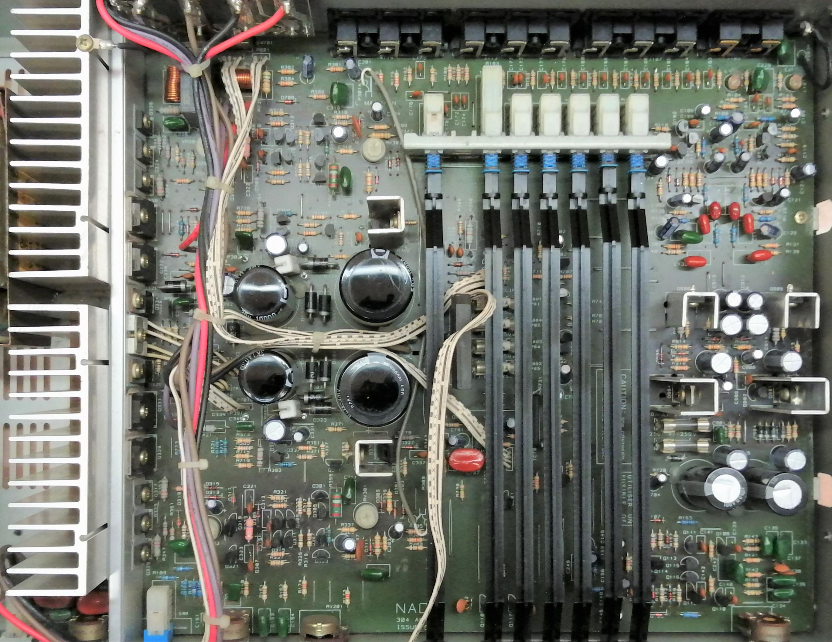

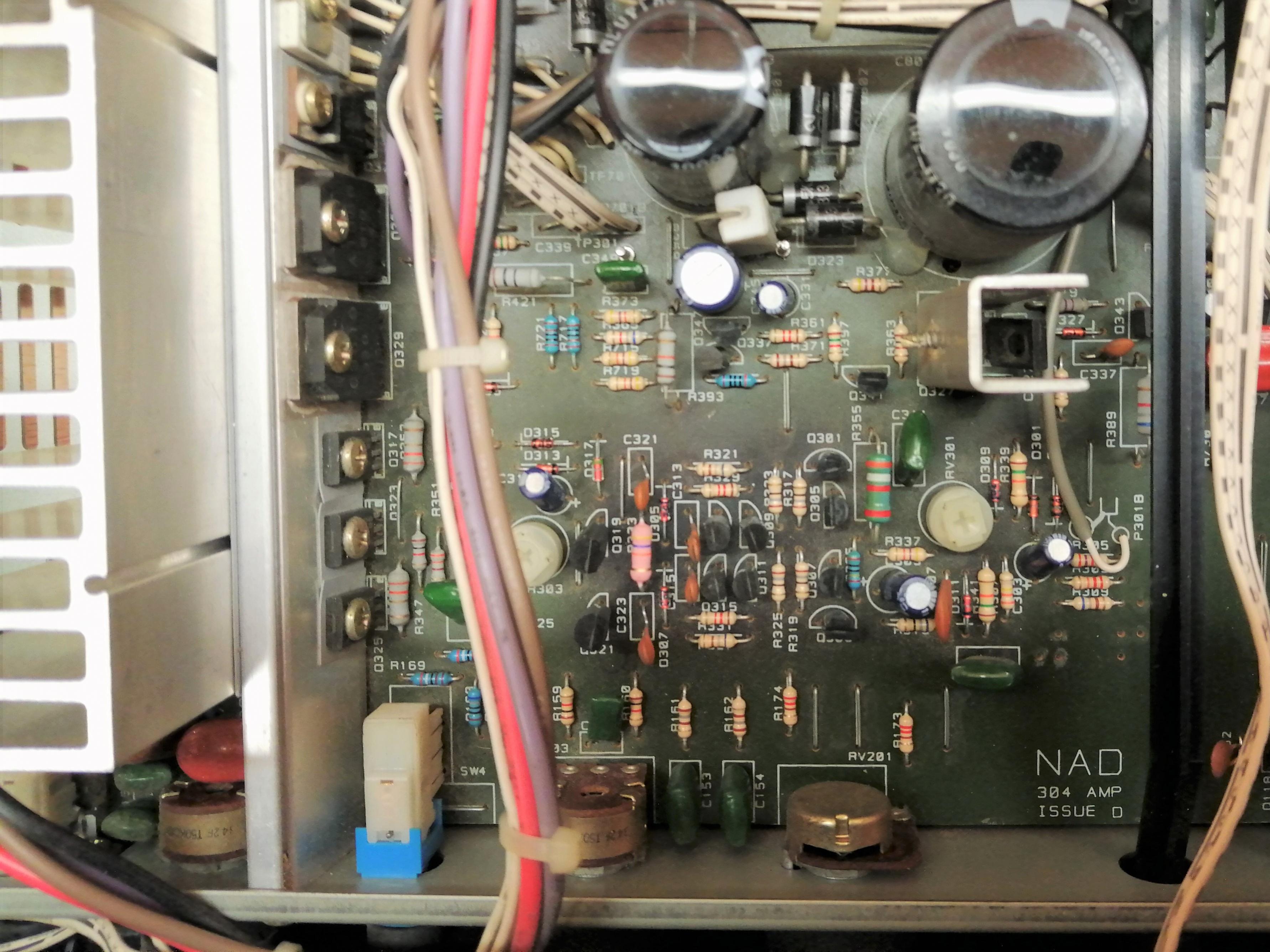

Hello, I m trying to find the r333. i have found the r334 🙂, but i cant find the r333🙁. Please, help me, where is exactly this resistor?

The board is pretty much a mirror image. With the amp front facing towards you (heatsinks to the left) locate the 4 large capacitors. R334 (right power amp circuit) which you found is to the top side of the capacitors so look for R333 (left power amp circuit) on the bottom side. To give you another reference, the resistors are right near the bias pots (R334 is near bias pot VR304 and R333 near VR303).
