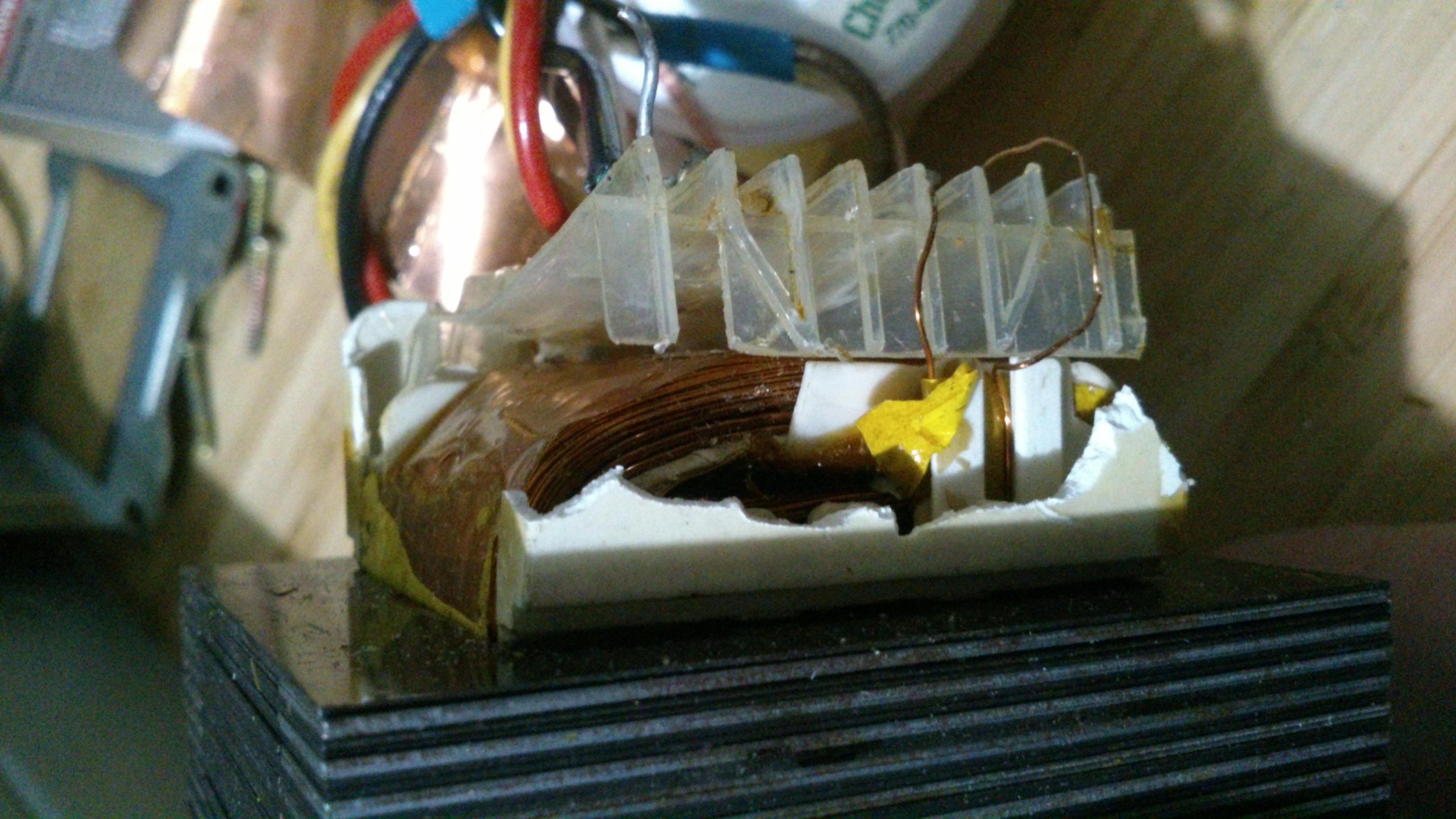

I've got a non functional NAD 304 for free in order to repair it.
The owner said that it suddenly stopped working in the middle of a party.
I thought it'd be a simple fix like a power supply issue/fuse or even some kind of overload protection kicking in because of a short but it turns out I might have an open primary on the power transformer.
I desoldered the secondary of the transformer going to the board and tried to power it up with no luck.
I even tried to power it up (with a lamp in series) directly from the primary (bypassing the switch) but again no signs of life.
I get absolutely no ohm reading (OL) between the red (hot) and neutral (black) of the primary.
The transformer has other windings for 110V operation but I only tried the 220V so far.
I might try the 110V taps too which might be okay but I'm very curious what might be the issue here.
I opened up the transformer (broke the external shield plate and removed the insulating tape) and nothing seems or smells like it's burned up.The enamel wire seems okay so I suspected a thermal fuse might have opened.
Thing is there is no thermal fuse there (not within reach anyways) so it's kind of strange that the transformer primary "opened" with no signs of overheating etc..
Does anyone know if that's really the case with these amps?

Schematic indicates the transformer has a thermal fuse internally. If the black wire has no continuity to any other wire the fuse is open.
I thought the thermal fuse indicated was only for the 110V transformer type..🙄
Makes sense to have a thermal fuse..
I'll check if the black wire has continuity with any other wire and report back.
The black wire does not have continuity with any other wire indeed.
Black is the only wire that looks like it's not connected directly to the magnet wire and I've tried to pull it out to see to what it's connected too(hoping to be a fuse) but unfortunately I broke it🙁
The other end is deep inside the transformer so I guess I'm screwed.
Whoever made that transformer didn't really want anyone to fix it if it fails I guess..
I've seen transformers with their fuse easily accessible (just under the insulation tape), this one probably had the fuse to protect only the user and not the transformer itself.

Check if you have continuity from,
- WHITE(pin 15?) to BROWN(13)
- WHITE to YELLOW(12)
- WHITE to RED(11)
The WHITE and BLACK wires are at the same potential, connected by
the fuse. You could bypass the fuse by moving the return power cord
wire (Neutral) from Pin 15(BLACK) to Pin 14(WHITE). From a safety
point of view this is not on however in theory(?) it should work.

I bypassed the black wire and the amp now works!🙂

Remove your bypass modification, return the wiring to original, and connect a 1 Amp slow blow fuse from white to black wires. This assumes a 230VAC mains. The back panel of the amplifier lists power as 230VA so the first fuse to try is 1 Amp. If that opens due to start-up surge or other peak power demand, try 1.5 Amp or 2 Amps. If powering from 120VAC, double the fuse rating.
I've now put a slow 1A fuse there..
I'm going to leave it playing for a while and play with the volume; hopefully it won't blow the fuse and will continue to work well in the future!
