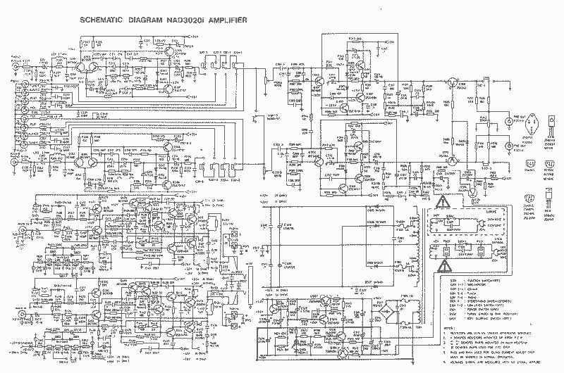

I think it is wise to download the schematic and compare the measured voltages of the bad channel with the good channel. Maybe it's even wiser that a more experienced person helps you repairing this amp.

jean-paul said:I found a schematic of this NAD here:
Good advice on making sure it is the amp 1st.
Both the sites mentioned have schemas from the original 3020 (and there are at least 2 differenet versions of that). I have the 3020i Map 710 kB. A teaser is attached.

Thanks Jean-Paul, Hamish, Planet10 and Halojoy. I've checked speakers and connectors by swaping left and right channel of cd and then the speakers - and the problem is still in the same channel.
I have suspected electrolytics an transistors. I've read on some article that it's often to hear such disturbances when there is a damage in caps.
Using the scheme I will check voltages, and maybe at once exchange electrolitics . I've already found e-supply with original motorala bipolars, and good caps are available too.

Hallo mad_z,
i had the same problem with this amp.
Anybody tried to fix the problem in the finalstage
without success.
The real fault was a dirty switch!!!!!!
The output was distored in a way you see when one half of the finalstage is death.
After cleaning everything was ok.
