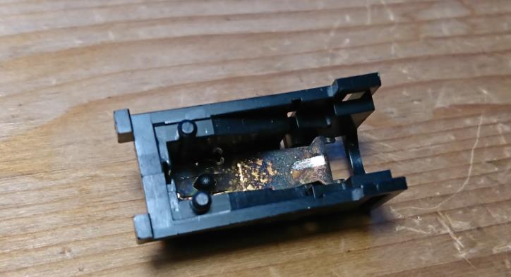

Dear all
The E401 breaker is bad. So I will replace that. Any hints to what to replace it with (not yet strong in the search-for-parts lingo, but have an account at Farnell).
Beyond that:
I will look at the power supply. There is now no light in the green led on the front panel.
Is it more than the two large capacitors?

If the original state of the amp is not primary target then I would place a speaker protection module into the speaker output path - these are cheap on eBay and a relay is better than such a circuit breaker or a fuse (which is used sometimes in older cheaper amplifiers).Any hints to what to replace it with
But it seems that you have added problems during your activities so I would recommend starting from square one:
- check the fuses;
- use DBT (dim bulb tester) to verify that there is no excess current draw;
- check the unregulated and regulated voltages;
- check DC offset at output transistors (i.e. before E401/402).
- adjust bias current. In case of problems find and repair the cause.
- start checking signal volumes from power amplifier - there seem to be many contacts in signal path so starting from preamplifier may complicate your work. Easy way would be to feed 400Hz or 1kHz signal into the input and walk the signal path with DMM in AC mode. A scope would certainly be better - do you have one?
- once bias is set and signal volumes are verified then distortion comes into the picture - lytics and contacts in signal path would be my first suspects.
