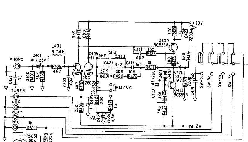

Either way, it sounds like your best option is to identify which of the NAD 3020 service manuals best fits your phono section (most are on the hifiengine site), and work from there. Personally, I'd check the 3020B manual first, and see how it compares (I've never found a service manual specifically for the 3020A).
If the AUX & Tuner inputs are both working perfectly, then the pre-amp section, including volume, tone, and balance controls must be working properly - that only leaves the phono section, and the input selection switches, everything else is common to all inputs as far as I recall. The MM/MC switch should have a noticeable effect, what are you using as phono source, and what did it sound like before recapping ?

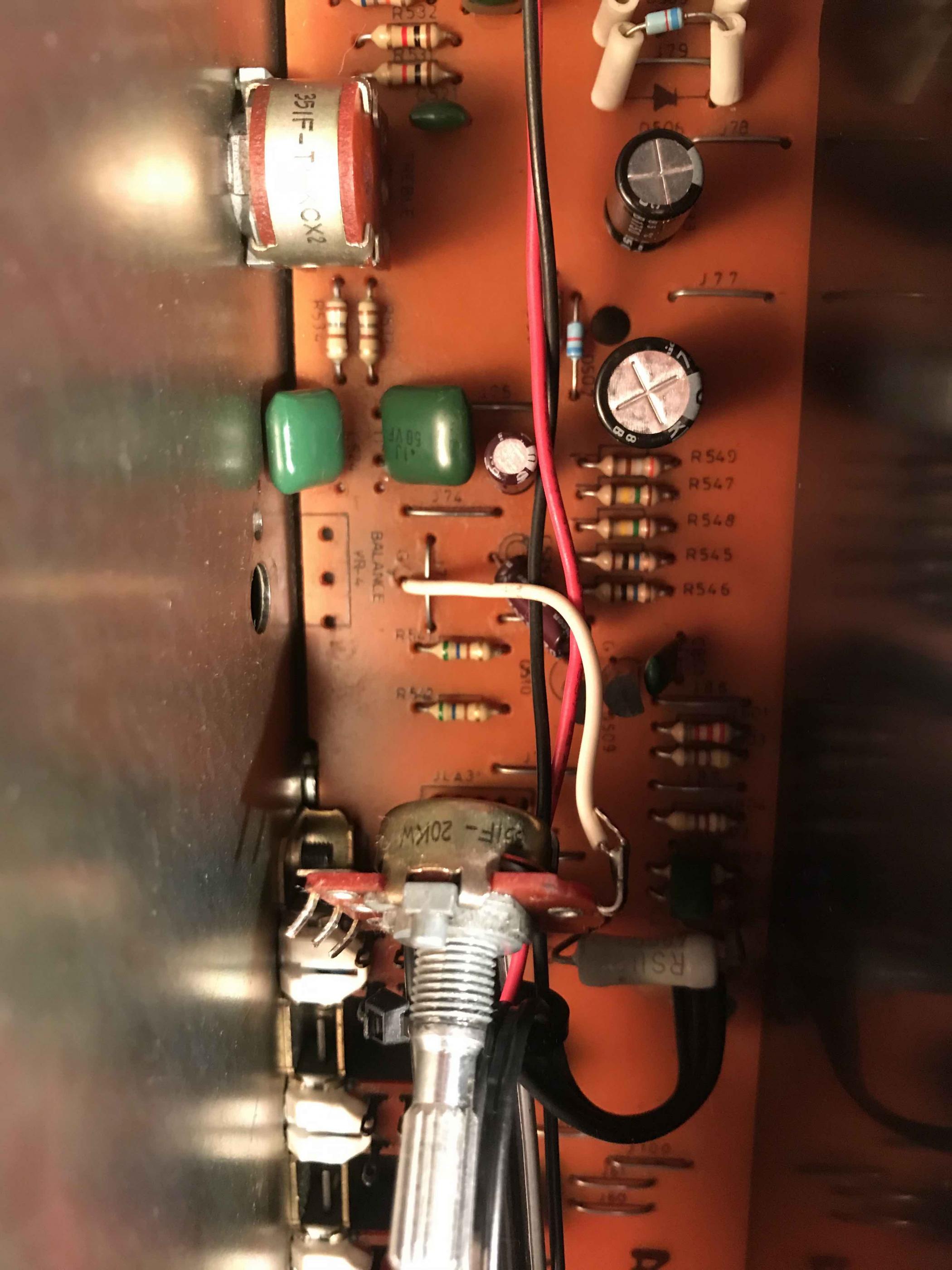

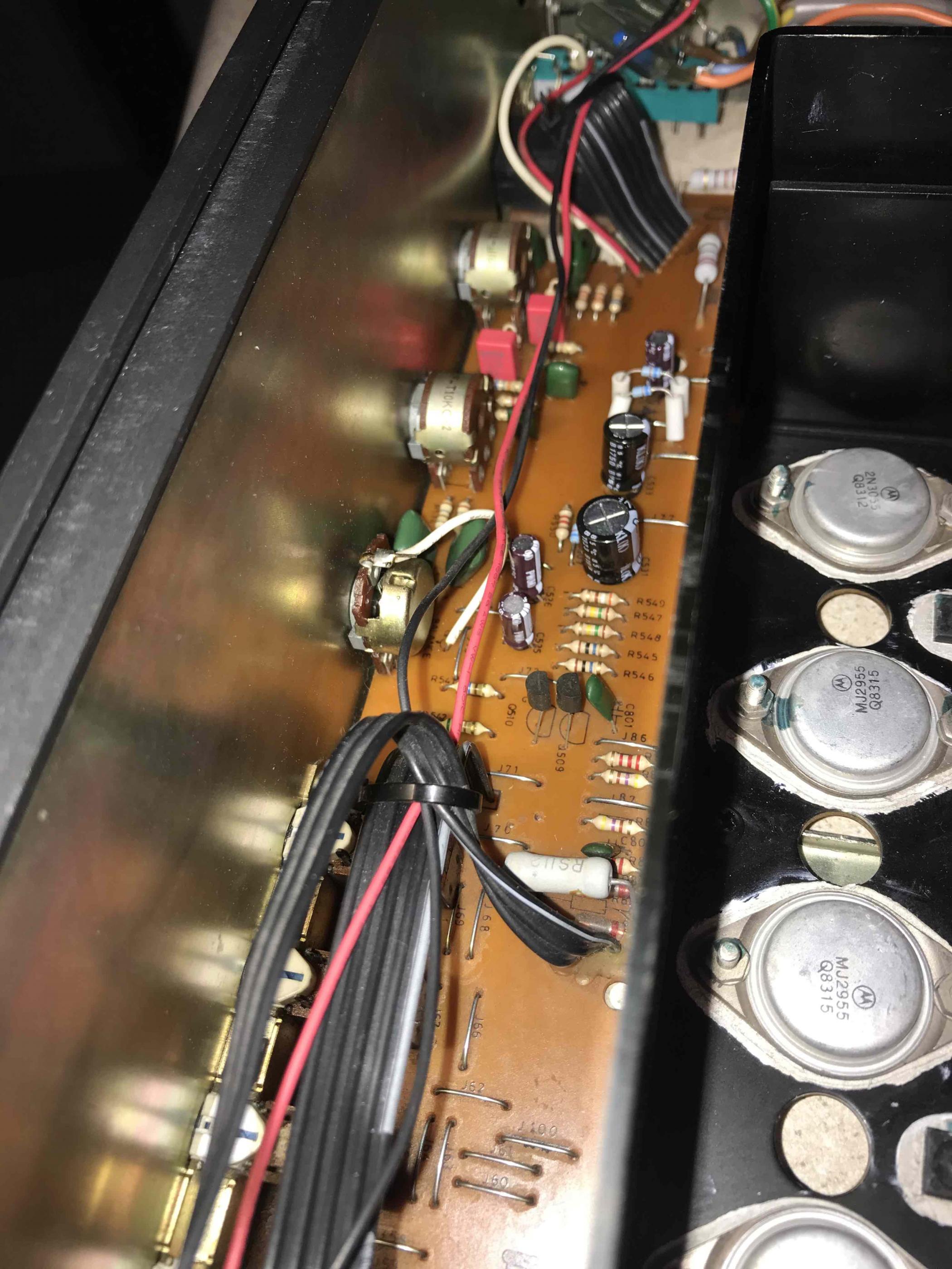

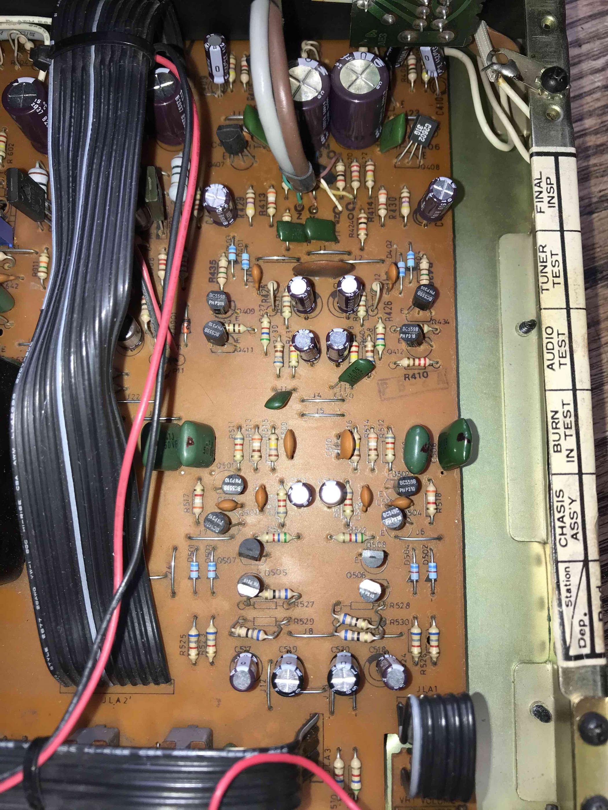

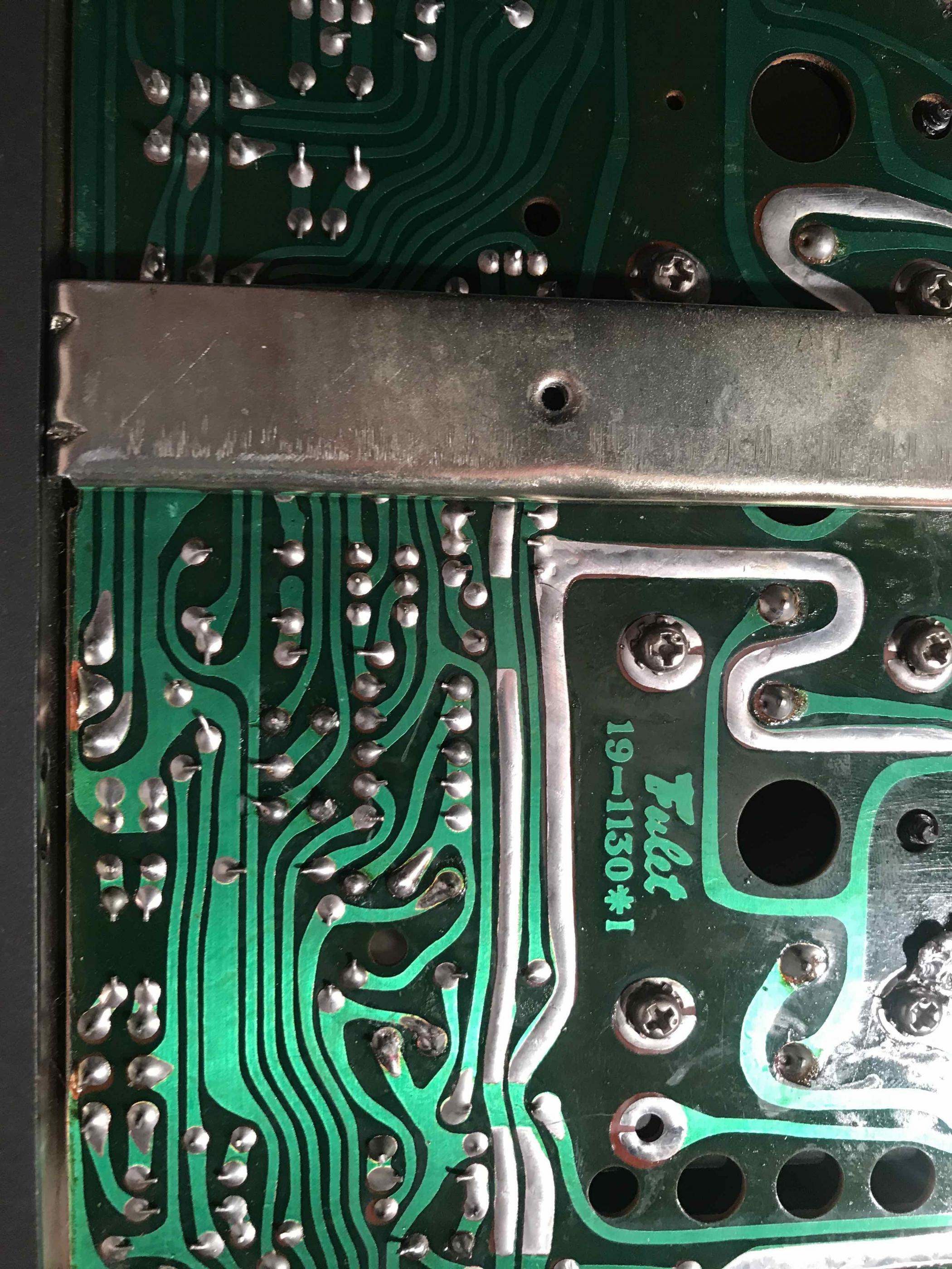

Prior to my restoration the phono section worked ok in the sense that the MM/MC switch operated. The phono section generally sounded fine, ..I'm aware of the potential irony at this point. I'll attach a couple of photos of the preamp section of the board, could anyone highlight or circle the components that comprise the only the 'phono' section path as I'm not very good with schematics yet.
I agree, I've never found a NAD 3020A service manual or schematic either - but, in my case (2 - 3 examples), I found the phono stage to be closest to the NAD 3020B / 3120 phono stage, the original 3020 only had MM input, and no MM/MC switch. You can confirm simply by comparing your components to the schematic - this is the one I think you probably have, although one or two values may still differ (keep the original values in the amp).
There's no single 'path' thru' it as such, you'll need to double check everything you've done in that area. You didn't say what source you're using ?

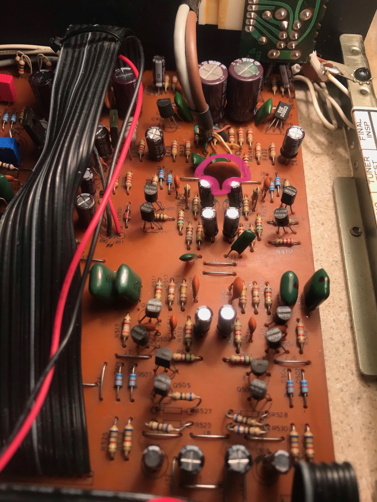

Hi Goldie, apologies for my radio silence and appreciate your guidance on the most appropriate schematic.
So, looking at the attached photo I'm thinking of testing the transistors marked up with pink highlight.
If any test different to their 'twin' in the same location on the opposite channel I'll replace them.
Do you happen to know if there are replacements available for the following?
C2602 31G
BC559B PHP305
BC599B PHP310

If the phono stage worked in both MM and MC modes before your activities and it works now only in one mode (MM probably?) then most probably you have a wire (to or from the switch) broken or desoldered. The switch is just altering the feedback network to change gain (according to Goldie99 schematics).
'madis64' raises a good possibility for the MM/MC switch - the switch wiring is fairly 'delicate' where it joins the main pcb, and is often buried in glue - all of which I would clean off completely. Your cartridge obviously needs the MM position.
I assume at this point that you've already checked that the record deck / cartridge is working OK with another amp.
If both phono channels are affected it makes little sense comparing transistors between the two channels... that technique's more useful comparing a known good channel to a faulty channel.
If any non-phono sources have been connected to the phono inputs since it was working ok, it may well have damaged transistors in there, potentially in both channels. If not, then I'd be more inclined to look at the changes you've already made, especially those that are common to both channels. One that sticks out a little, is what looks like two polystyrene (PS) caps, they must be new, the 3020A had no PS caps. PS caps are easily heat damaged, even just by poor soldering technique. It's a 'shot in the dark', but in those locations (C415 & C416 ?) it would affect the sound if they'd been damaged. I don't quite understand some of the other changes you've made, particularly in light of your own comment "especially as the phono section has a good reputation".
Anyway - if you do end up needing to change any transistors - the 2SC2602 has been obsolete for years, something like KSC1845(FTA) should be fine, but ideally I'd leave them alone if possible: note - Q403 & Q407 are probably 'matched', Q404 & Q408 also. The BC559B's are still available, and don't need to be matched.
